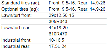

The first thought is that it will mess up and bind your 4wd system - however, since you have done the math and measured the diameter of the front end and found them to be the same - if the bolt pattern works also then it may very well work fine.
Now the question that still comes up - since these tires/rim are on 2 difference machines - will the steering work perfectly as designed? Will the lock to lock hit anything? As you mentioned - the hub offset will come into play.
Do you spend a lot of time in 4wd?
If you have a relationship with your dealer - you may be able to "place" them on and try it - but I am going out on a limb here and say, they want to be paid for first.
Here is your factory choices as you may be aware:
