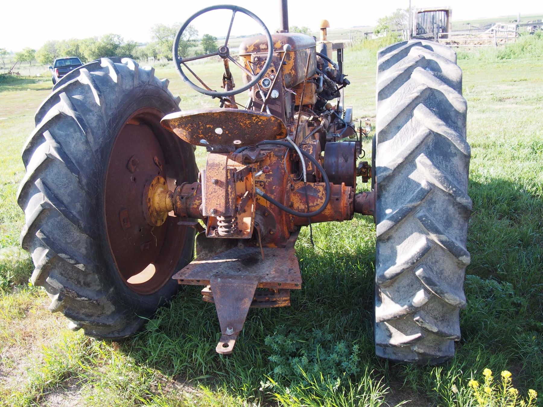

My 1953 Minneapolis Moline ZAU came with a "fancy" suspension seat frame.
It looked like this. Unfortunately, I can no longer find parts diagrams from AGCO. This is the best I can do:
It broke in the early '70's. Now I have this:
But I have the frame. It lacks the central coil spring and shock. It also lacks what I think is a “U”-type shaped bracket to secure the spring/shock assembly together, while providing “posts” that go in the upper support notches.
I’m looking for suggestions on how to size an order the coil spring/shock assembly.
I assume I would get the coil spring, and find a shock to fit, then make them work.
I think I can fabricate a top bracket with tabs.
I just don’t know how to search for the parts I need.
We have bunches of junkyards around, but they’re U-Pull It. I don’t want to pull coil springs from cars just to check dimensions.
Any help is greatly appreciated!

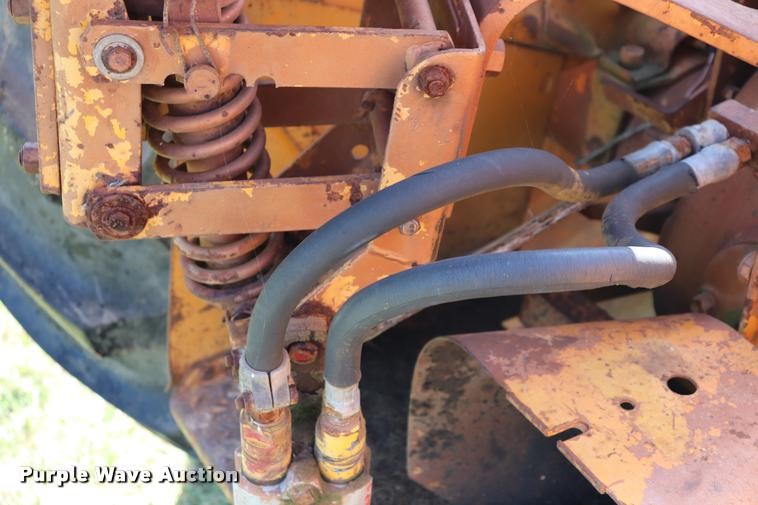

Found a couple pictures.... first is a '52 ZA, next is a U, but identical system used.

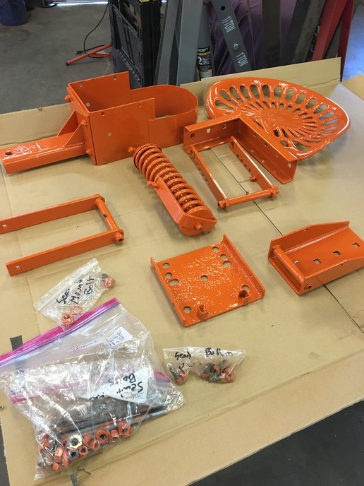

This is an Allis Chalmers WC picture from Yesterday's Tractor...parts are the same as mine, but different dimensions.
Notice the spring/coil assembly. At the top of the photo is a cylindrical rod that fits in the 2 brackets in the lower bracket.... 2 "U" shaped holders.... my lower bracket will take a 5/8"x 4 1/4" rod..
Should I just drill and tap a piece of rod and thread the shock into it, and add a lock nut(s) on the top/shock side? That's my theory so far.
Second, the cups for the spring are flat-topped and appear pretty stout/solid. I haven't seen a source for anything similar....ideas?
That's something I can't fabricate. I won't worry about those until I get a spring to fit them to..
After all that I'll have to figure out the top bracket to hold it all together and lock into the top side links of the Knoedler frame.

Where I think I'll need more advice....
The question I have is, how confident of a fabricator are you? If you got a spring and the cups are you able to weld on the round bar stock to the bottom yourself and can you make that little saddle with the bar stock ears and weld it to the top cup?
If so then finding some rear coil spring retainer cups like this:
https://www.dennis-carpenter.com/tr...GVohLeCWtD-PRVBTCv8GXP1ON9Se8_p8aAmREEALw_wcB
Then taking and bending some 10-7 gauge sheet to the needed length and welding on the bar stock tabs to it on top and welding your length of bar stock on the bottom wouldn't be the hardest thing in the world.
Also if you are competent welding you can probably make your own cups the diameter and height you want by taking some 7 gauge sheet and some schedule 40 black pipe that is the ID you need and welding the 2 together. Then adding the bar at the bottom and the saddle at the top as described earlier and you'll have your spring assembly done.
If you use a metal hole saw (Milwaukee and Dewalt both make one) you'll get a perfect circle. Also doing it this way you can add a little bit of height insurance if you want so the spring doesn't bounce itself out of one of its cups.
It'd probably be a 8-16 beer job to fabricate the cups (including attaching the bar stock and saddle) depending on how quickly you drink beer, how hot it is that day and how cooperative the pieces are.

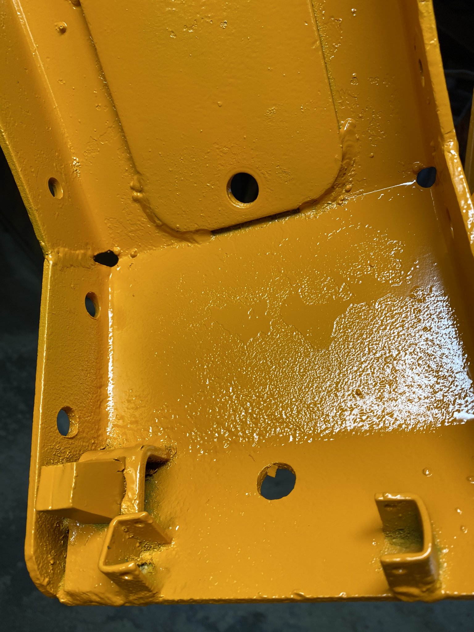

9,802
6,486
Similar to someone else’s AC WC picture I posted, so far so good.

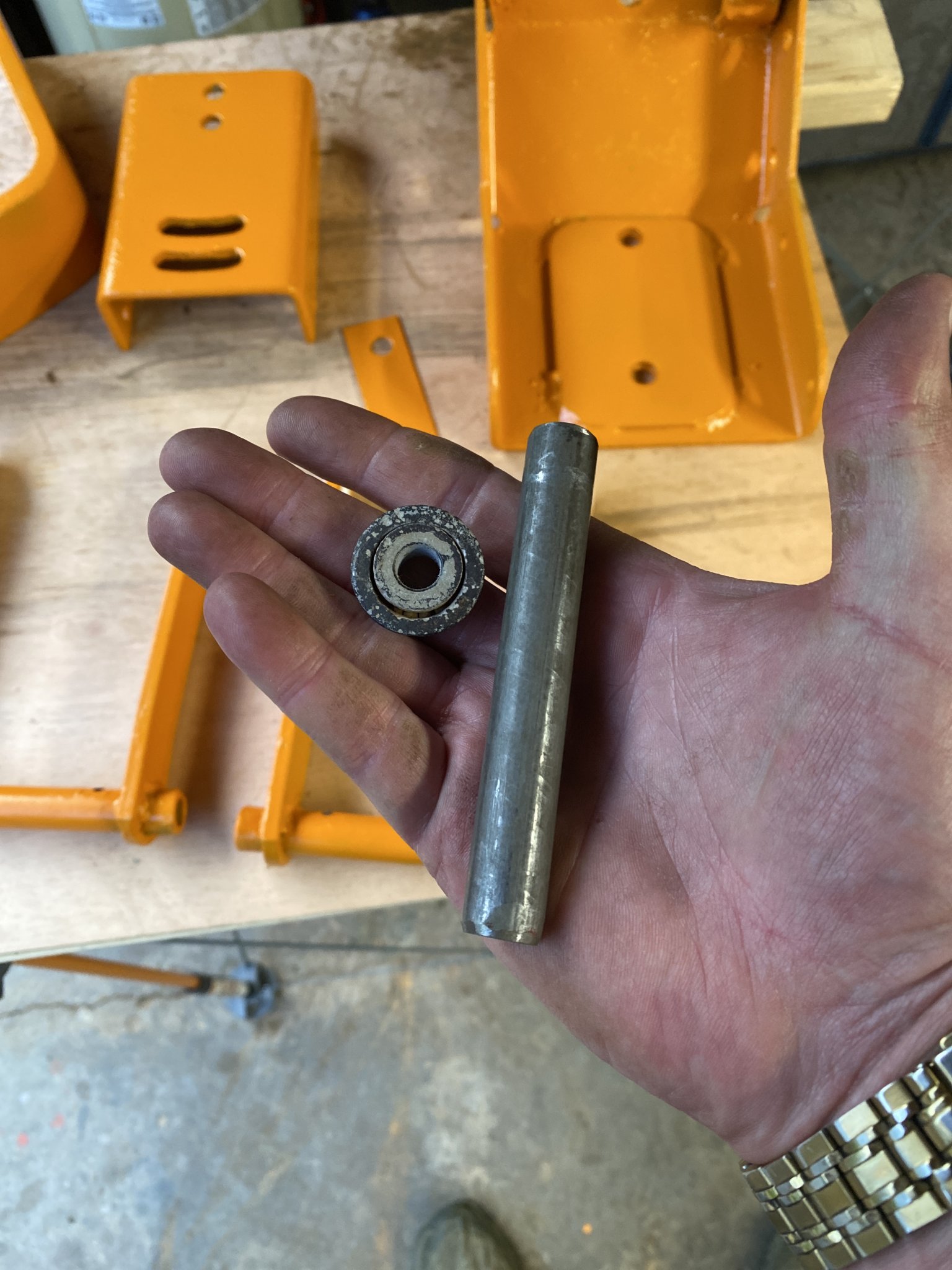

Instead of replacing the bearings on the side links at $10 each, I pressed in $0.65 nylon spacers. Fit perfectly.
If they crap out, I’ll replace with homemade UHMW spacers. Stuff is indestructible. This tractor isn’t used 6 hours a day anymore.... but I’m 100 pounds heavier than my dad ever was....
2 of 4 zerks were broken. Will replace with 4 new ones.
I also cut a piece of 5/8” cold rolled steel for the bottom hold point of the shock/spring assembly. Thinking that will be drilled and tapped to mate with the bottom stud of the shock, outside of the cup/retainer to hold the bottom together.
These are the stock bearing and rod I cut.
