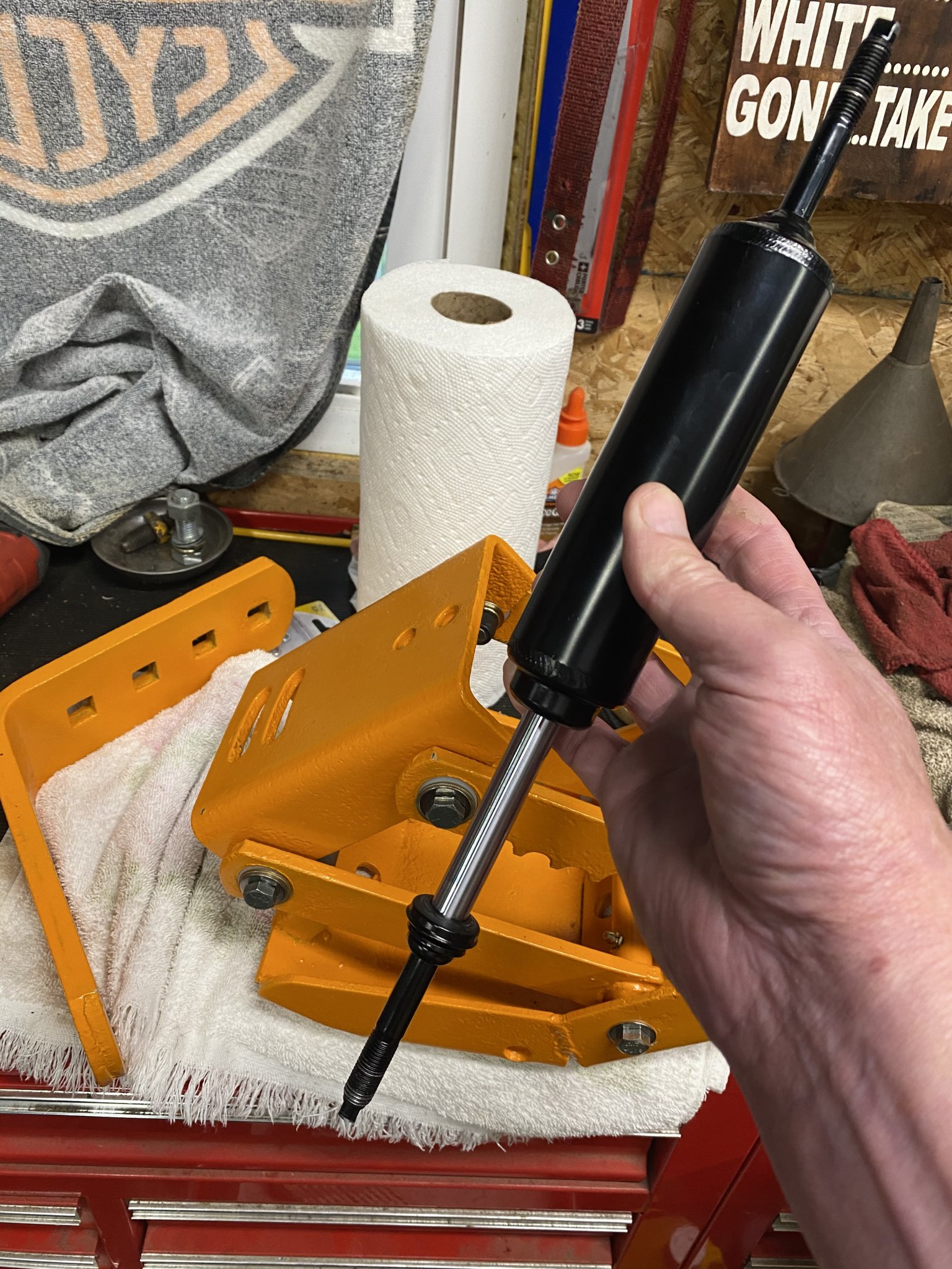

Holy smokes....supply chain....
Shock from Club Car Part # was back-ordered. I did get delivered bushings for a shock I don't have....
Ordered and took delivery on an Amazon knock-off shock to get me going....M10-1.25 vs 3/8-24...GRR...
Just wanted to get the spring sized and ordered....guess what...Back Ordered.
At this rate, I may be trying to get a Seat Pan by October....
I will need to thread the rest of both studs, and then shorten them. I’m not a fan of the Amazon replacement, and prefer to do this once.
Geez.....

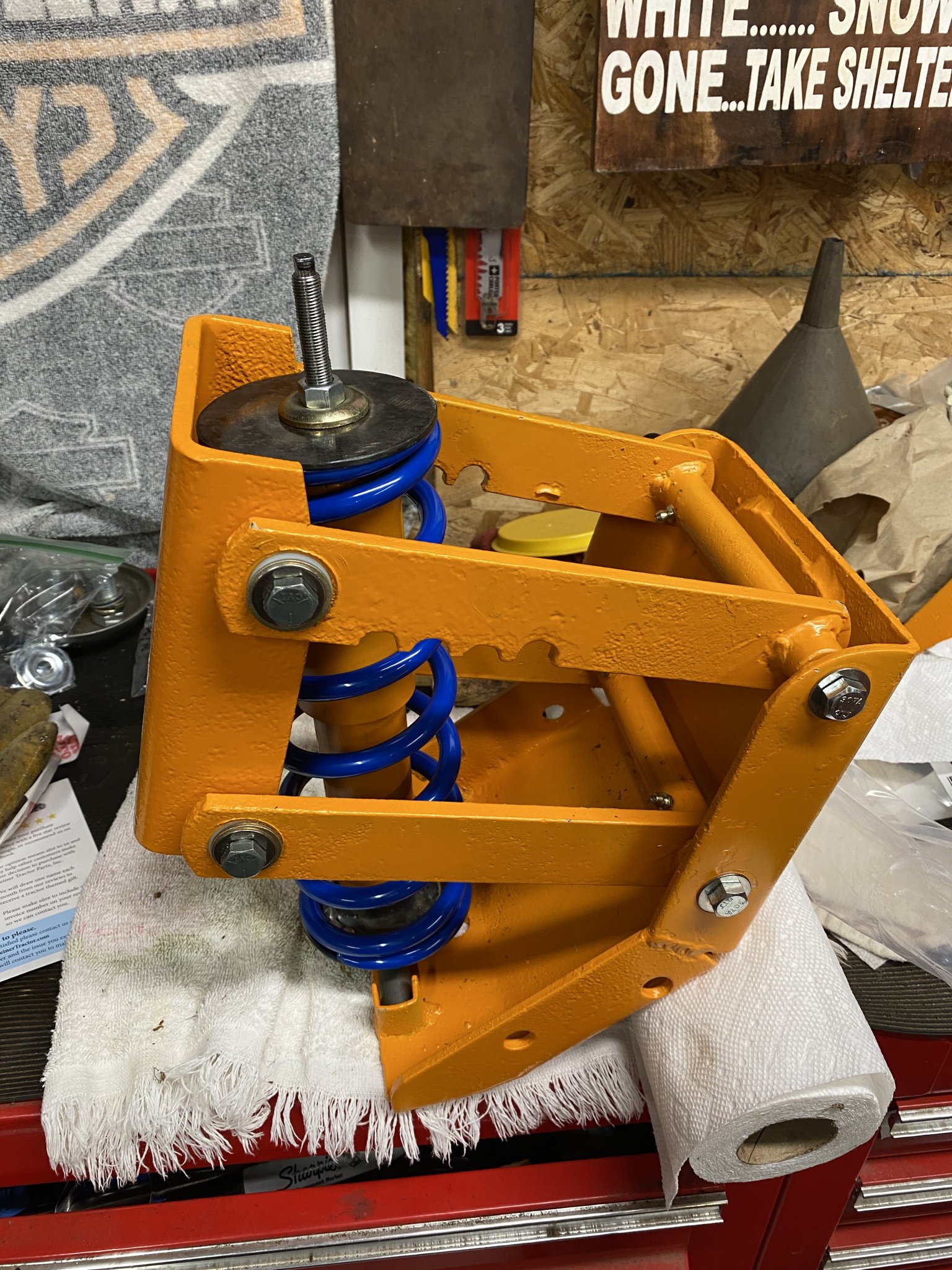

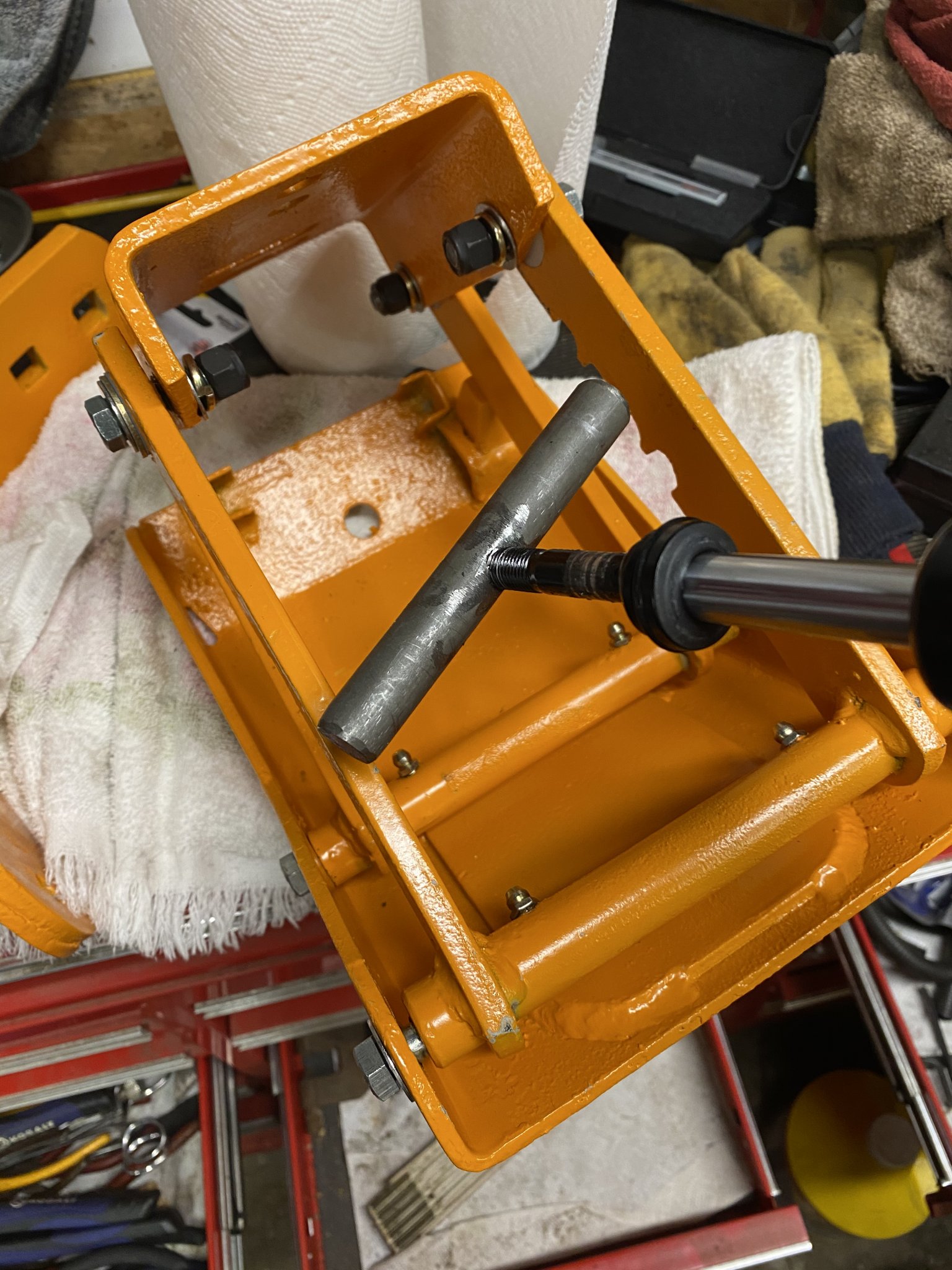

Guessing dimensions, started building the top strap with pins to lock into top frame rail. Making everything long for now.
Welds have been under a grinder, but actually pretty happy with them so far.

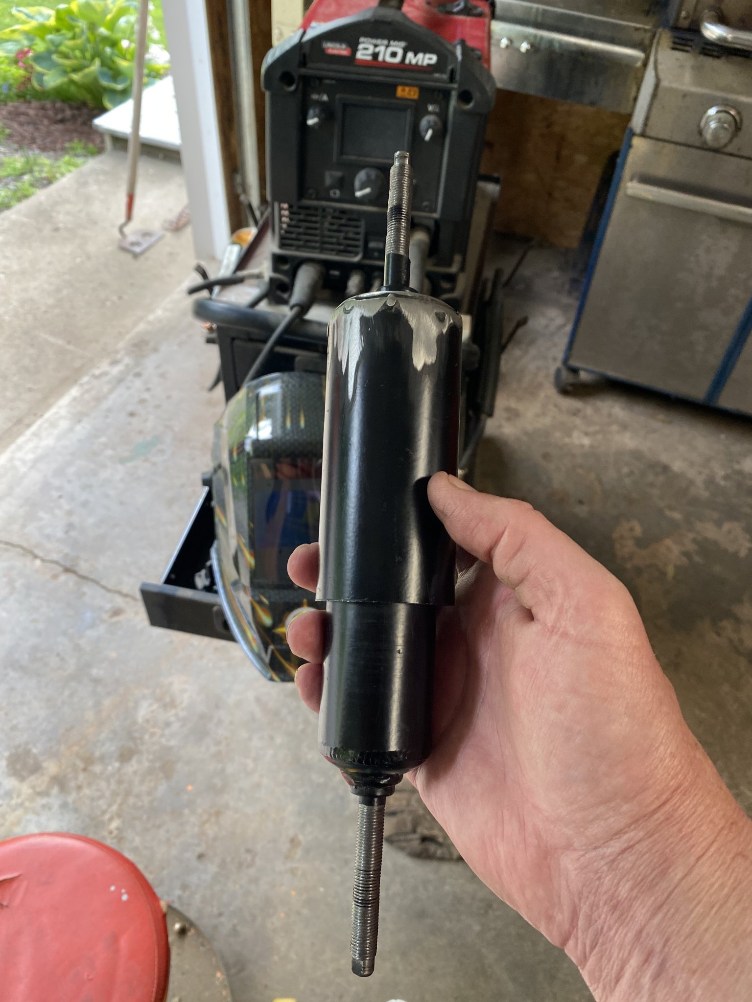

Ordered another shock from a different supplier....showed up Sunday afternoon 4 days later. No idea it was even shipped.
My hat's off to Cartszone.com for speedy delivery.
Will probably cancel other shock order. Haven't heard from them in 3-4 weeks.

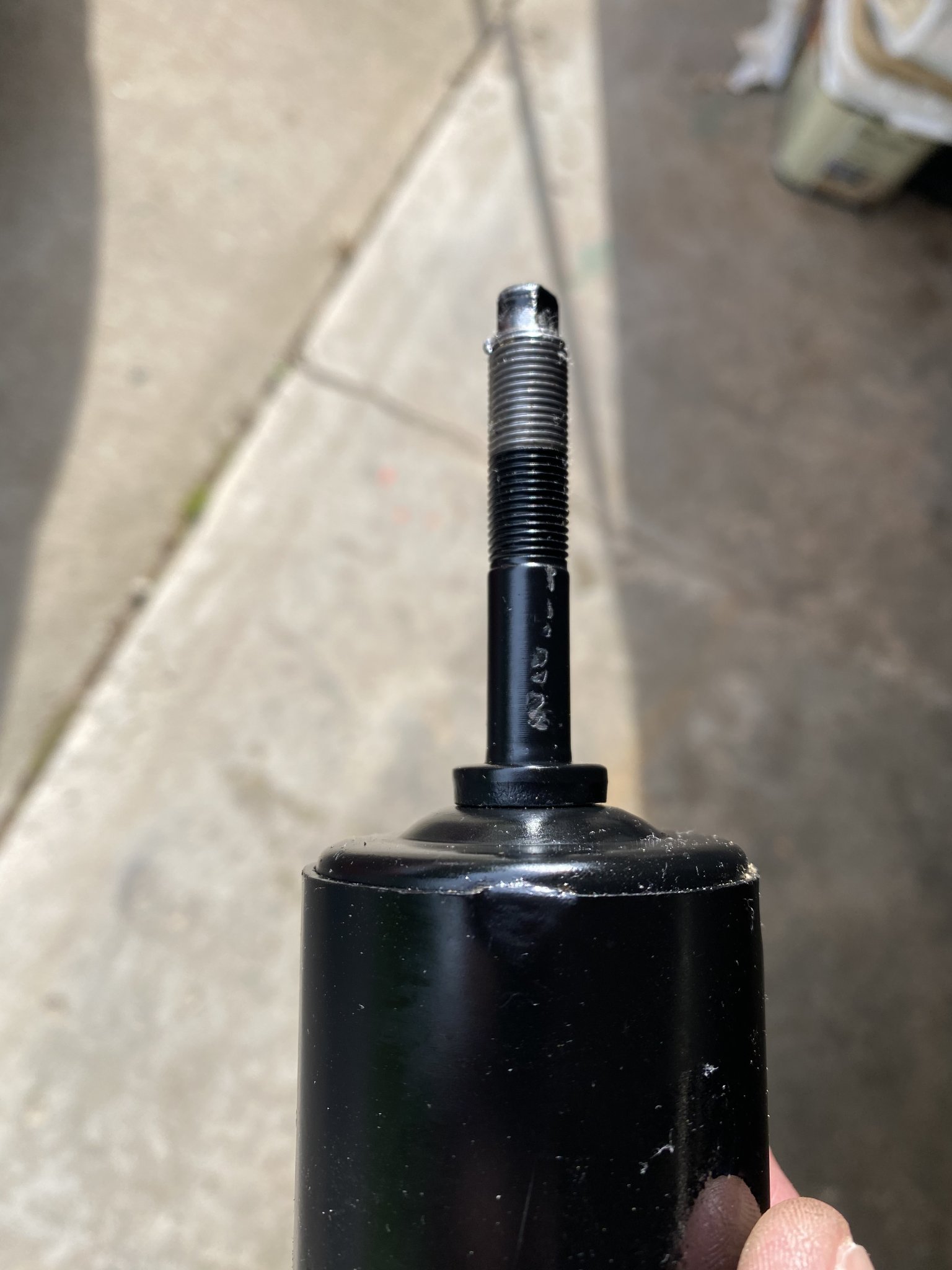

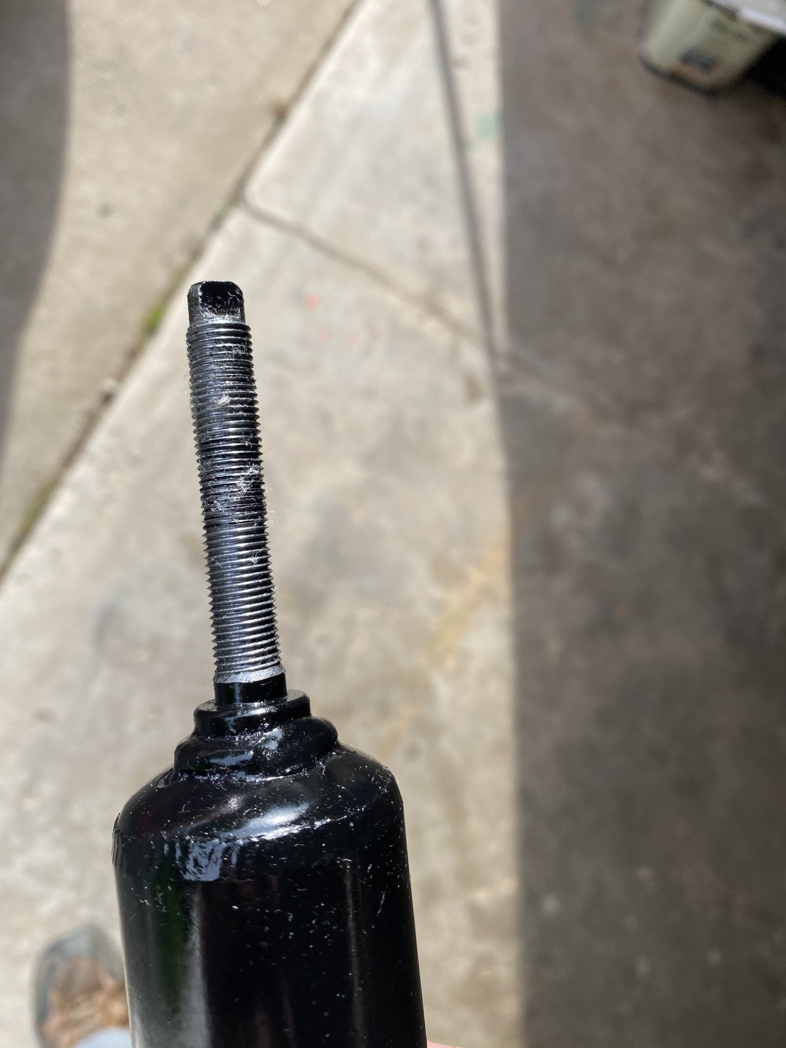

Again, this isn't a tractor part, but a golf cart part that can be made to fit.

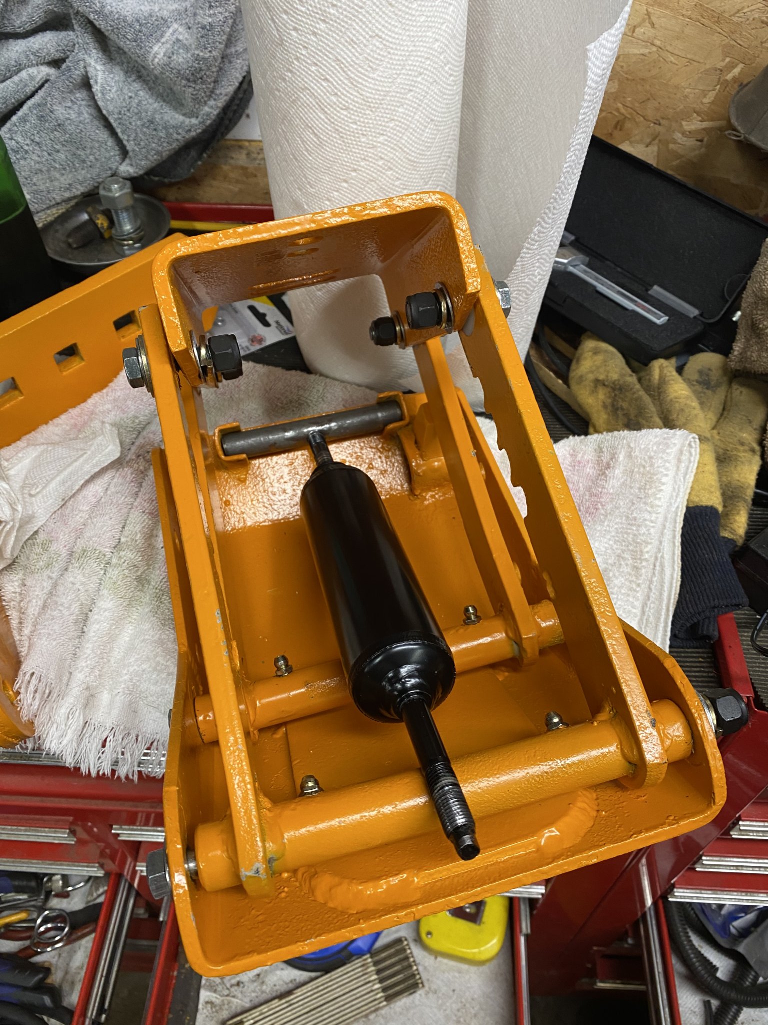

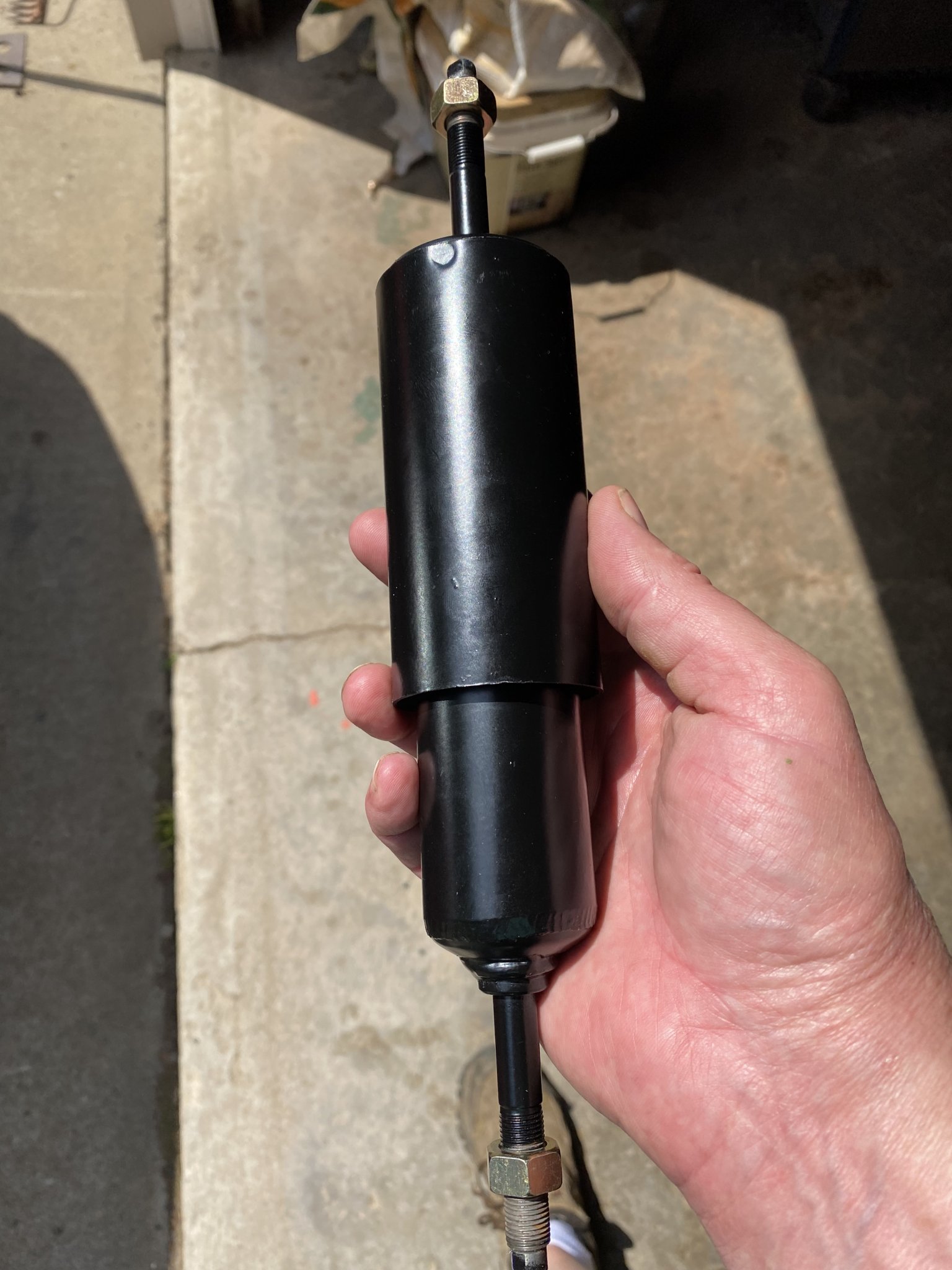

At first I thought the Made in China part was 3/8-24 thread. Learned 3/8-24 is very close to M10x1.0...part is M10x1.0, of course.
I can't have M10x1.0 on a 1953 American Tractor.
I re-threaded the M10 to 3/8-24, and chased the threads through most of the studs' length. They'll need to be cut off to shorten the whole assembly.

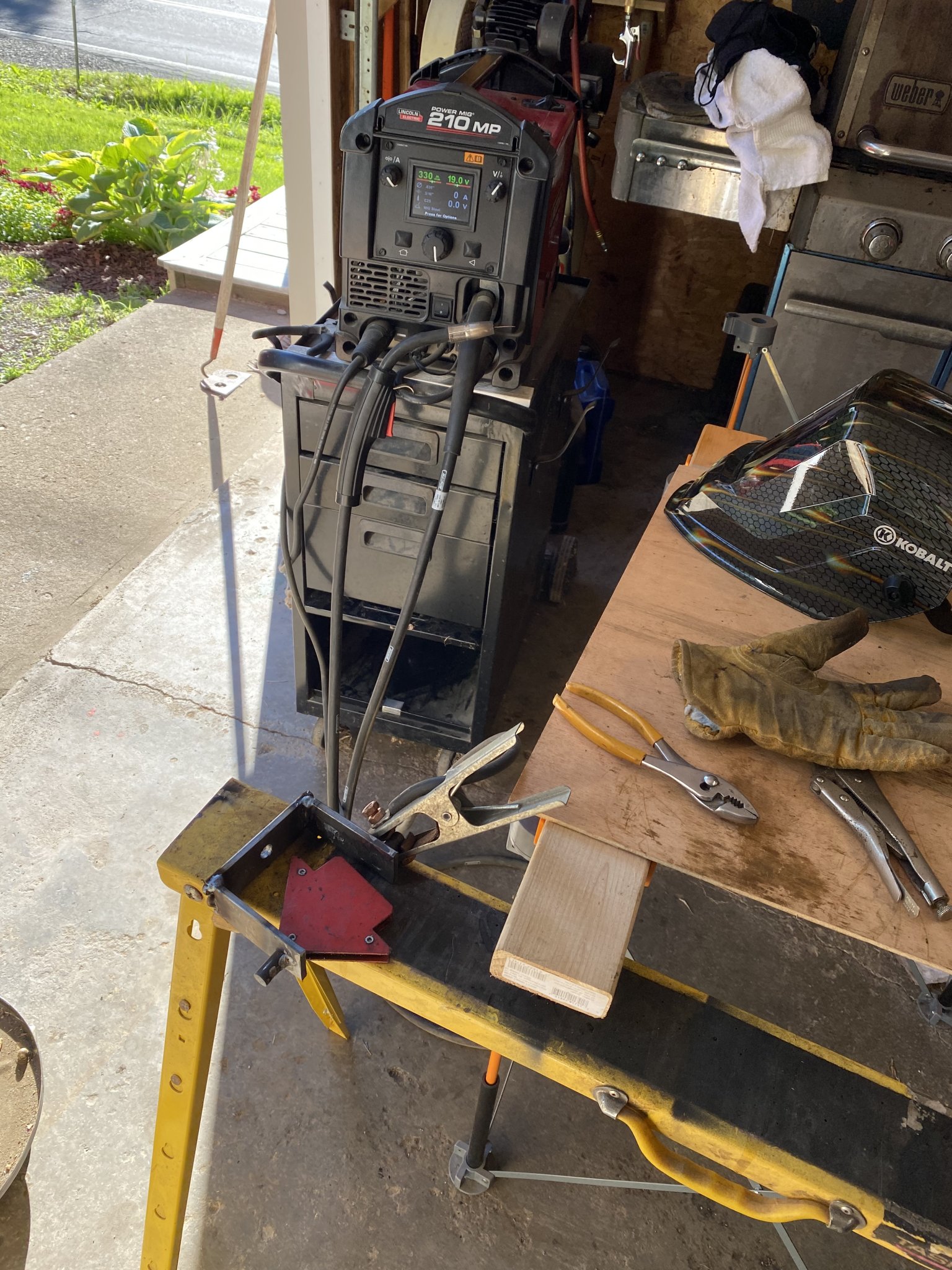

While threading, the 4 poor spot welds on the cover broke off when in my bench vise.
I spot welded the cover back on, and think it's fastened better than it was before.

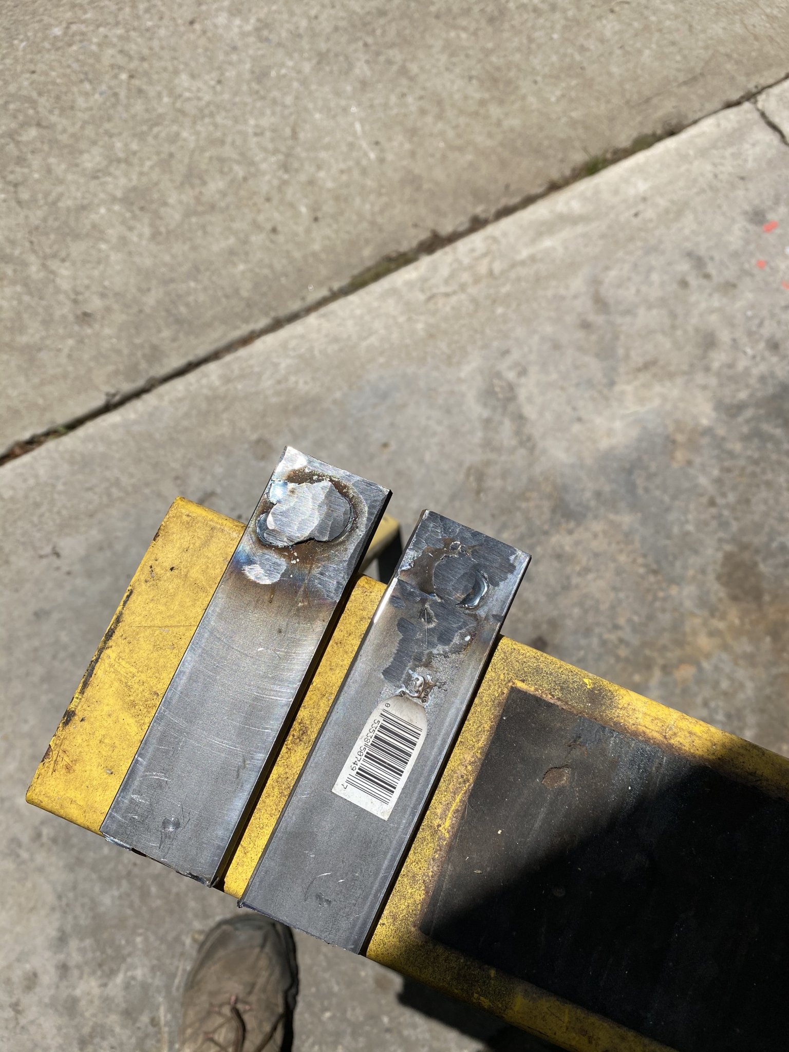

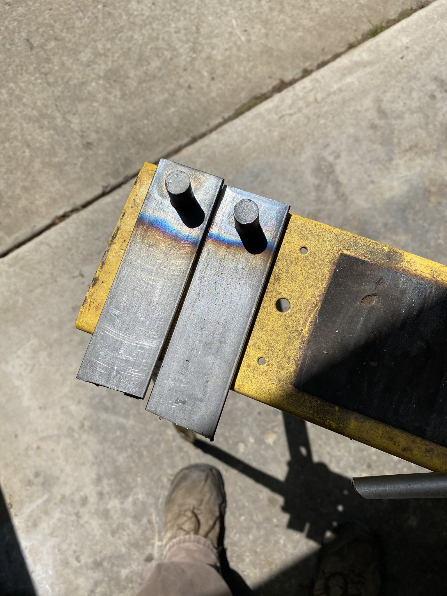

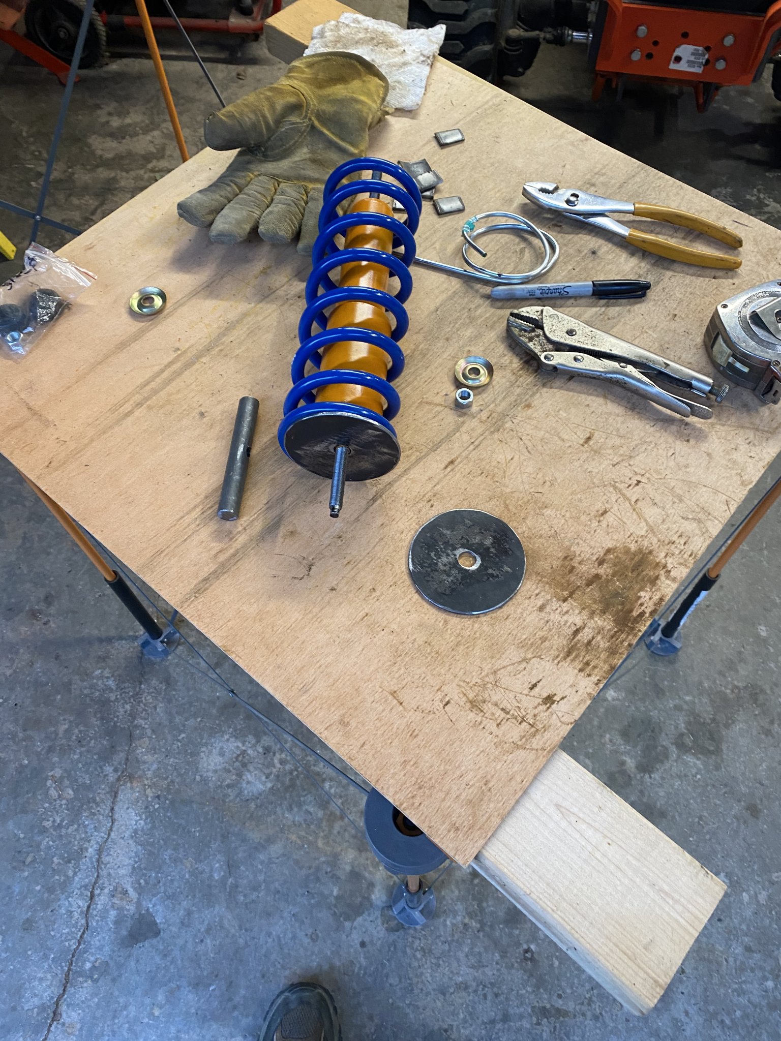

Coil spring came today.
Starting to look like a Knoedler frame.

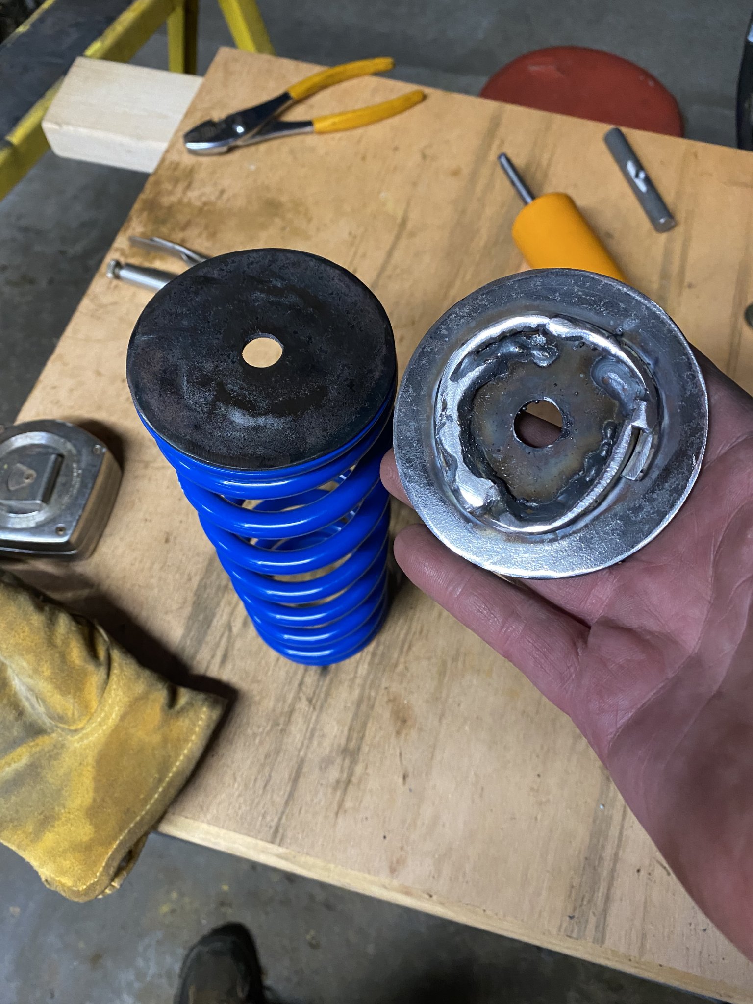

Made some 1/8” x 3 1/2” caps. Welded some 1/4” rod to the bottom as a retainer to hold into the spring. Welds aren’t great looking, but they’ll hold.

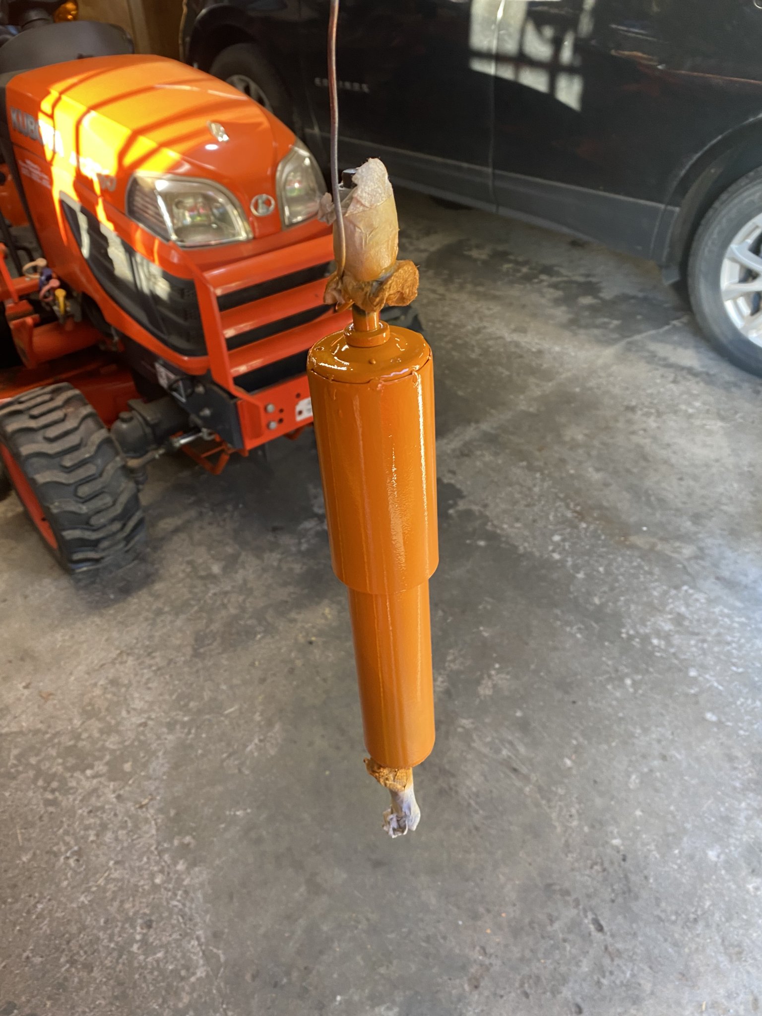

Time to paint the spring to match
Good point.
I will paint/re-paint everything before final assembly.
It will be taken apart several times before I’m done.

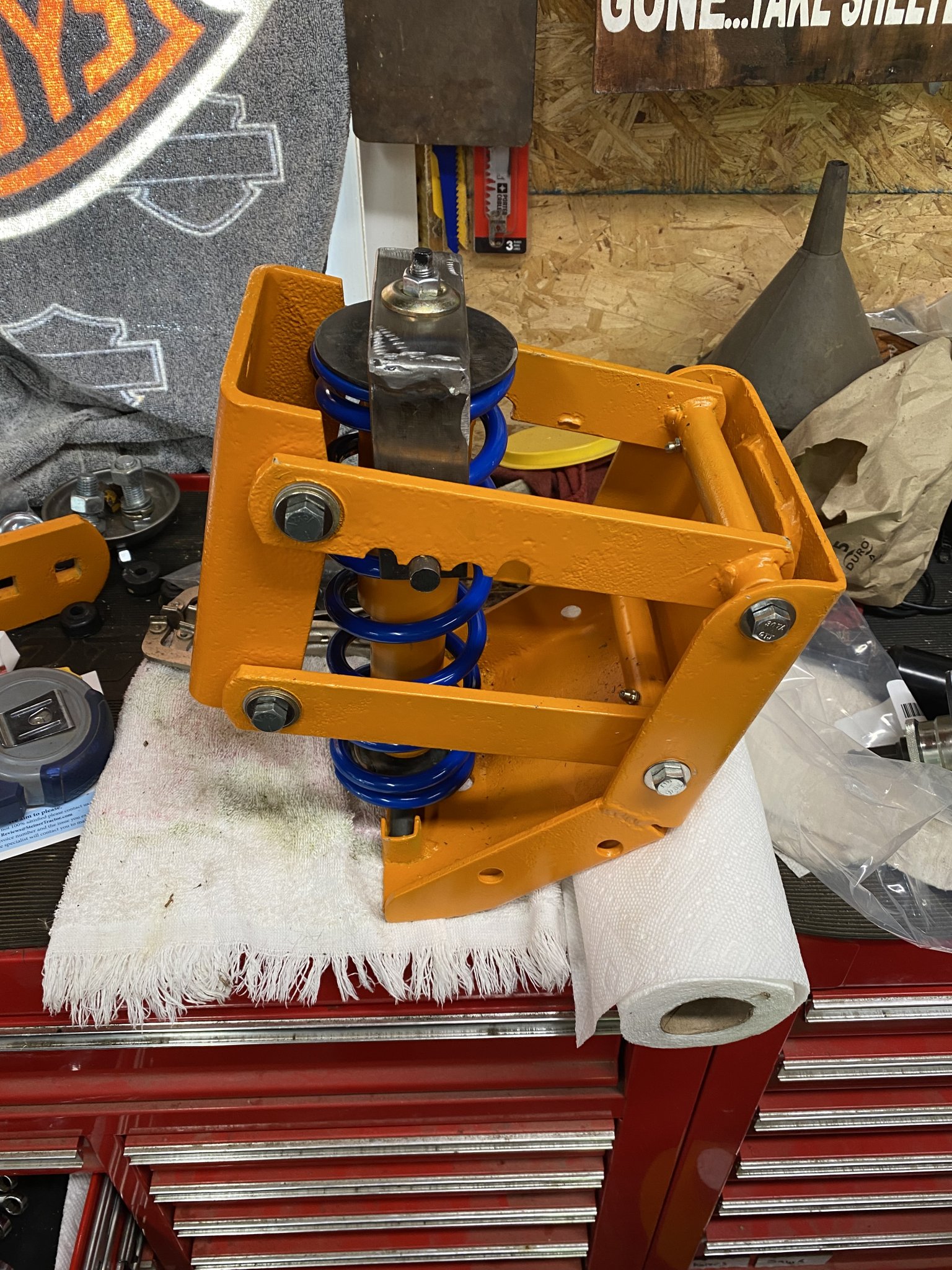

10,105
6,932

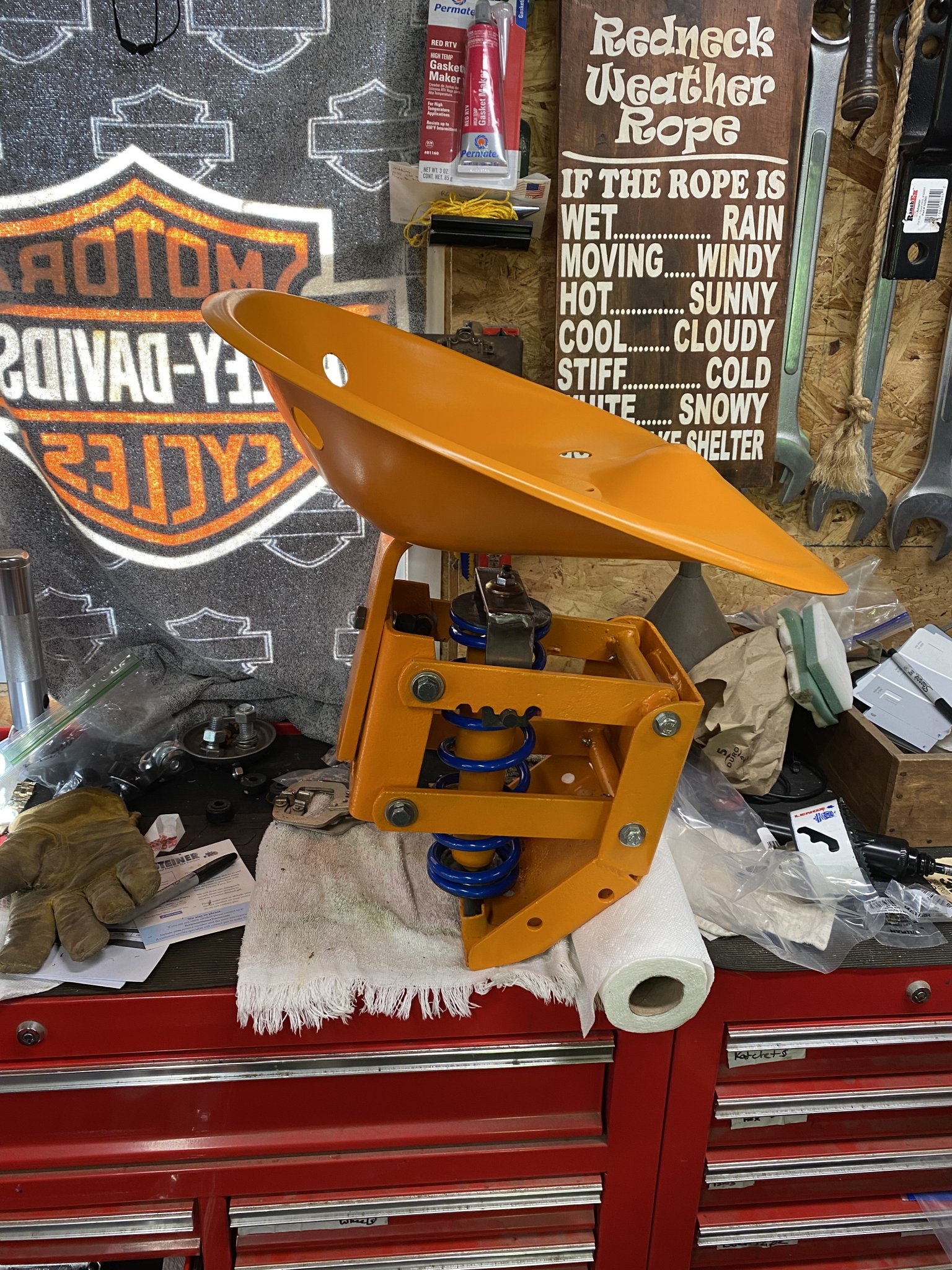

Couple steps closer.
As I was guessing dimensions, there might not be enough clearance to the bottom of the seat pan.
Not the end of the world. I’ll figure it out….

Why wouldn't you have clearance to the bottom of the seat pan? It looks like you have like 2 inches of clearance with the whole thing put together. The whole shock and spring assembly should collapse... Nothing should stick out. Unless there is something I cannot see.
10,105
6,932
True - - I wasn't very clear. The shock was just a little long. I just needed to shorten the studs.
As you said, it will collapse, so no risk of anything hitting/interfering.

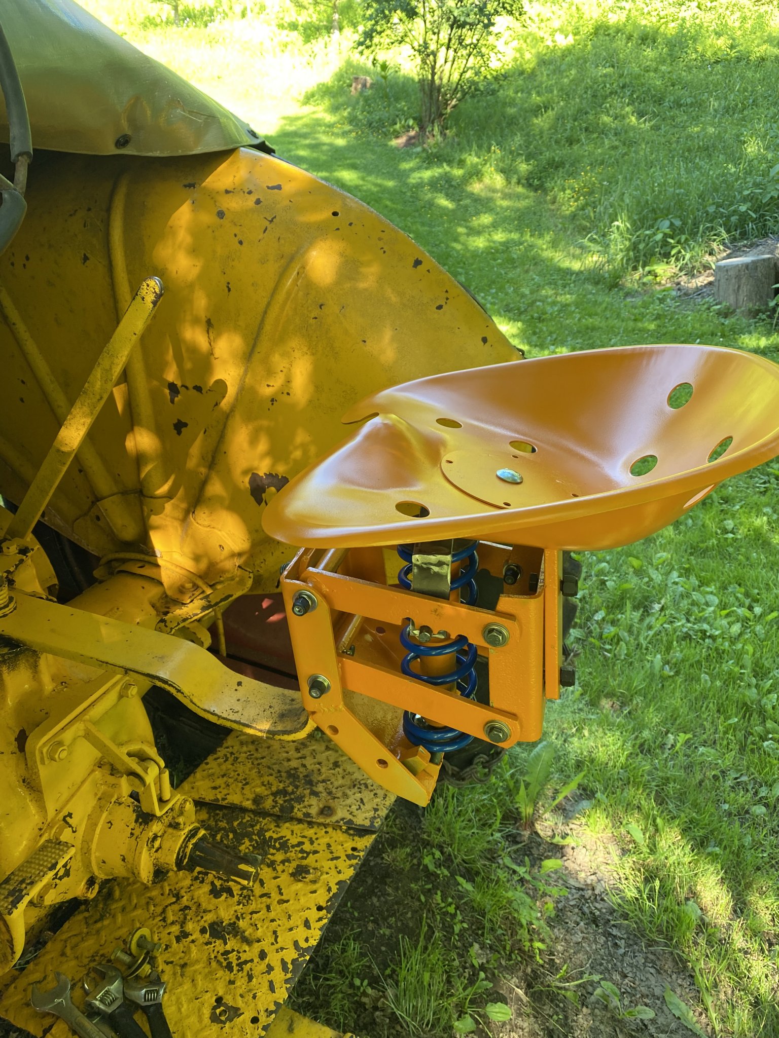

10,105
6,932
Test run. Everything is loosely fastened.
Squashed the coil spring like a small bug:oops: But I didn’t bottom it out! :p
I’m happy with the results. Seat is kinda comfy for an old farm tractor.
