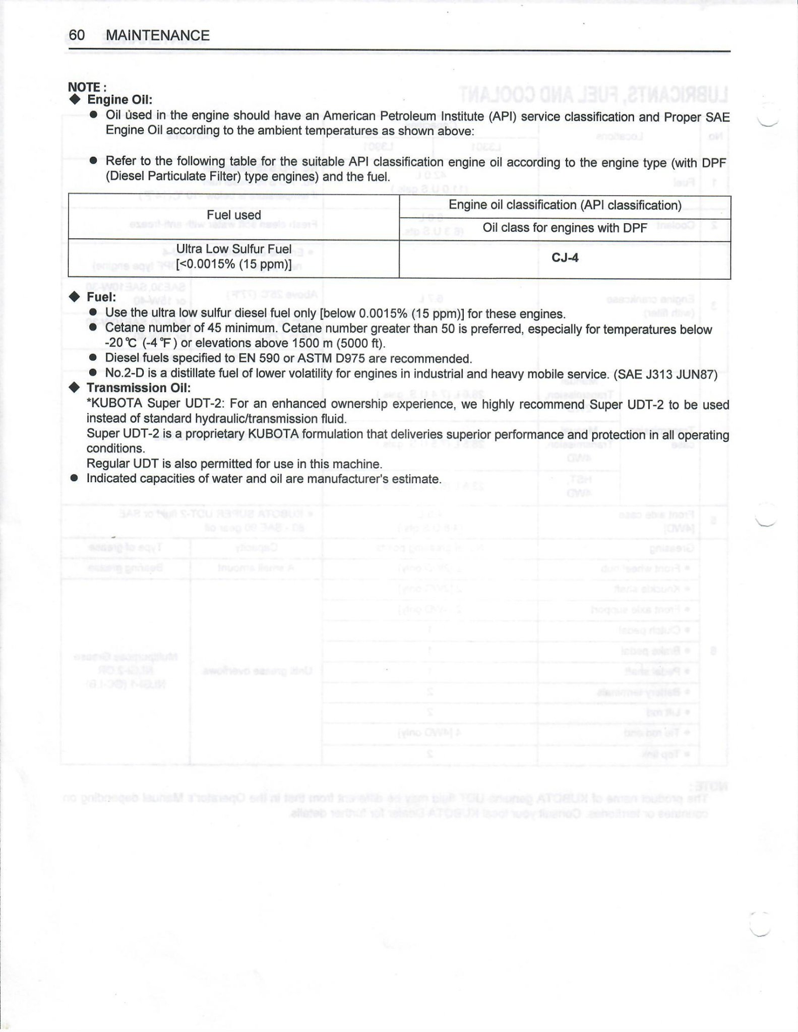

Kubota promotes the use of Super UDT2 just like JD promotes Hygard and CNH promotes Ultraction. But nowhere have I seen any published requirement for the use of Super UDT2. Here are the exact words from the Kubota owners manual for my brand new L3901 - emphasis in bold is mine.
Transmission Oil:
KUBOTA Super UDT-2 For an enhanced ownership experience we highly recommend Super UDT-2 be used instead of standard hydraulic/transmission fluid.
Super UDT-2 is a proprietary KUBOTA formulation that provides superior performance and protection in all conditions
Reqular UDT is also permitted for this machine
I use Super UDT2 because I understand what it is and why Kubota believes it outperforms regular UDT. I have read the datasheets and Kubota's development reports and they confirm the claims. It is a high performance synthetic oil with properties that standard hydraulic/transmission fluid cannot match and I have no problem paying for the superior performance. Ultraction or Hygard would offer similar perfomance but at the same or higher cost
UDT is a different animal with lower performance very much in line with any number of competing oils but it is still acceptable for use according to Kubota. The difference when using UDT (or by inference a generic equivalent) seems to be my owner experience will be less "enhanced". In other words cold weather startup will be harder, operation will be noisier, wet brake/clutch chatter may increase, and I may see an increase in water contamination. But the transmission is still warranted just as if I used Super UDT2.

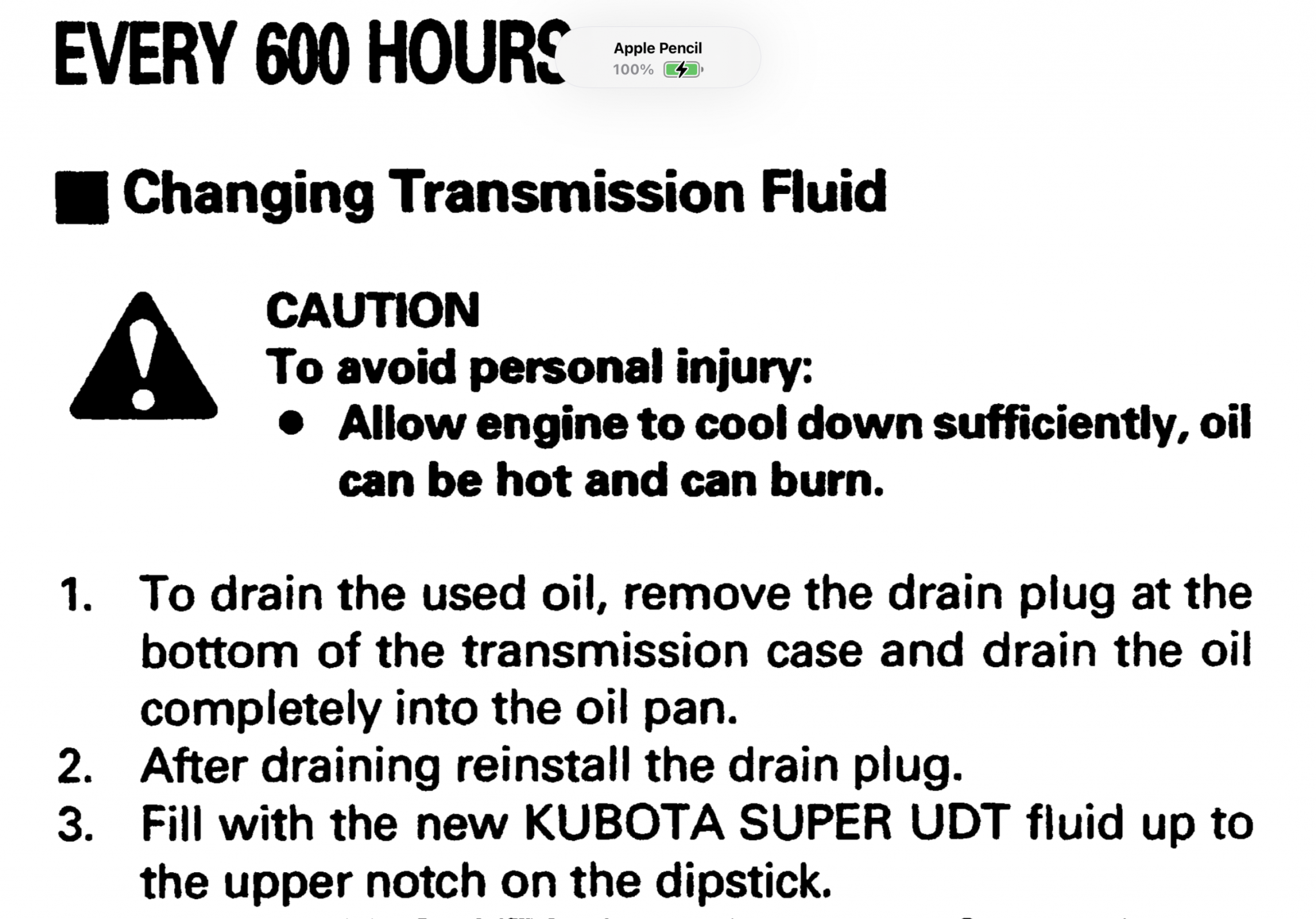

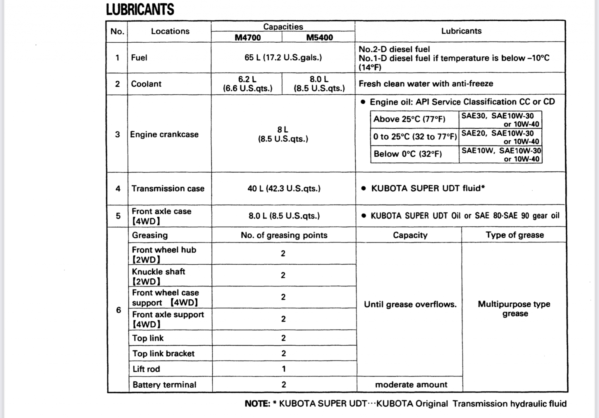

I agree that there may be other fluids that may operate just fine in most Kubota equipment…
But MY M4700 Kubota Owner’s Manual is pretty specific…Here’s two screen shots directly from the manual:

Dan, I didn’t do anything for them. Those screenshots are KUBOTAs instructions.
<edit >When I got ready to do the 600 hr service on my M4700DT I went to the local Kubota Dealer (Ewalds) and asked for supplies. They first sold me UDT despite the clear instructions to use Super UDT. I queried the parts and service mgr’s very clearly and they were FIRM…that UDT or a UDT-compatible they also sold …was what should go into my tractor.
I’m not a “KoolAid” drinker so I was fine with that ….until I read the manual and the WSM specific to my model… and took the generic stuff back to them…and they again did their best to convince me to use what they’d already sold me….they said they’d show me it was OK and call the Kubota regional office up in Dallas…. when they returned to the parts counter with their hat in their hand and sheepishly took back the generic stuff and handed me the Super UDT2 and even discounted it very sharply to apologize.
YMMV

My manual does NOT allow UDT. It is specific…exactly as the screen shots show. (see my edited comments which were being posted as you replied.)
What is even more nuts….. my tractor is a gear-transmission! I would have thought it would operate on baby-butt-oil if I poured it in!

So the KUBOTA dealership told you the same thing I am saying but you insisted they were wrong. My manual has this section in it - is it missing from yours?
