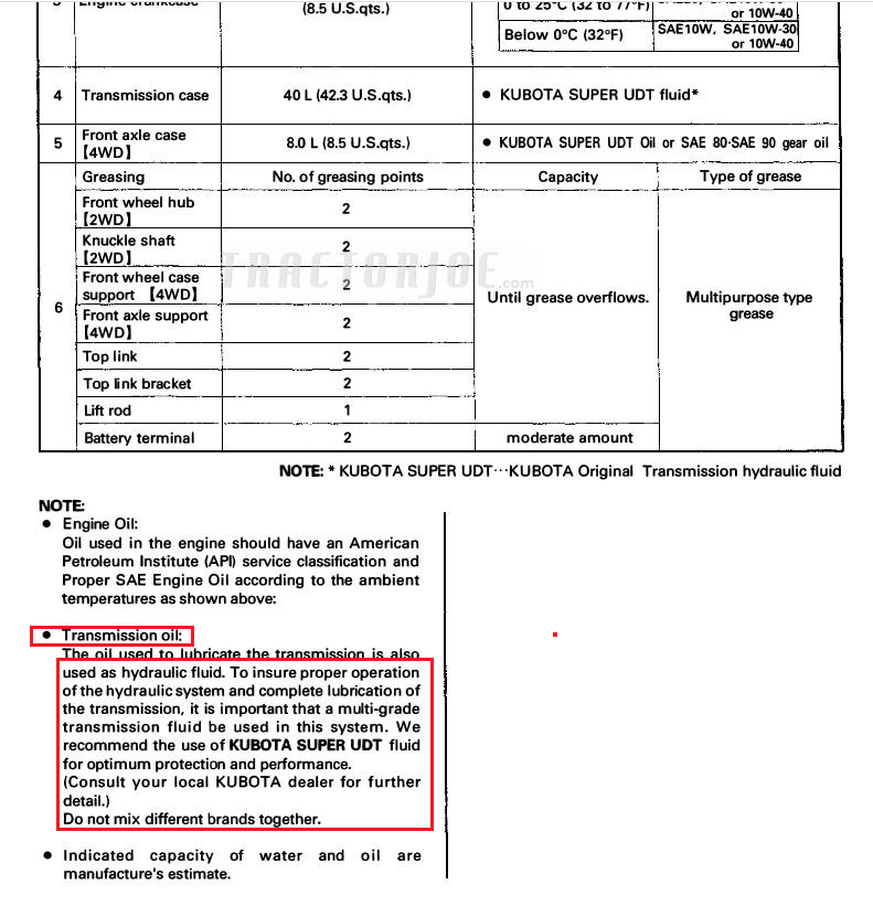

the manuals recommend a certain fluid. IF your machine is still in warranty, and you have, say, a transmission problem, kubota (and deere) have been requesting fluid analyses. If for some reason the analysis says that a certain chemical that is present only in super udt2 or udt is not there, or in very low quantities, they can (and have) refused to repair the machine. The reasoning behind this is that when 303 or whatever fluid is used, kubota no longer has control of the lubrication, cooling, corrosion protection, seal formation, energy transfer, or cleaning properties and at that point it is not their problem. If the user had chosen super udt2, there would very likely be zero question. They'd know if the correct quantities of additives were in the fluid and at that point they're thinking "hey this guy spends a little more to take care of his stuff"....and they're much more likely to fix on their dime.

Kubota UDT, Super UDT and Super UDT2 are three different products. I don't think Super UDT is sold anymore in the US, but appear to be available in Europe. Canada has Premium UDT just to add to the confusion.
https://www.kubotausa.com/parts/kubota-parts-products/lubricants says "Super UDT2" is "Fully interchangeable with standard UDT and Super UDT fluids".

Dan, you wrote “So the KUBOTA dealership told you the same thing I am saying but you insisted they were wrong. My manual has this section in it - is it missing from yours?”
Not exactly…. The Kubota dealership handed out the same thing you were saying…but I had actually READ MY MANUAL….and frankly, was surprised it was so specific….so I pointed out to them the specified Super UDT….which they still did not wish to believe… I only insisted that they get THEIR parts-guy’ opinion** supported by Kubota regional….they called Dallas and they then admitted they were wrong. My manual does NOT have the section in it yours does. My manual does NOT merely “recommend”.….it actually INSTRUCTS to use “Super UDT”. When Super UDT was superceded by Super UDT2… Kubota regional specified UDT2 as the proper substitute for Super UDT.

My reading of the M4700 manual is a little different than yours. From page 44 - Fuels and Lubricants:
"To insure proper operation of the hydraulic system and proper lubrication of the transmission it is important that a multi-grade transmission oil be used"
In other words the machine requires a UTTO.
We recommend the use of Kubota Super UDT fluid for optimum protection and performance"
The use of KUBOTA Super UDT tractor transmission fluid is recommended but not required.
Consult your local KUBOTA dealer for further details
You didn't believe them when they told you all you needed was a premium UTTO.
Do not mix different brands together
If using a UTTO other than SUDT do not mix different brands.

Dan, I don’t know why your perspective is so locked into “universal is OK”…especially when I’m telling you I did EXACTLY what the manual instructs: Since I initially believed as you express… I CONSULTED my Kubota dealer… whose parts-guy was MIS-informed because he believed as you do (and as I once did also) that other fluids are permissible. The fact they use the word “recommend” Super UDT …. doesn’t mean they approve any OTHER fluid except Super UDT. Their earlier statement in that paragraph telling the importance of a multi-grade fluid does NOT make approval of a “universal” fluid…. it only points out that Super UDT actually IS a multi-grade fluid…. as recommended by Kubota.
What would you expect them to say…?? …. that the use of Super UDT is “required”…?? Kubota is not a regulatory-agency with enforcement-powers over private owners of machinery. They cannot “require” anything. They also ”recommend” the use of diesel fuel…but can they prevent an owner from using peanut oil if he wants to..?? Peanut oil/Biofuel burns in diesels just fine and if an owner wants to he can….just as you can use the Tractor Supply stuff if you want to.
The problem will be that if you use the UTTO and you go back to Kubota and complain because your machine took a dump and you try to blame their parts-materials for the failure of that stuff to do as well as the Super UDT then you are likely to be laughed out the door.
We’re arguing over a minor issue. I‘ve already agreed that other refiners likely make fluids just as good as Super UDT and that the average guy might use them without difficulty. But Kubota does not approve of it.
I’m only pointing out that for the guy like myself who will likely only make ONE SINGLE 600-hour service in a lifetime of ownership that it’s easy, simple, safe, and sensible to use what Kubota will APPROVE of and specified in the manual.
Kubota approves of any major brand motor oil that meets the industry-standards for diesel engines.…not requiring the use of “Kubota brand” motor oil. But NO industry hydraulic-fluid specification is standardized/published so that alternatives to Super UDT can be determined. Solution: use what is specified in the manual… Motor oil industry standards are specified in the manual….. hydraulic fluid is also specified: just not by an industry-standard.
I use SUDT2 in my tractor because its one of the best UTTOs on the market and its affordable. Is that not sufficient without inventing some mythical requirement.
There is no formal standard for UTTO but the industry has a defacto standard that works perfectly well in just about every tractor ever made. Big machines with friction sensitive power shift or CVT transmissions may be an exception. They need a carefully engineered friction modifier package tailored to the machine. CUTs with HSTs are not in that class.
