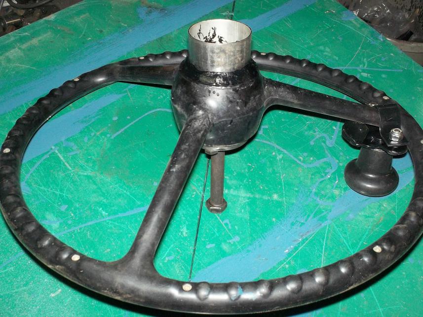

I changed oil in the steering box yesterday as I noticed a rust streak on
top of the steering box Colum drain hole. lucky no water in the oil. so I made drip tube that I glued to the steering wheel. I used eurathane windshield glue. awful good stuff. I patched up my old snow plow ford tractor tire 2 years ago and it,s still holding.
http://www.orangetractortalks.com/forums/attachment.php?attachmentid=18951&stc=1&d=1447555766
