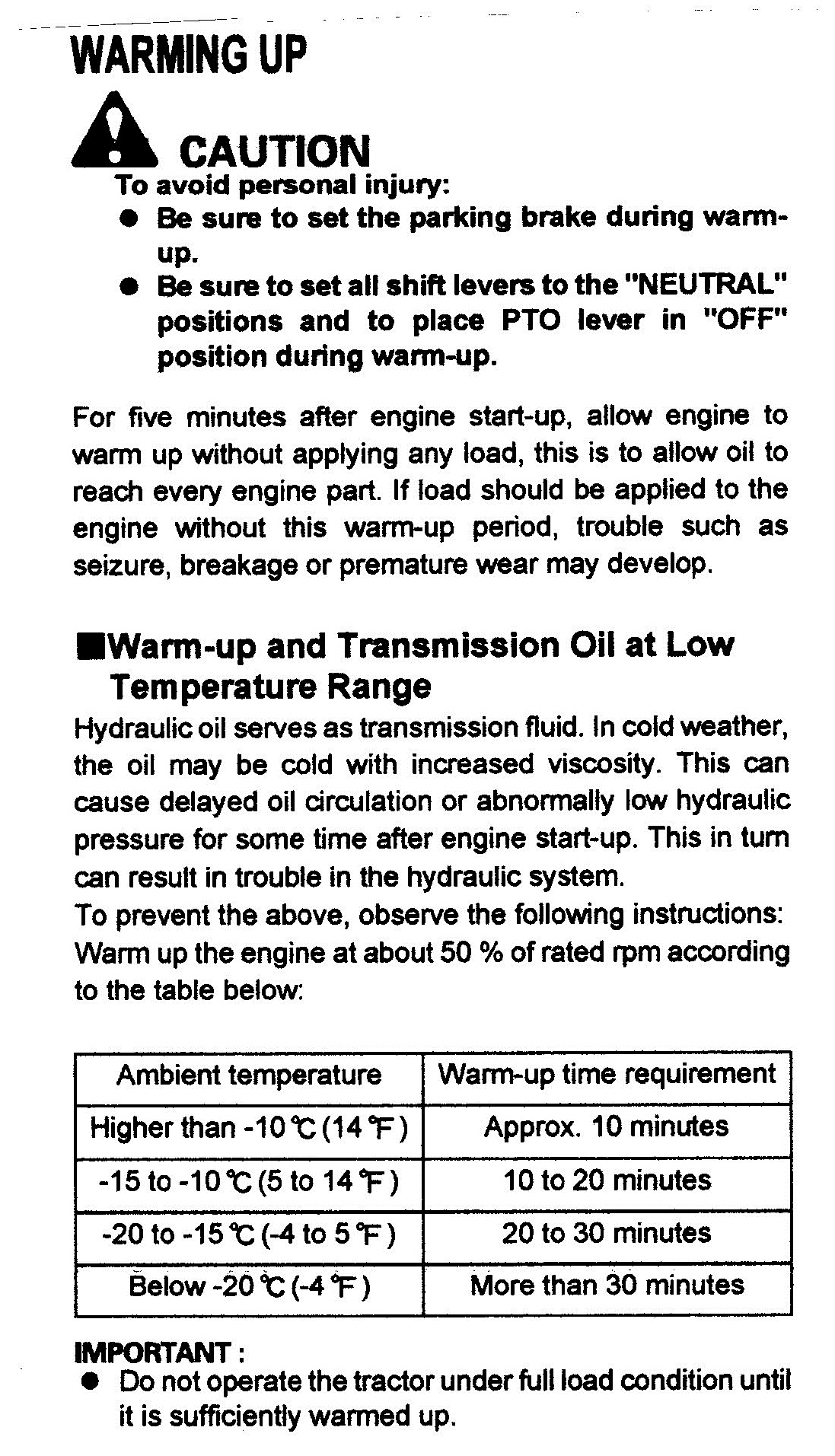

If you are not following these instructions from the M7040 Operators manual, try doing so before staring to get into hydraulic valves etc.
My 2012 M7040 is erratic if I get impatient and try to get moving. I have a block heater which I can turn on from my home. The engine starts easily if you follow the procedures for glow plug control I will attach to this post. Regardless of how easy the engine starts, I leave mine idling at 1,500 rpm and go back to my home for up to 30 minutes.
Dave
10,019
4,115
brr, at 12F, the chart says warmup is 20 minutes. After that I'd slowly 'cycle' all the levers,several times to get the cold oil mixed in with the warmer oil.
