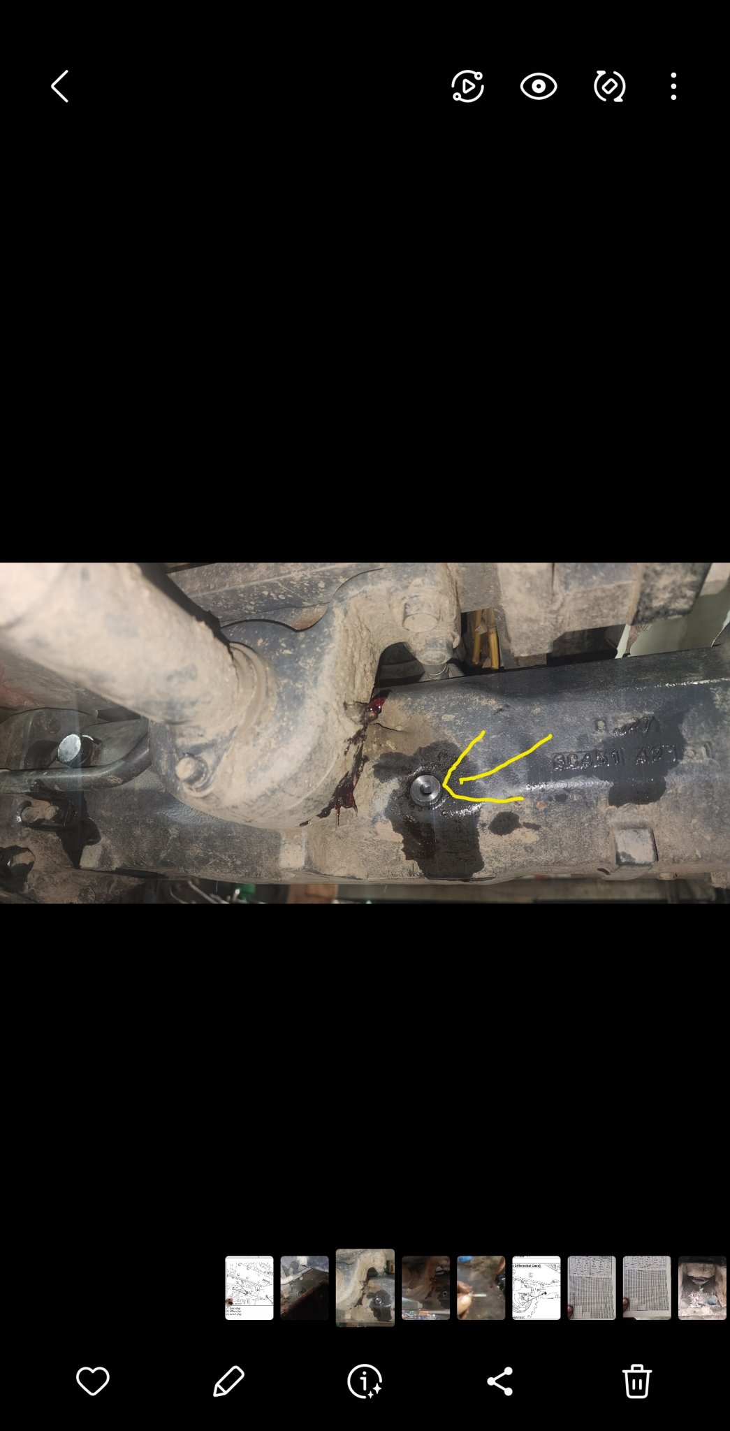

You removed the 12mm head shutter mounting bolt rather than the 14mm head oil plug. I would be surprised if your dealer could get a warranty payment for operator error.

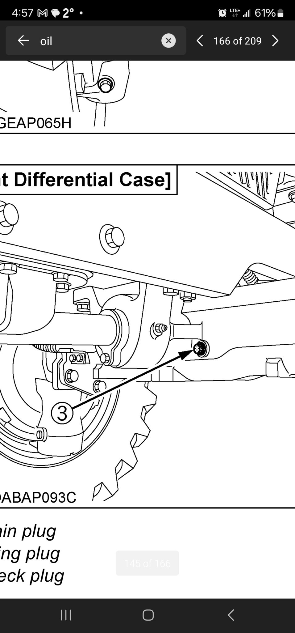

I removed the one labeled "drain" theres literally no other plug....... newer manual shows it as drain, older shows it as check.

How would it be my error to follow the manual...... I posted the picture of the manual page and of the plug I removed. Literally the exact same and it's the lowest plug on the differential....

Please do explain how I could take this any different.... one shows it as check and one shows it as drain but in either case it has to come out to do it's job.

Well I figured this out and it was strange, the manual listed online is wrong.... it used to be used as a drain in some models and is still threaded but was changed to be used for a flap.... inside the axle that serves no notable purpose. So we took the axle out, put it back in place, reassembled and all is good. I emailed manualslib to tell them their manual has a mistake in it. Curious how many other people ended up with this issue

It's screwed into a plate is why it didn't just spin.... why they didn't mount it internally and not setup this easy to make mistake and have a version of the manual to guide you to this mistake.... no idea. Luckily it was easy to remove the axle shaft and fix this

The reason for the shutter plate is to keep the diff from shoving all the oil to one side of the axle case starving the other for fluid.

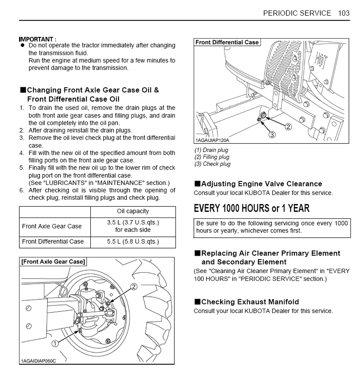

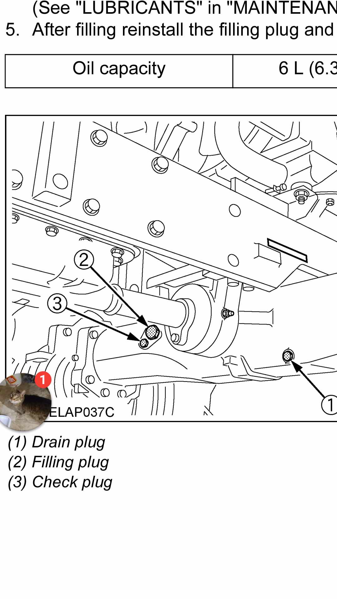

Here's the front axle gear case oil and differential case oil check/change procedure on my M6060.

Your manual better shows what to do on mine than my paper manual... lol. Obviously I made the mistake but it's a very poor design choice to reuse a hole used for plugs in other versions of that tractor to hold a shutter. Especially when it's an easy to remove bolt that on alot of other tractors would be the drain plug.... or check plug
