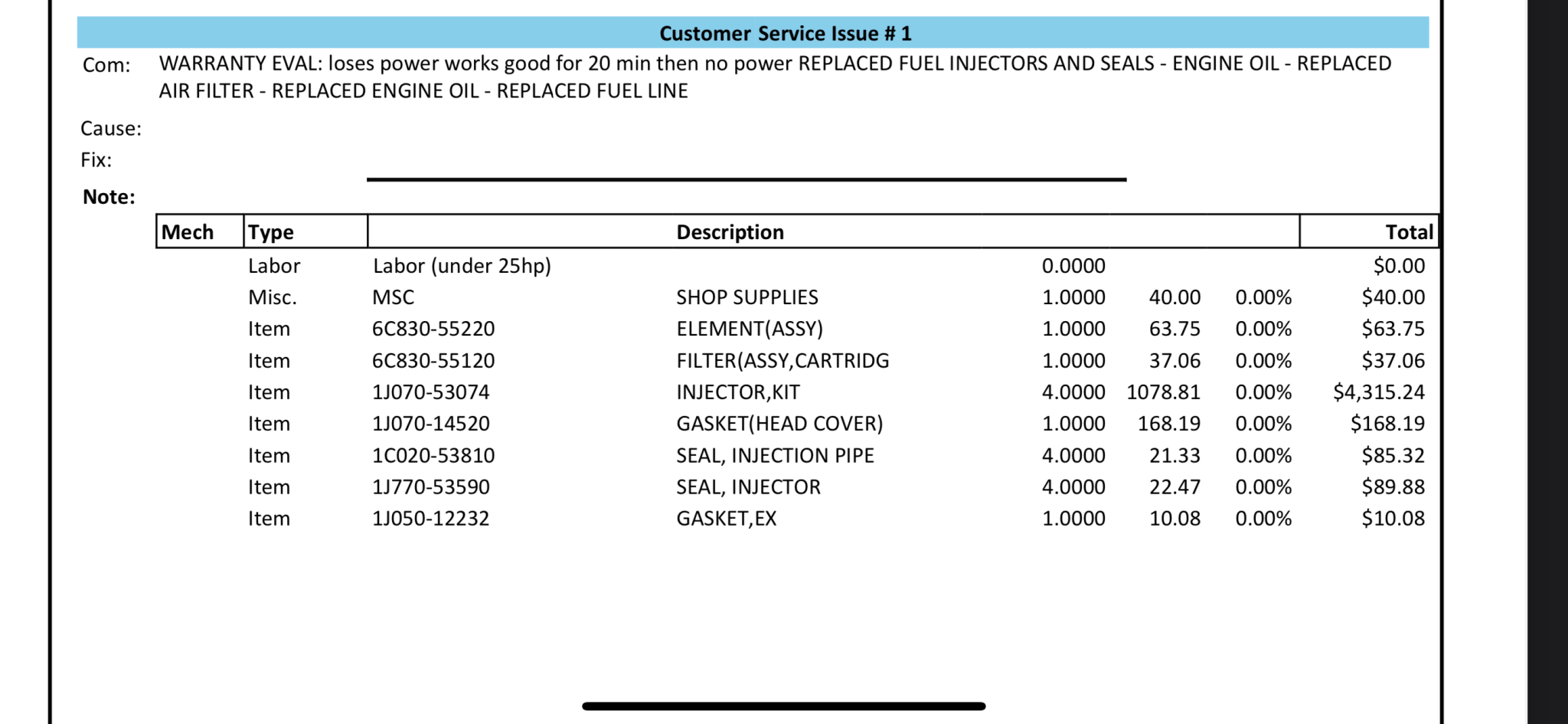

Looks and sounds like an engine issue to me. You showed us behavior in different HST speed ranges. You did not show us neutral. When its hot will the engine speed stay at max with range in neutral and HST pedal depressed?
replacing injectors and manifold I think they said and I stopped listening as she was rattling off a long list of stuff they were doing. It’s a “campaign” of some kind. I don’t know if that’s a word used leading up to class action in the future.

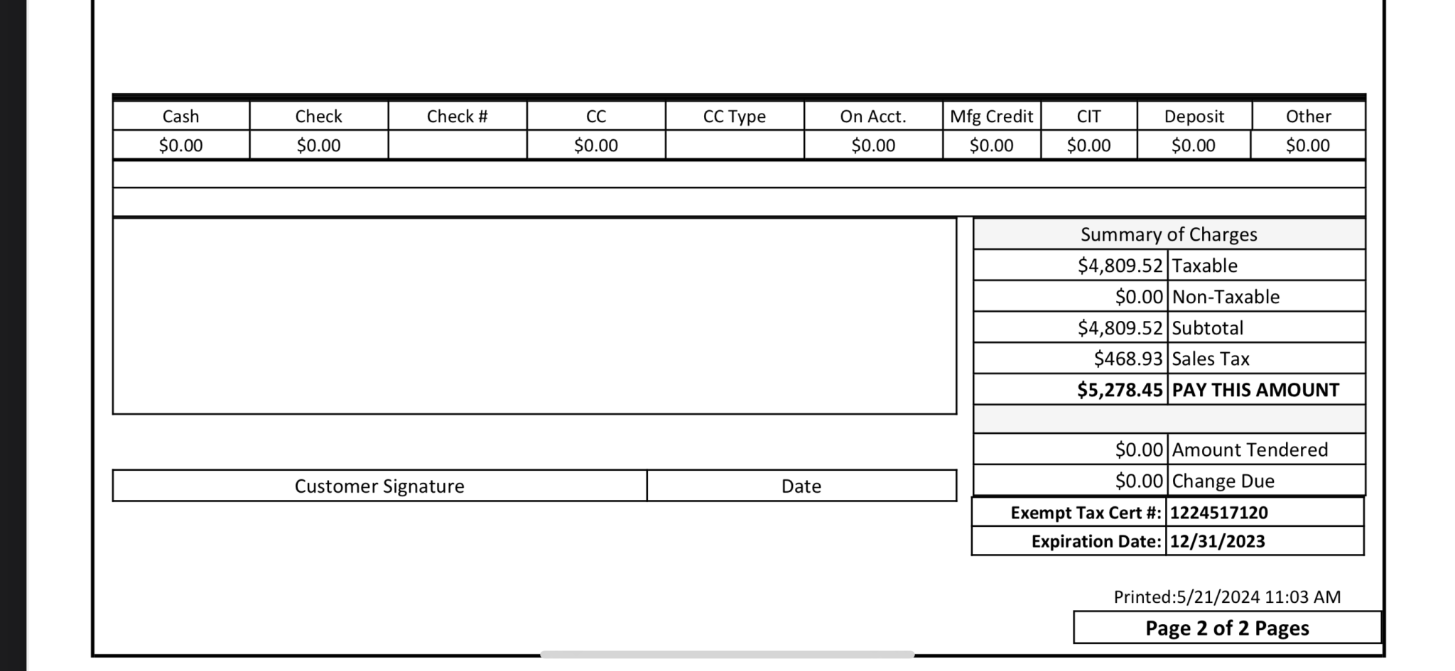

Did you have to pay the bill or was any of it covered by warranty?

I am having the exact same problem, tractor is fine for about 15 to 20 minutes then when it warms up it stalls when going forward or reverse. Loader is slow both up and down. It acts like a restriction in the hydraulic system. Engine will idle fine but when you press the forward petal the RPM’s drop and the motor sounds like it’s in a bind. The lx3310 hst is at the dealer now I will update with results..

The tractor is running perfectly fine after the engine overhaul.
Engine overhaul??????????????????
According to the invoice they replaced the injectors which might be considered a tune up.
