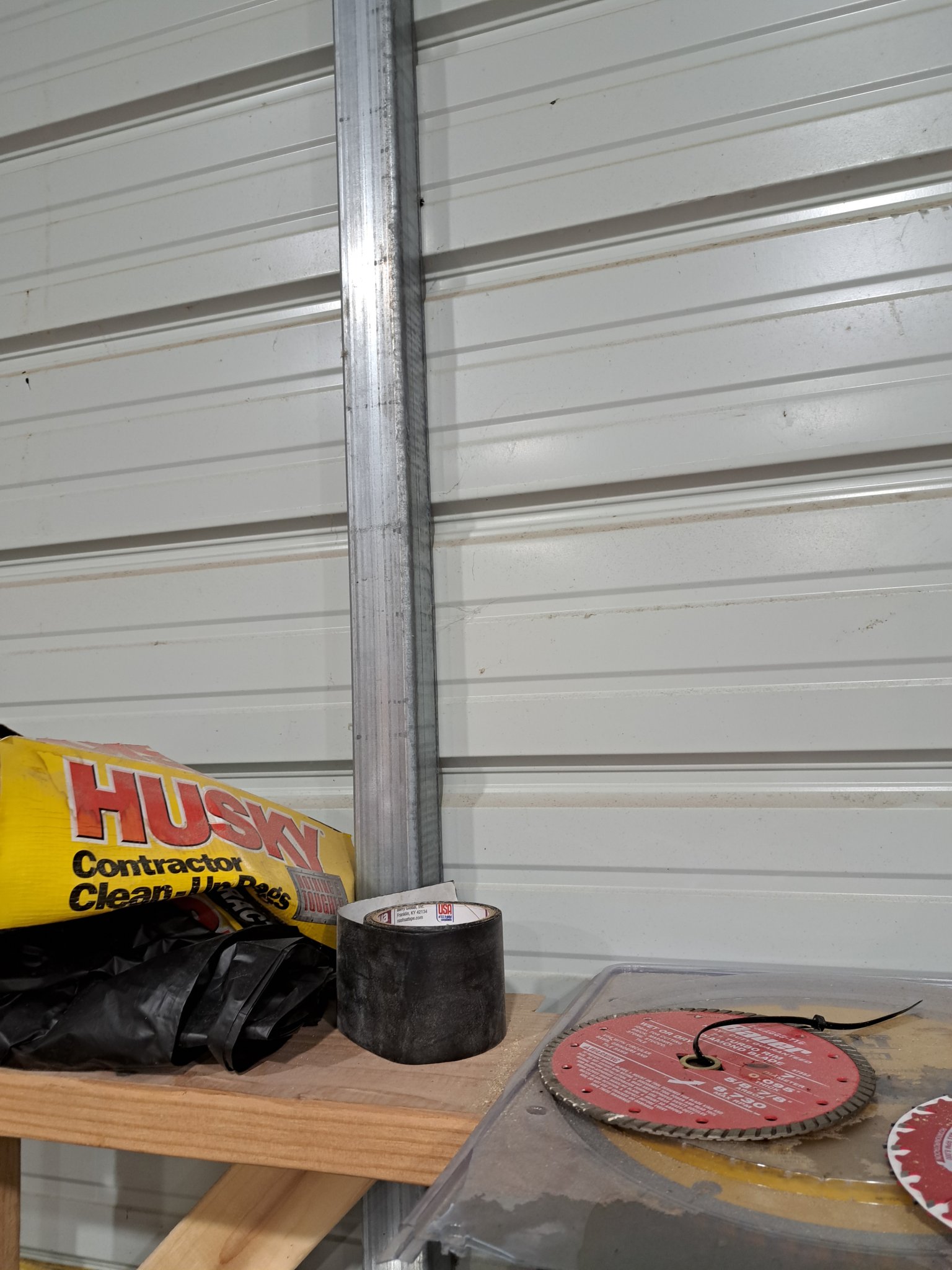

'square tubing" like this?

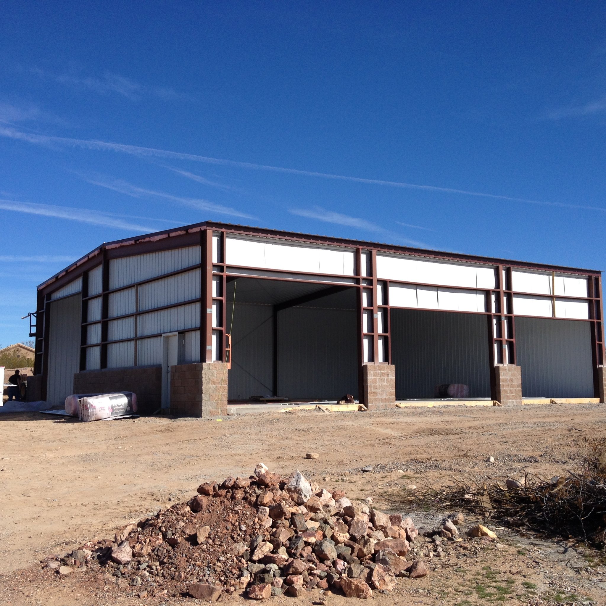

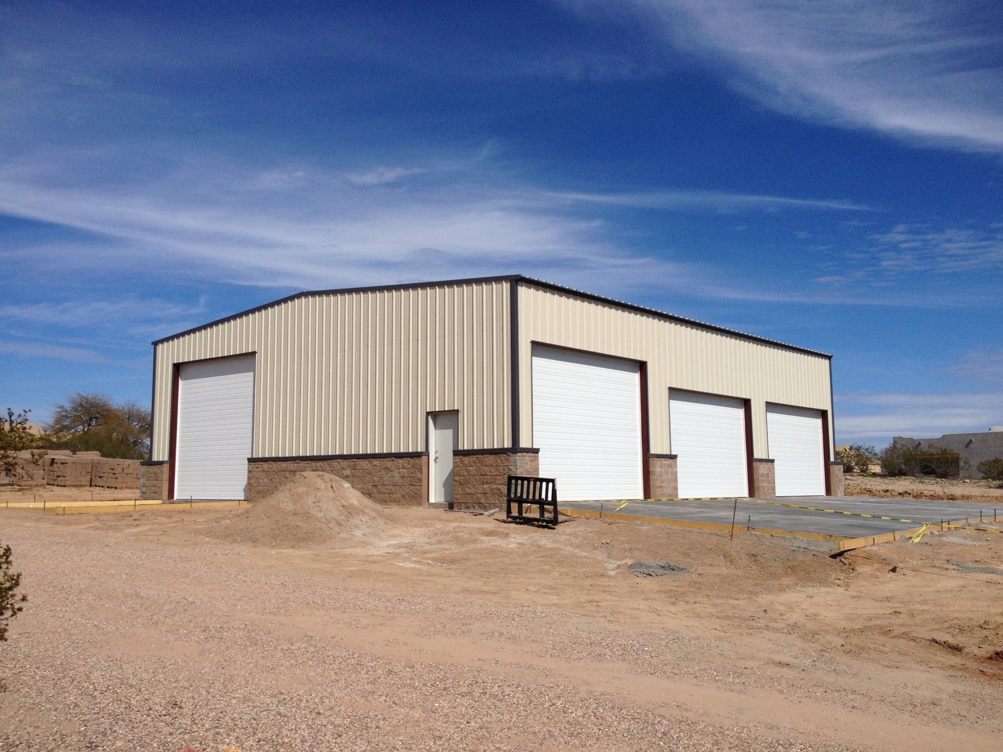

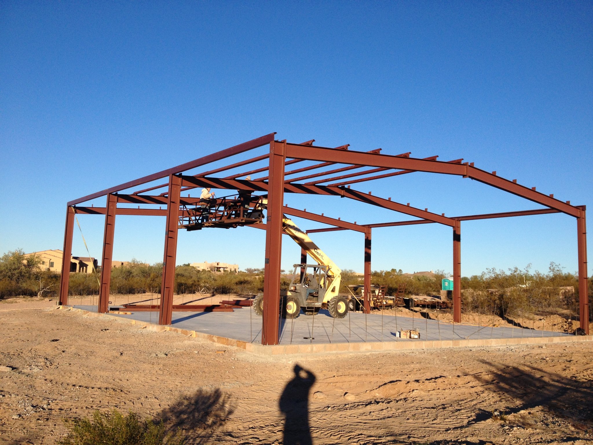

I ended up going with an all metal 50x60 building with block wainscot to break up the drabness.
Slab cured and framing going up.
Inner sheeting going in. 12 inches of insulation going in on the roof, 9 " in the walls before outer skin is installed.
Aprons being formed and poured. Needs some landscaping done, but base building is complete.
Doors being installed
Slab cured and framing going up. View attachment 123664

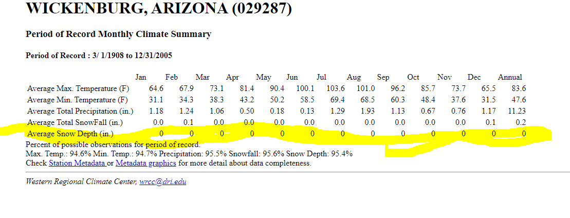

Regarding the snow-loading, Oddly enough, my county required it being designed for a 50lb snow-load... :O I live on the southern fringe of a county which does from time to time experience that sort of snow load at the higher elevations (over 1 mile high), but NEVER at the elevation of this part of the county. BUT... They would NOT budge, even though the charts showed my location was not in the area that required it... :(
34,307
9,531
You in Maricopa or Yavapai county?
I lived in north Phoenix for 22 years.
Gotta love their odd regulations based upon some event that happens once every 1000 years.
For those that don't know Wickenburg is about an hour north west of Phoenix.
It never gets more than a dusting of "snow"
