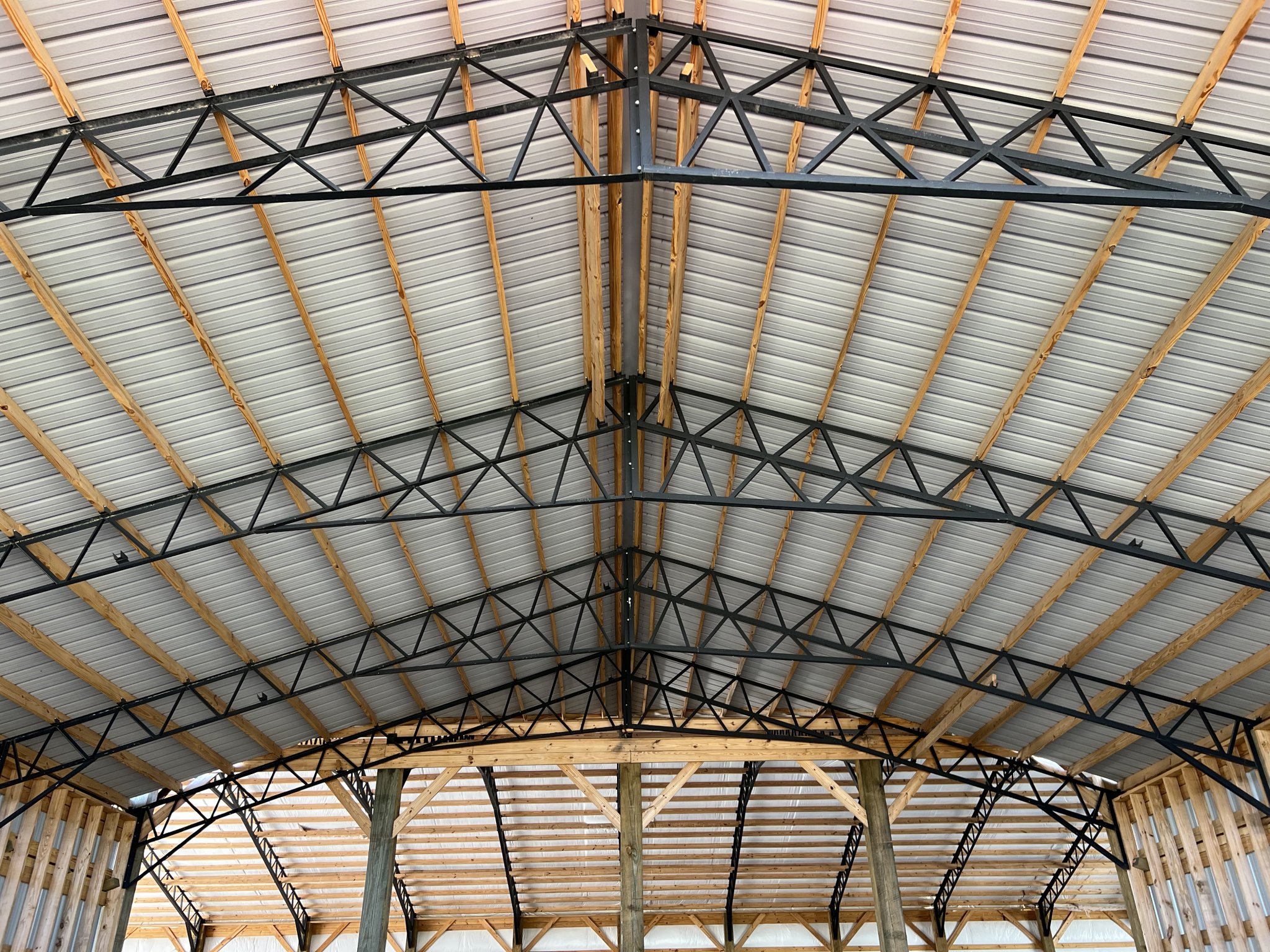

I am going with a hybrid (I think). Wood walls & steel trusses. Something like this.

Where did the trusses come from?
Who designed the structure? What is the structure type called (stick built, pole bar…)? Seems like a lot of studs in the pictures…
Bear with me on this. I have seen & visited with 2 customer's/buildings that are 2 years old. No complaints. I talked with the business owner, he said all the right things. Does 5.5” concrete with re-mesh & footing, himself, properly cut. Bends his own siding & roofing metal. Pole barn style buildings are engineered for area. Says the steel trusses are over engineered for the area. Uses closed cell spray foam (R33-37), doesn’t like the vinyl back batts, but will use if you insist. Several times, the owner stated his preferred method of building because he doesn’t have any problems. I’m thinking he’s not having problems because owners are not having problems. I’ll get more info when I visit a job site Monday. Not cheap tho.

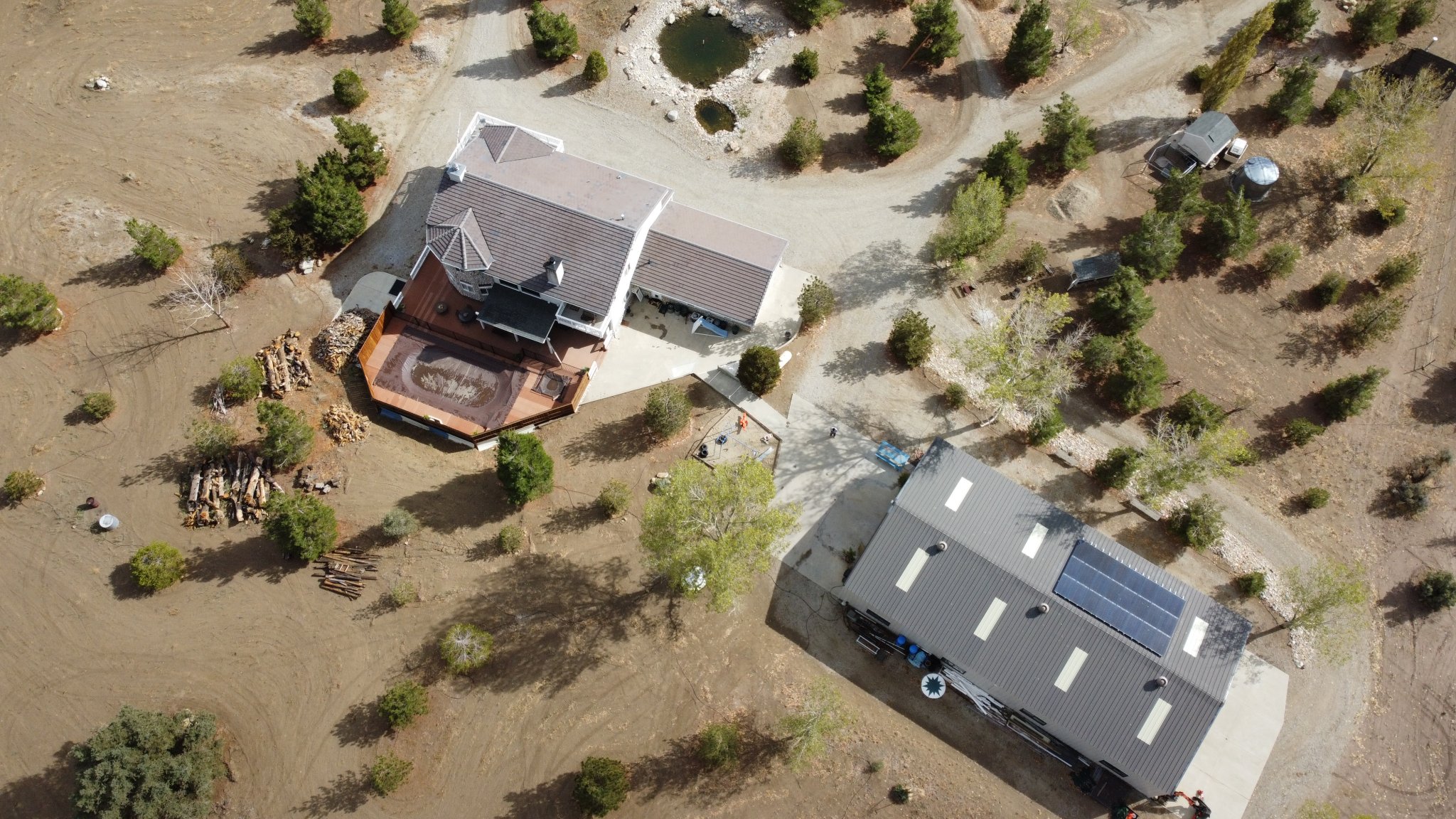

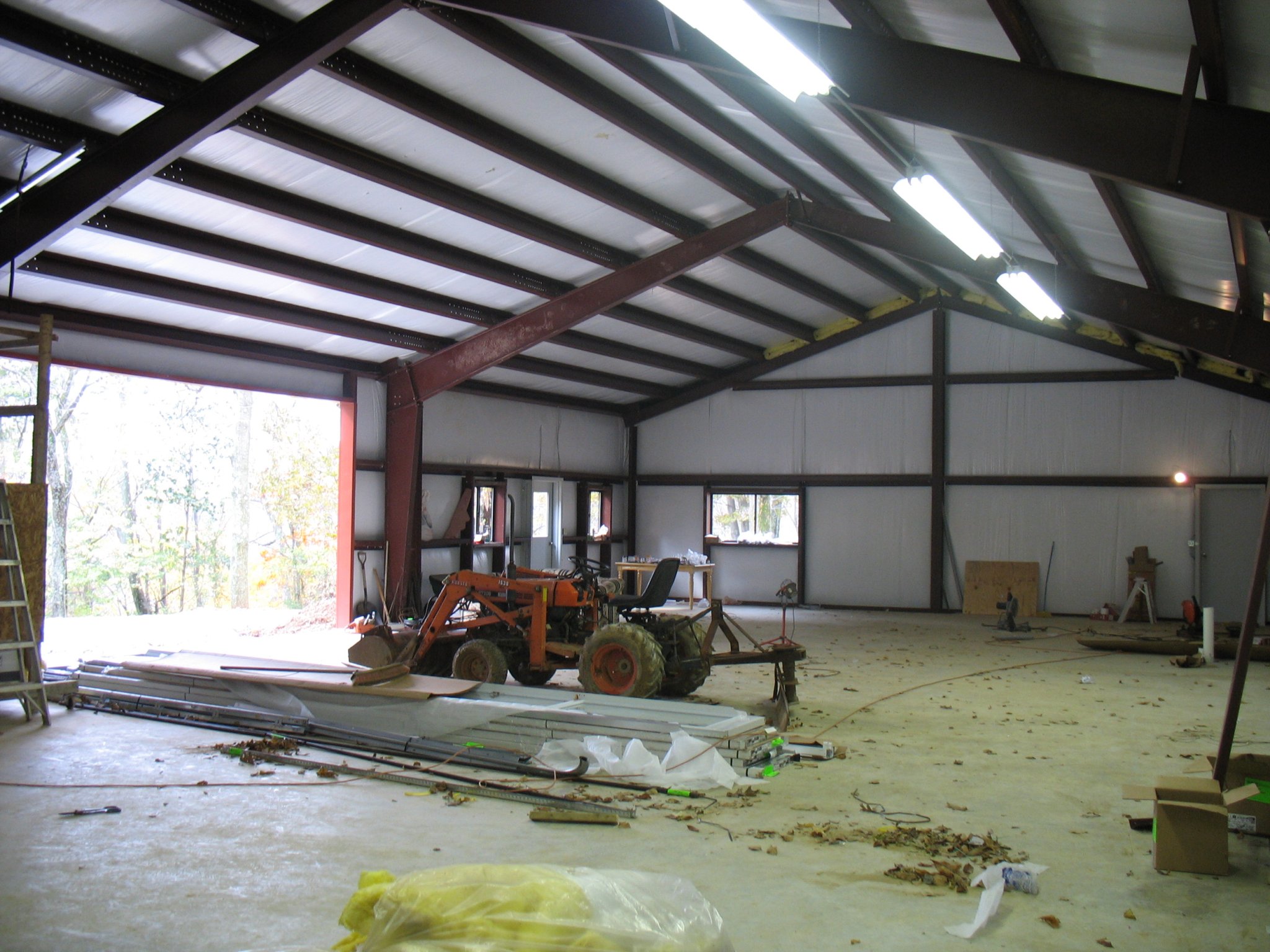

I have no idea what sort of building you are considering but if its an engineered building it should be fine. Here is a picture of my engineered clear span shop going up. Came with three copies of teh engineering calcs - one for me and two for the building permits department. The purlins and girts are all 14ga. In addition to gauge a major factor is cross section shape and dimensions. Z purlins are stronger than C purlins. A larger 14 ga purlin may be structurally stronger than a smaller 12 ga purlin.
Reactions: 6 users
6,590
8,766
Now that's a building. Very cool! (y)
9,720
5,135
Retirement gift to myself but to get approval from my lovely wife of 50 years I had to partition and finish a piece of one end bay for her "craft shop" That's her private entrance and picture window on the front left corner.....
Is that 40ft x 60ft or 30ft x 50ft or something else? I like the size and what a great shop you have there.
9,720
5,135
Thank you - and in 2006 it was incredibly inexpensive.
Overall its 75 x 40. The wife got 20 x 25 out of the first bay and theres a full depth loft over it. There is also a bathroom and small office at the rear of her craft shop. Center bay has a 20 x 10 overhead door and a two post vehicle lift. Bay 3 houses my little machine shop and has a 15 x 10 overhead door.
My only complaint is the heating bill....
6,590
8,766
Thank you - and in 2006 it was incredibly inexpensive overall its 75 x 40. The wife got 20 x 25 out of the first bay and theres a full depth loft over it. There is also a bathroom and little office at the rear of her craft shop. Center bay has a 20 x 10 overhead door and a two post vehicle lift. Bay 3 houses my little machine shop and has a 15 x 10 overhead door.
That's awesome! Pretty much a dream set up for many of us here. How do you heat it? I'd love a heated space for all my welding projects that get put on hold over the cold winter months. Once I get some sheds built this year I'm going to look at a heated metal working area.
9,720
5,135
I have a ceiling mounted 150K BTU LP unit hearer hanging in the middle of bays 2 and 3. It will keep that area at a very comfortable 70 degrees. It will also chew through $1K of LP in a month. Consequently I only run it when the shop is in use. Insulation is good enough to keep it above freezing overnight and most mornings its around 50 when I turn on the lights
