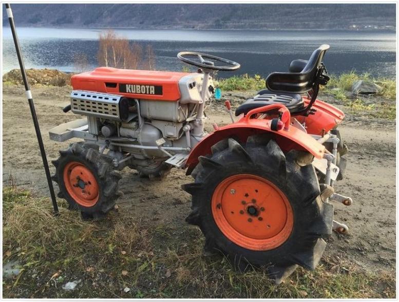

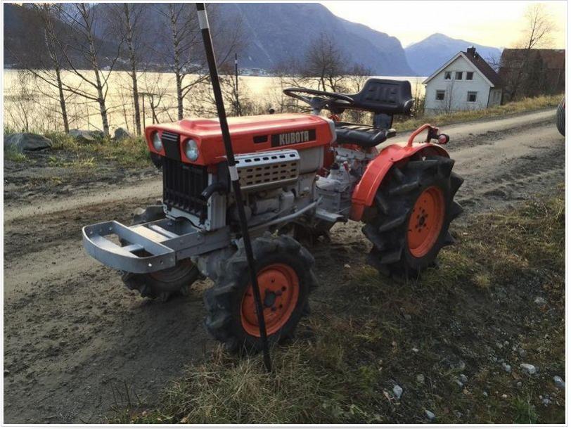

Some photos of it..
First one is right before easter, when we suddenly had half a meter of snow.. And I sure wasn`t prepared for snow again!
Kubota_snow_20150326
This is the rear underside, it seems like it has been painted light grey some time..
Kubota_rear_gear_20150419
The front, more proof of earlier dark paint.. Does anyone know what is behind that "lid" at the top front there?
Kubota_front_gear_20150419
The front right hub, should this be taken apart and cleaned perhaps? Seems to be old paint coming of there..
Kubota_right_hub_***x27;20150419
Rear PTO (there`s also at the front) and 3 pt hitch. The arms seem to have be cut and welded shorter?!?
Kubota_rear_pto_20150419
And finally, the engine... :)
Kubota_engine_20150419

roverbug, was it painted the light gray to hid it in the snow??:D
That "lid", if I understand what you're referring to is a pin you front axle pivots on. They usually have a bushing on each end. You'd need to look at a parts book to be sure.
Check here to see if you can find any manuals for your tractor.
http://www.kubotabooks.com/
Since you've changed the out the oil a few times to get rid of build up in engine, I'd add a good injector cleaner to your fuel and put 2 or 3 hours of hard work on the machine.

roverbug, that is a beautiful machine! It seems to have been cared for pretty well, except perhaps for oil changes. However, you will notice that the motor oil in diesels turns black just moments after pouring it into the engine! :D
What D2Cat said!
That may clear up the smoking. If not, it may be a diesel pump timing issue. Diesel tractors will tolerate a lot of neglect, but as you learned in the decompression thread, they suffer with improper decompression, and they also suffer from all fuel problems (timing; quality; moisture; excess).
Best wishes on your "new" beauty, and please keep up updated!

It dug itself out with ease. With just the rear transport box I managed to clear some snow and flatten the area abit.. What do you call that in english btw, the rear transport box?
Kubota_logs_20150323
I`ve got a small ATV-trailer, that I have been using behind my mini-digger, but it`s to week to drag it uphill with much load. So the Kubota is handy now for the trailer. The trailer mount is mounted in the rear box, but I want a proper mount later.
Kubota_trailer_20150331
And that`s when I found out that it looks like the rear lower links of the 3pt have been cut and shortened, sine other appliances doesn`t seem to fit...
And thanks for the Kubotabooks-link, I have read myself up on the instruction manual, which in turn made me wonder about the engine/drivetrain combo.
It says in the instruction that the B5100D has 2syl engine, 2 speed pto and smaller wheels than the B7100D. I have 2 syl engine, 3 speed pto and large wheels. And the rest looks like B7100D aswell... Anybody seen this before?
