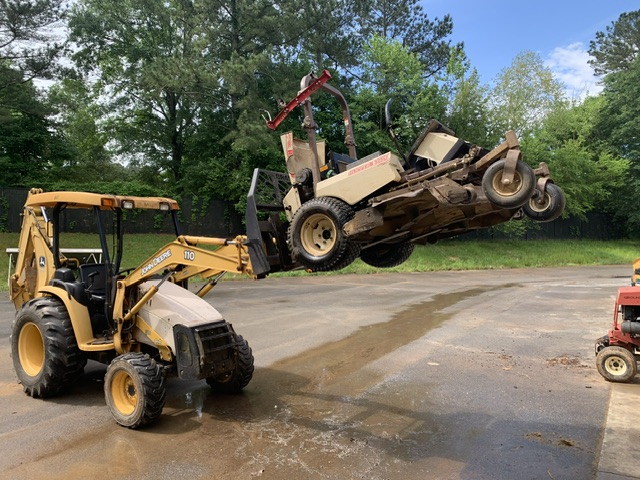

I installed a 23' long 4by8 I-beam across the garage,under the ceiling, sits on jack posts.
started with 2 chain hoists, now have an electric one as well. Push of a button is MUCH easier than a zillion pulls of the chains !!!
beam is near center of garage and works great to split tractors.

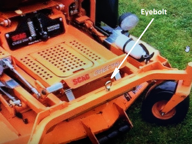

Since I already have an Engine Hoist (useful for tasks other than removing engines) I just hook it to the front of mower (eye bolt) and jack it up.
At roughly a 45° angle I can easily get to the blades or clean underneath the deck.

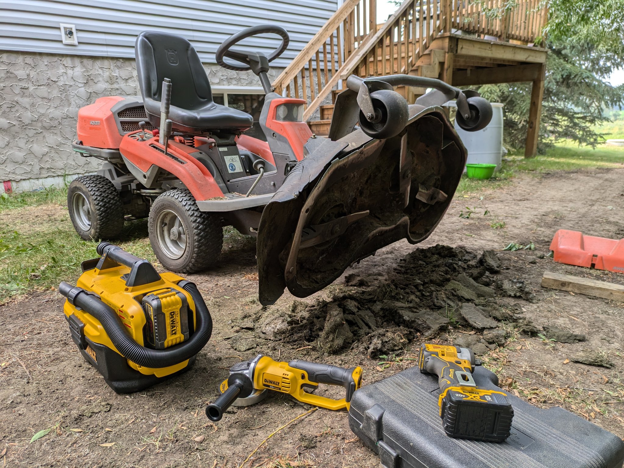

Not quite a zero turn but one of the features I like best about my Husqvarna R322T.

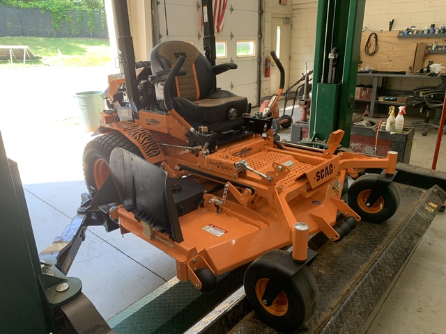

2 post at home
2 post at work, just bigger.
the home lift is a maxjaxx that's set up to work with a 10 foot ceiling (i.e., garage). Works fine for SxS, UTV, ATV, mowers, etc--but not quite enough lift for doing a lot of car work. I will change oil on the Mustang with it but that's about it. It don't pick up but about 48".

I think I want to go this style of mower when I replace my ZD326. Deck cleaning is one of my biggest gripes, getting harder to do the older I get.
How do you like it for mowing and maintenance?
I really like it for mowing, it's not quite a zero turn but it only leaves like an 8" circle of uncut grass if you crank the wheel.
The R322T has all wheel drive which gives it loads of traction on my hills.
With the snowblower on in the winter it'll go through pretty much anything.
It's really easy to work on with everything accessible. There's a couple of known issues with the belt system but they're well documented on another forum.

Some are easier then others.
used to be a grasshopper dealer. That was a selling feature. I never used it at work unless the RO said "deck tilt not working".
Some of the Kubota's have a pivoting front axle that will jack the machine up high enough to get a wrench in there. It locks too, so it won't fall. Pretty slick setup if you ask me.
after working on the floors for 20 some years and my knees getting achy, when the funds was available I immediately bought a 2 post lift. It's got a SxS on it now, working on it for a customer, but I use it for a LOT of stuff. Pulled the deck out of my ZG127 this past winter and had it on the lift (just tied it to the arms so it wouldn't fall off) and did the deck bearings. Also had the boat on it but that's an interesting ordeal where I have to put the pads at the very back of the trailer and the front pads just in front of the tires. All the weight is in back. Works great but sucks for doing trailer bearings because the posts are right in the way, being it has to be lifted that way. BUT....I made a set of lift eyes that fit in the arms' holes, that will hold hooks that fit under the gunwale, to lift the boat off of the trailer. Roll the trailer out from under it and work on it if need be. I work by myself 99% of the time and with that, no help--so often gotta "make" ways to get stuff done. Wife is of no help in the shop. Or very little anyway.

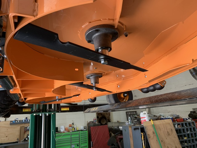

Well you told us how you do it but from the looks of the deck the question is WHY YOU NEED TO DO IT? :unsure:
We had 5 new mowers delivered. I was just going over them before releasing them to the asses… I mean masses.
