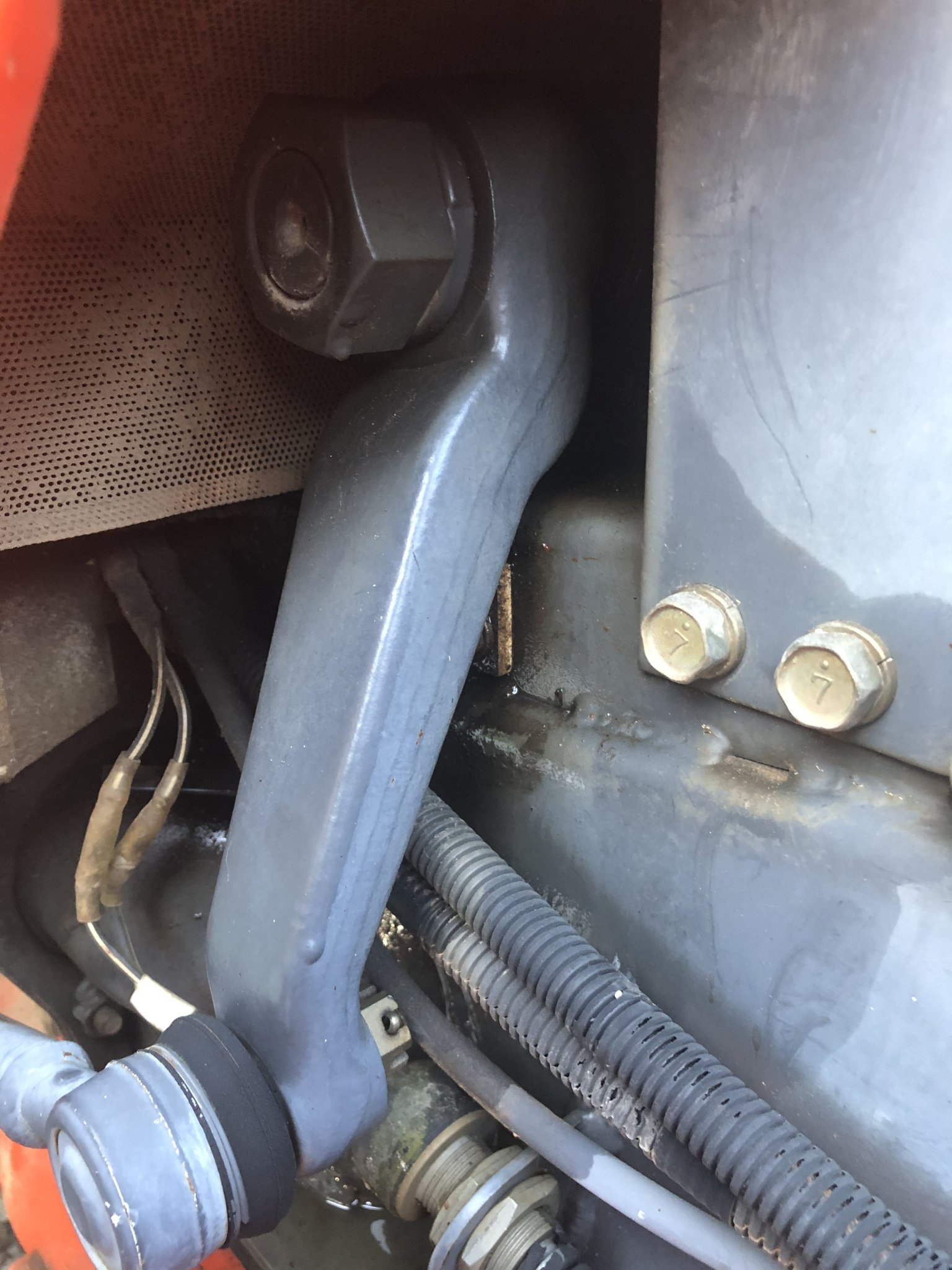

Anyway it's a B2150. The seal on the steering arm is leaking is this a hard fix? it is power steering.Do I simply remove the steering arm and replace the seal or do you have to dig in to it deeper?
I have chased a lot of seals on thing yes its old, I was wondering how difficult this one was going to be? After downloading a PDF of the repair manual it looks like the Sector shaft can be removed without pulling the steering column assembly??? Photos are really bad in the PDF that I paid to download 😞

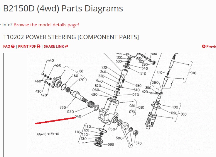

I answered a similar question from another B series owner.
The outer seal is only keeping water and dirt out of the box not the fluid in.
Gasket #40 which is not a simple thing as the word gasket would suggest and costing $20 is the part to replace.
I suggested to the previous owner to try and just remove the sector shaft. He reported back that there was not room and he removed the complete box.

The part number 040 gasket has been discontinued???
Jones Farm Supply has 2 on the shelf... took about a minute to find. The other big 2 (Messicks and Coleman) say 5-10 & 3-5 days out.
You will need to think outside the box if it truly is out of production, there is always a substitute to be had.
As far as this comment, this seal ("gasket") is a glorified hydraulic cylinder rod seal which goes inside the gland. I'm sure it could be matched up at a good hydraulic shop.

Study the attached part of the WSM closely.
Pay particular attention to page S7-27 regarding the orientation of the two sector shaft seals. The internal one needs to face inwards and the outer dust one faces outwards.
This internal seal is the one labelled as a gasket in the Messicks parts illustration.
True... it almost looks like you're installing the outer dust seal backwards, but it's correct with the lip outward. (Thanks Dave)
Why they call the inner seal an oil seal in the WSM, and a gasket in the parts diagram is beyond me.:unsure:
