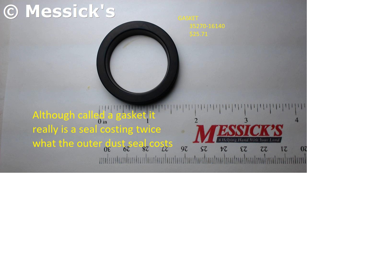

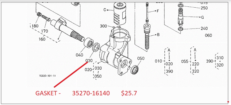

Your story has a familiar ring to it.........
From memory, it was preciously pointed out that the outer pitman arm seal was not for keeping oil from leaking out but to keep water/dirt from getting in.
The real oil seal was one called a gasket #30 but really a special rubber seal deeper in the case.
I cannot guarantee this part will solve your problem but it gives you some hope for a modest cost.
Dave

thanks Dave, I did see that diagram before but never thought seal. I didnt have to pull the box to do the outside dust seal, but I'll need to remove it now anyway. i'll try to get as many of those seals from the diagram as possible since the box will be out of the tractor. will let you know! thanks again!

update to all! finally got around to tackling this gearbox, 1st attempt at doing it on the tractor proved impossible so I went ahead & took it off. I first read my shop manual & checked the gear back lash at the pitman arm, ( thank God )cause when I turned in the adjustment screw to remove the cap on backside of the sector shaft I lost count of the turns (it sounds easy to just mark & count turns, but I fouled it up) Anyhow, once I got the sector out it was all straight forward then I replaced the "gasket" internal seal, the cap O ring & dust seal at pitman arm side then reassembled the box. reset my backlash & reinstalled gearbox on the tractor, No more leak, I want to thank all who responded & commented on this post, so THANKS guys! sometimes its good to challenge our skills & try something we dont think we can tackle, I can only imagine the money I saved doing this myself.
