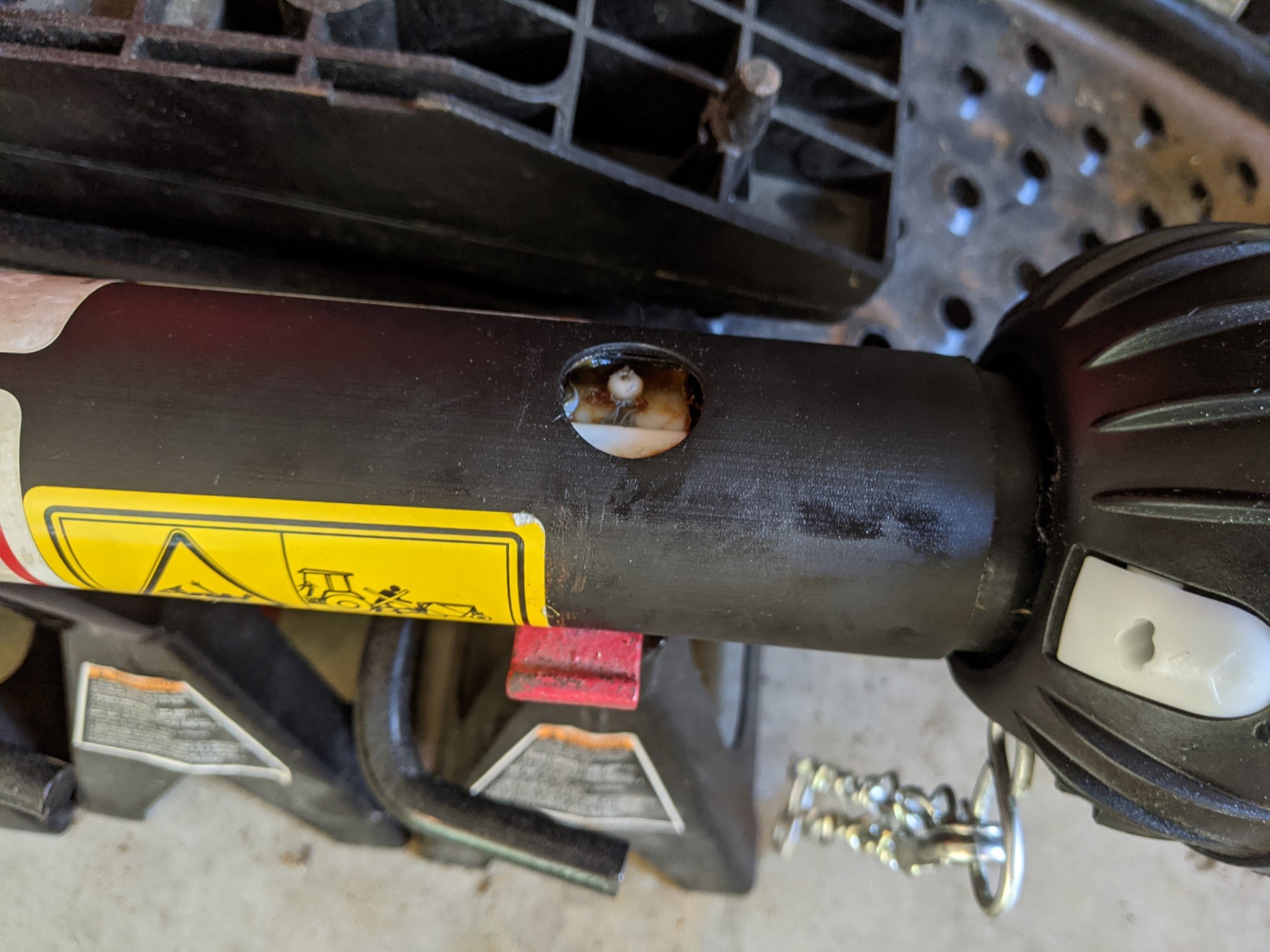

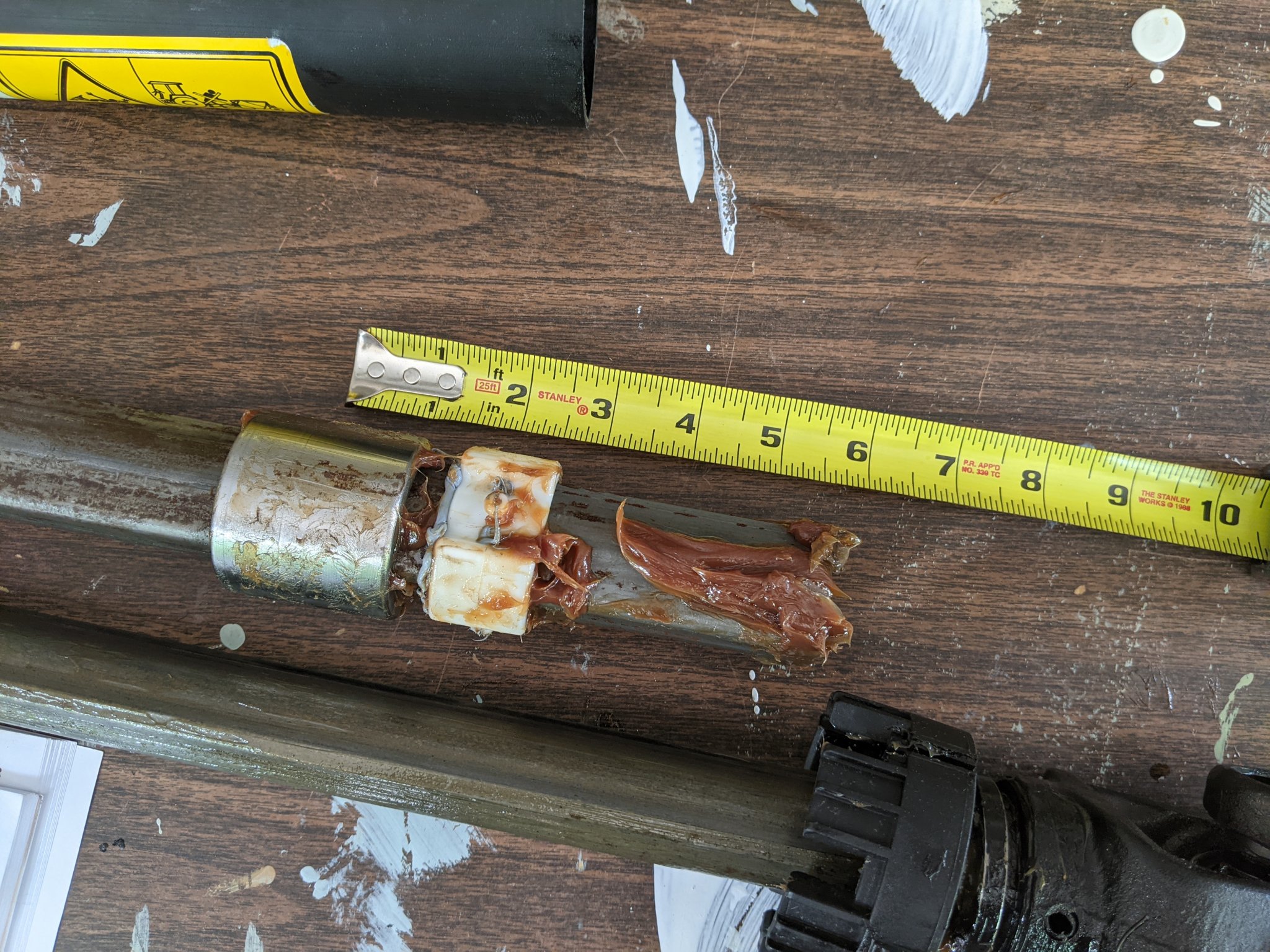

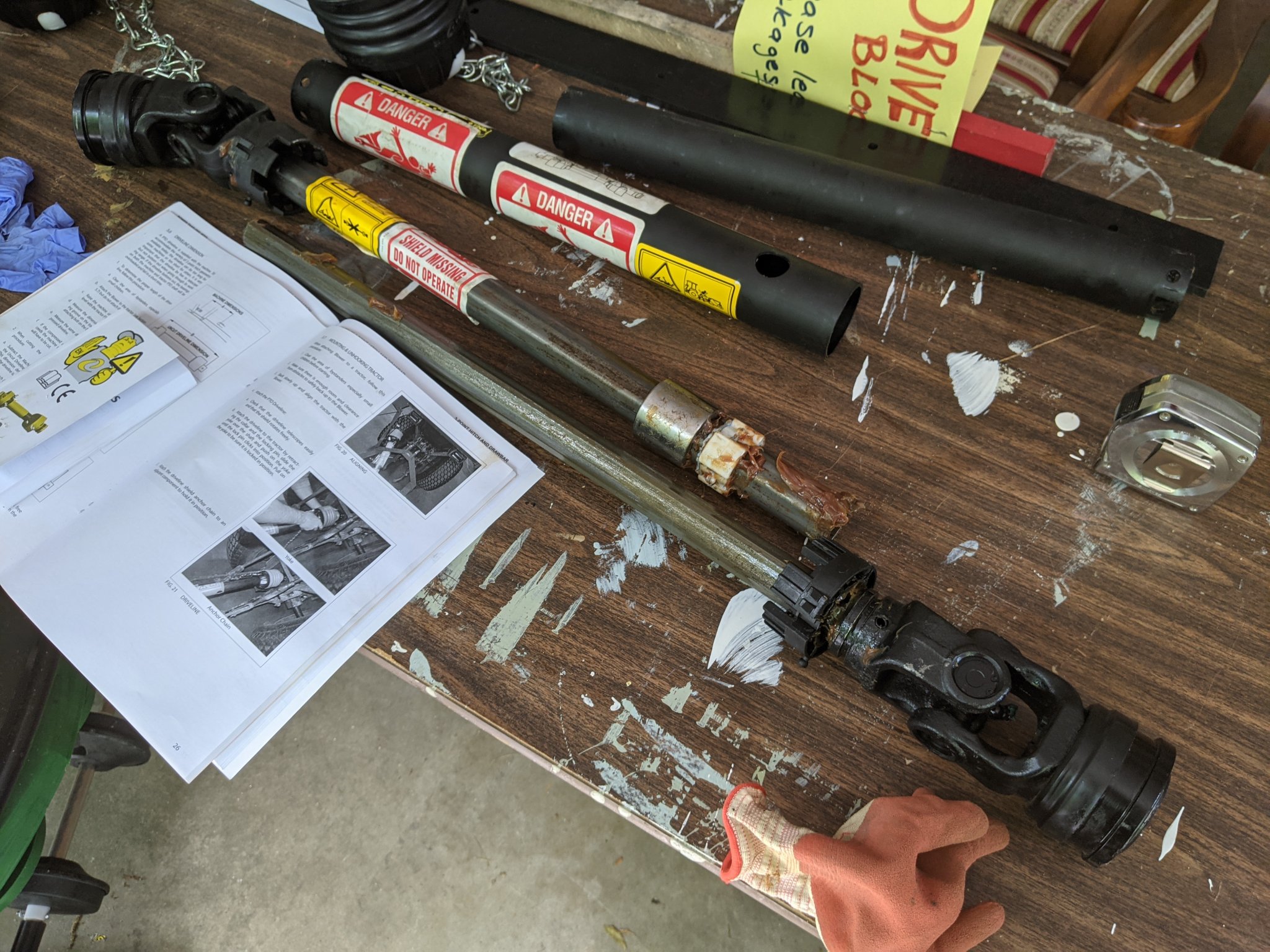

Hi everyone, could use some help as it relates to this implement and shortening the PTO shaft. I purchased the BW 1600 through Everything Attachments for my BX2380 a few weeks ago. Everything looks great but I'm having trouble with cutting the shaft. Similar to @B737, I measured it up and found I need to take 5.5 to 6" off. Trouble is, the PTO shaft that came with mine has a metal and plastic collar on one side of the shaft that seem immovable. The plastic piece in particular has some grey stuff that seems to be some kind of bonding agent. Pictures below. They're only about 3" from the end so I'd be unable to remove enough material. No video or forum I look at mentions this. The PTO in the video that @B737 linked also doesn't have this feature. Any suggestions? Did I get sent the wrong shaft or am I just missing something? Thanks!
Congrats on your new purchase!! You'll love it once you get it set up and running. Regarding pto shaft: I've never seen those parts on a shaft before. Are they something to keep the plastic shield centered around the telescoping tubes, perhaps? I'd try slipping something over the end of that tube and up against the white "ring" and give it a whack maybe? You'd think both those pieces should be able to slide up the pto shaft to accommodate a change in length. Were there no instructions in the booklet that usually accompanies the pto shaft?
David
That's what I was starting to think. It fits pretty snug against the inner shaft plastic shield. Weird part is I noticed when I slid the shafts back together there is a window open to the plastic piece on both if the shaft is fully compressed. Pic attached. Not sure why they'd leave a hole open like this for debris to get in but it almost seems like a service position to grease the shaft.
The PTO shaft did come with an instruction booklet; I flipped through the whole thing and didn't find anything talking about those pieces.
I suppose if I cut it off it won't be a huge deal since I've never seen one on another shaft. Besides, if I take off the 5.5 inches there will still be some of the metal collar left. If I de-burr it it should be alright. I'll try what you said first though and give them a whack, see if I can get them to slide up the shaft with something other than my hands.

My PTO shaft did not come with that bushing, I think bird is correct that it appears to be something to keep the shaft shield centered. I could see that being useful on a long shaft like a brush hog but on your BX the BW1600 shaft will be pretty short and manageable.

Will be interested to see what you find out about your pto shaft. Strange there was no mention of those pieces in the info pamphlet or owners manual. I agree with B737, that you could just cut that stuff off it can't simply be moved farther up the tube.
