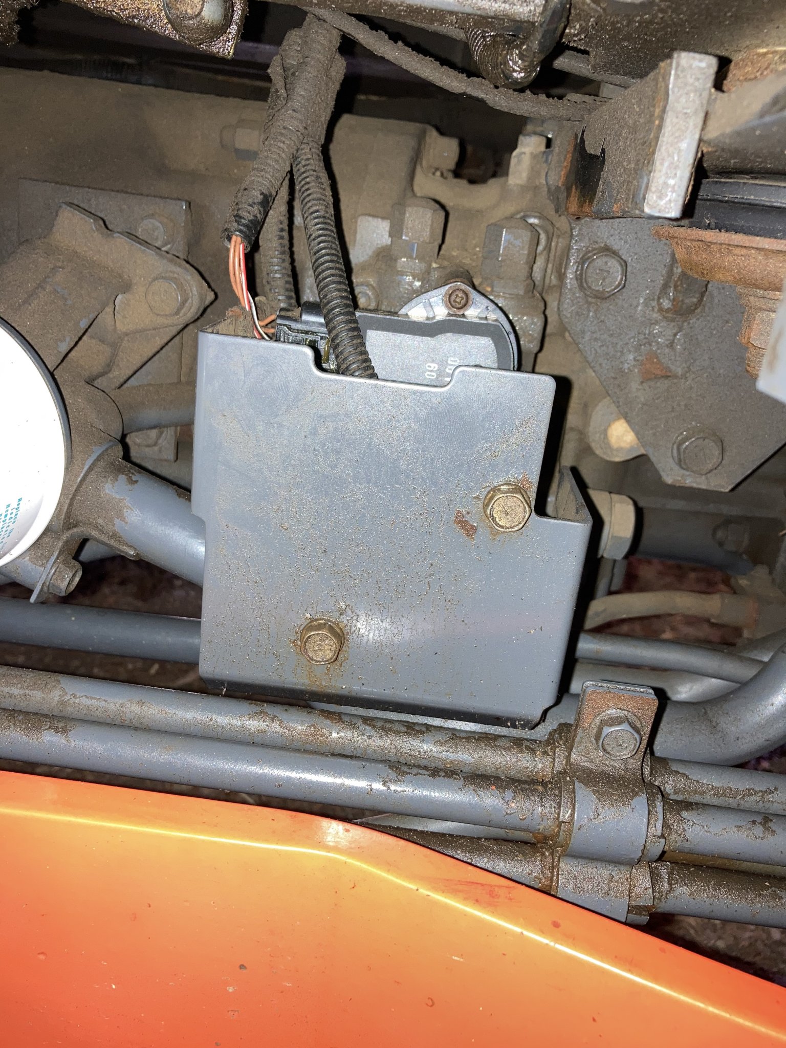

It ended up being the 2 proportioning valves, under the cab directly below the pedal. They were rusting within the coil end of the valve, and sticking real bad.

I have a couple pics to share, part#, and location of the proportioning valves is behind the guard beside the filter directly below hydrostatic pedal.
