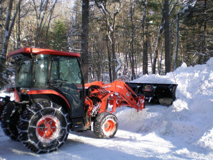

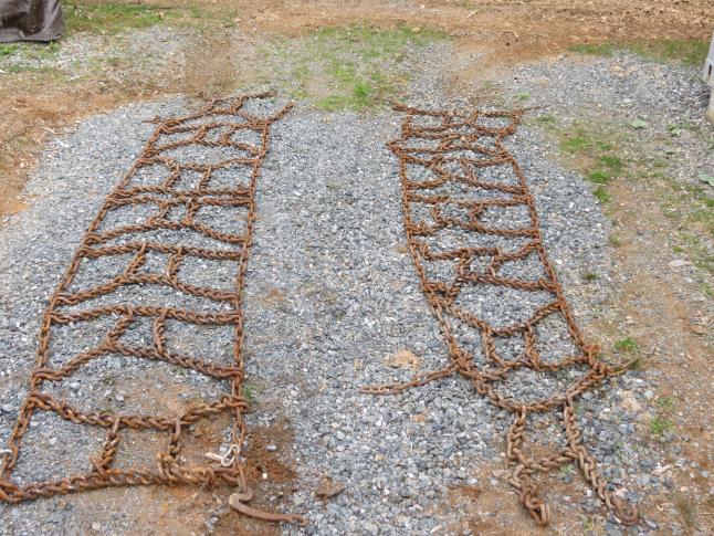

I found chains good using R4 tires however with R1's I found studding the front tires worked great.The problem I had at least with the kind of chains I have is in the wet snow it would form like soft balls between the chains making it almost impossible to drive with them on. Here's a picture of the chains. The studs I used are Kold Kutter atv ice screws, 5/8" bought off ebay. Good luck and Merry Christmas.

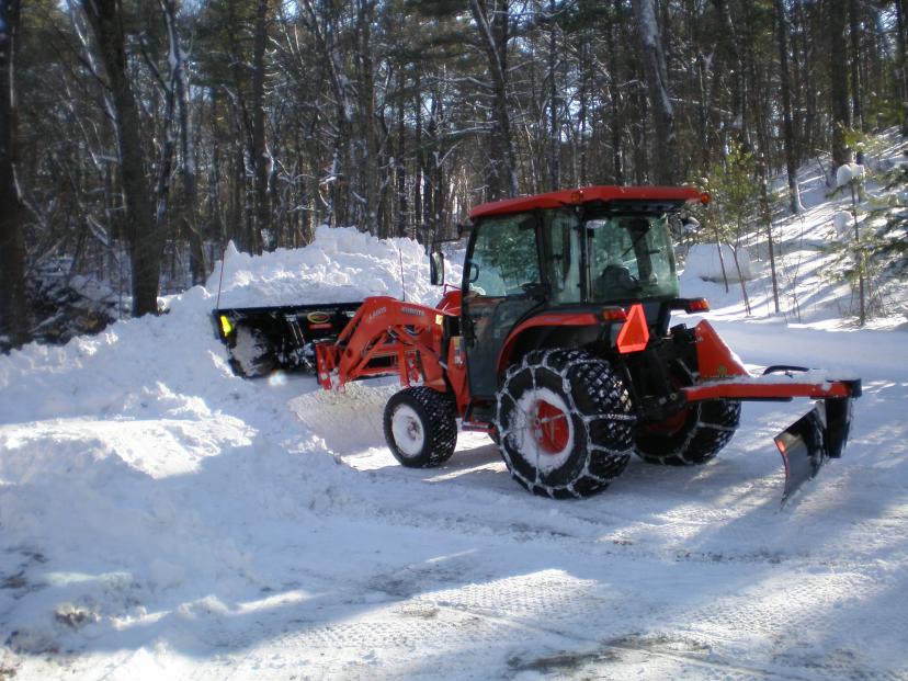

I wish I could post a picture of my set-up, but I have a new computer and haven't put the pictures in it yet, but that said, I have a L3560HSTC with chains I purchased from TireChainsRequired.com. A friend of mine purchased some for his truck after I got mine for the tractor. They have good prices and a great selection. Doesn't cost anything to look, check it out.

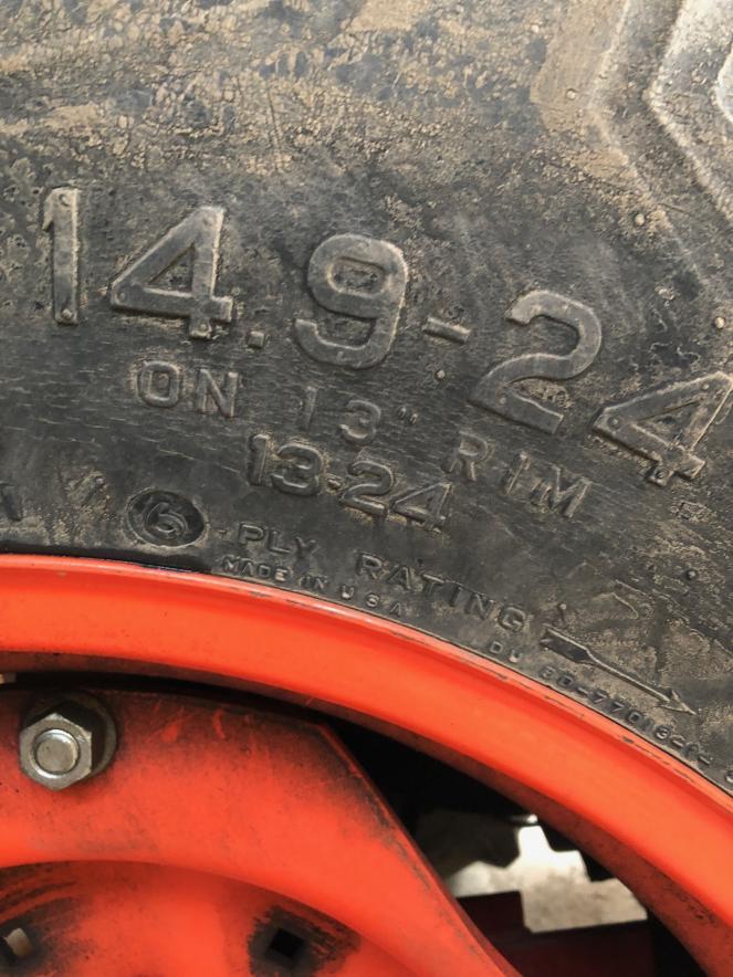

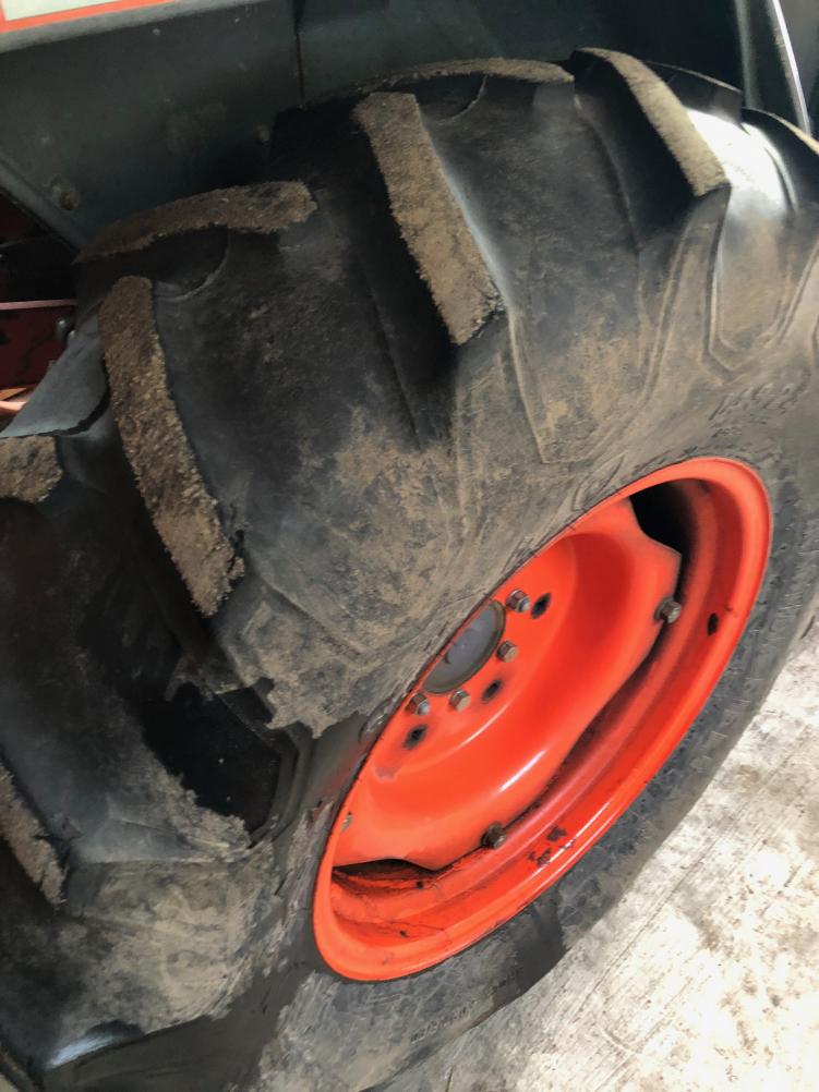

So the driveway is rock/gravel. No concern for damage. I apologize, but I don't know much about tractors or the tires on them. But I am including a few photos which will hopefully help.
