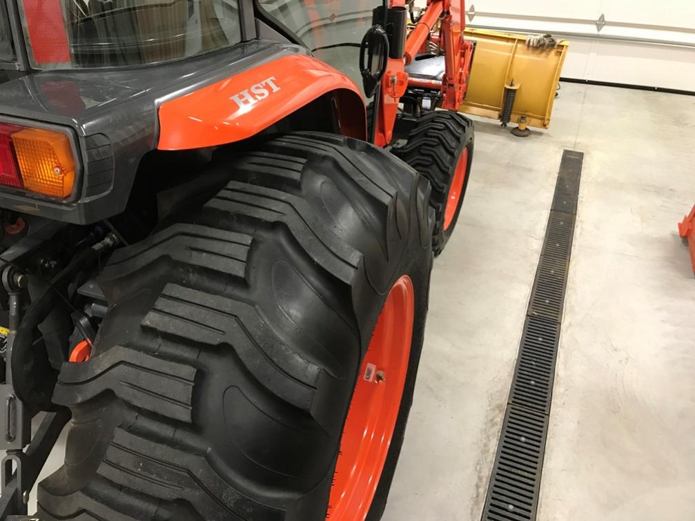

I have read accounts of different tire treads being either great or terrible in snow. I wonder how many people speak from personal experience, and how many just parrot what they've seen somewhere on the internet. I can speak from personal experience and show a couple pictures. Since 2002 this is the third tractor with R4's and no problems with no chains. For the past 10 years or so I've been using grooved R4's. For the first two years after we built I did have a 2WD tractor with the old diamond tread turfs that absolutely needed chains. The driveway was gravel, and there wasn't much there to damage. After paving, I wanted to avoid chains.
The first R4-shod tractor had unmodified tires. On the second one I grooved the tires and there was an improvement in traction in snow. One of the first things I did when we got the L4240 was grooving the tires. If I outlive the R4's on the L4240, I'd like to get a set of Nokians just because I think they're nifty:)

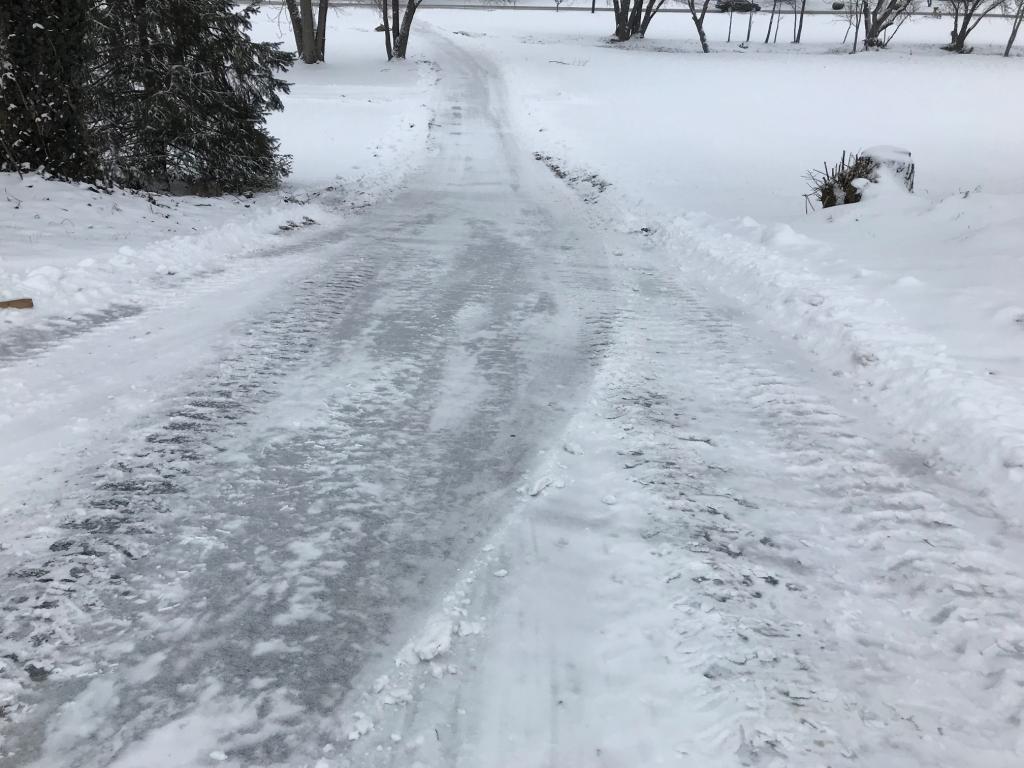

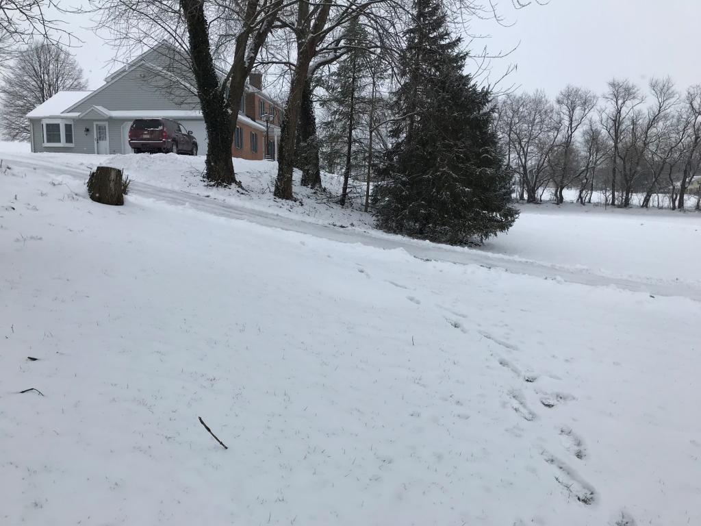

Here's my post from another thread from last year on another board. The tractor has an 8' Fisher bottom trip plow:
The grooved R4 tires on my L3200 have performed well in the several years since they've been done, but an experience today with the L4240 / grooved R4's was nothing short of amazing. I had made one pass down the driveway and turned around at the road to plow the other half coming back. Pushing snow, the tractor didn't quite make it all the way to the top of the hill.
It was only after clearing the snow as best I could that I realized the whole driveway was solid ice. The below pictures show the hill. There's an old tree stump off the side of the driveway in two pictures. The tractor made it that far before running out of traction. Wanting to experiment a bit, I tried plowing uphill a few more times but the tires kept breaking loose near the top. I made several trips just driving up and down the hill and it could easily make it up the hill with the blade raised. The hill is so icy I had to walk in the soft snow on the side to get the picture showing the side view.

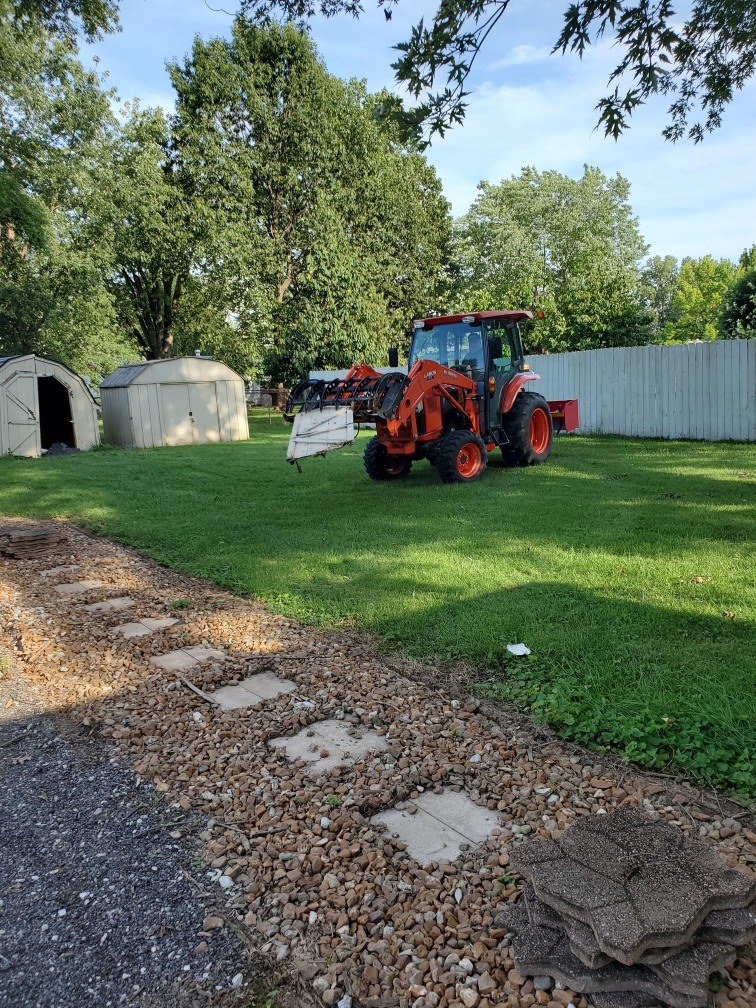

I'm not the OP, but I can talk about the L3560. It weighs about 1,00lbs more base weight (with the cab) than the L3901.
I think the are both close to the same PTO HP, around 30HP.
As far as tearing up the yard, mine has not. I have R4s and they are gentler than my dad's R1s on his tractor. Either tractor with R1s will tear things up. I don't know about the R14s. We have ran over the septic system for the last three years and not have had any issues, yet your mileage may vary.
As far as the HST+, that is a wonderful feature. I use it all the time. When I purchased the tractor, had no idea that it was one there or that I would ever use it (really thought it was a sales gimmick). Yet, I have found that it is a very nice feature and it would be one of those features that would make it hard for me to go to the MX series verses the Grand.
Add pictures of me running the tractor in my friend's yard tearing down his shed and you can see if didn't tear up his yard. I was hauling the material to dumpster about 50 yards from the shed.
