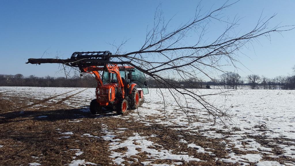

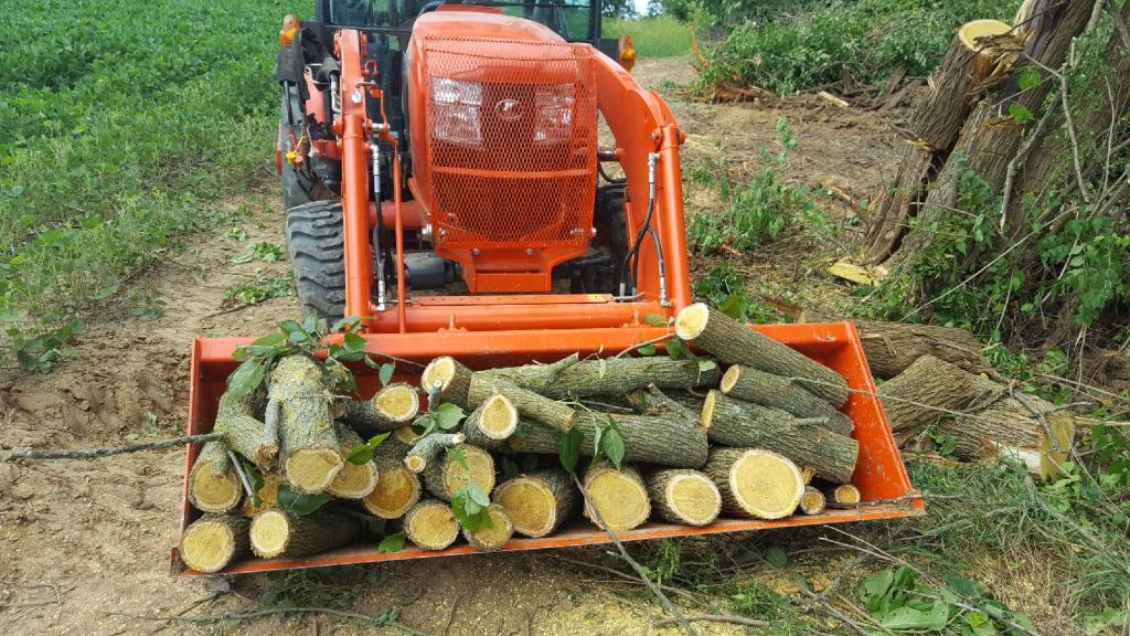

We have an 80 acre farm. 60 acres is shared crop out and we are working on maintaining the rest. The farm has continuously been farmed, but the maintenance of the grounds basically stopped in 2003. So starting last year, when dad officially inherited the farm (plus, my mom had passed and my grandma which both required around the clock care that my dad had been providing), we started working on clearing the farm. If you have the money, get the grapple sooner than later. I have been amazed at how much we have used the grapple.
Here are some pictures of the L3560 being put to work.
