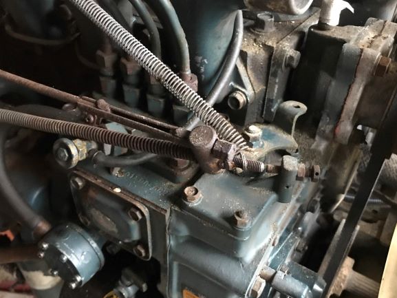

I have another question :D - I'm slowly working through all the issues on this tractor
It looks like the front end was removed at some stage, maybe to fix a water pump. There is this extra spring attached to the speed controller and whats looks like an extra home made welded rod to to stop the machine. I assumed the spring may have been replacing a governor spring which can be damaged if not removed (and judging by the careless nature some of the"characters" who have worked on this machine put things back together that would not be a surprise) and the new stop rod was a replacement for something that got broken. Looking at the operators manual my tractor has a pull straight back to stop type lever like the L355, not a pull up to stop lever. This may be because it has an after market cab. If someone could post what it should look like at the speed control plate, I can reverse engineer from there.

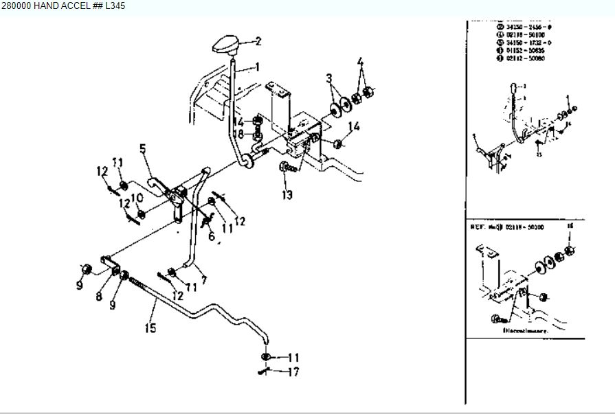

There's a picture here of the speed control plate 15221-27110.
No springs - pretty simple. The end of rod 15 above goes in the hole.
Hand throttle stays in position by friction.
34,342
9,579
In my picture 11 and 17 is where they attach to the speed control plate.
That model only has one control rod, not the two like yours. ;)

Ok, understand it now, was looking at the parts diagram wrong.
So basically the handle you pull up just pulls the rod back a bit further than the accelerator and cuts fuel supply to kill the engine.
My foot accelerator is a little different because of the floor of the cab, they seem to have tied it into this mechanism and added an extra engine stop rod.
Maybe I'll just leave my "hybrid" solution and remove the spring, see how it works and clean it up. Principle is the same but the spring is fighting the hand accelerator and it keeps dropping off rev's.

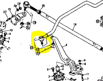

Hi all, on my L345DT the tie rod knuckle on the left hand side at the wheel end is heavily worn.
My tie rod is welded at both ends, as opposed to the drag link which has screw in adjustable ends, is this normal?
Kubota wants $300+ for a full tie rod, the end doesn't seem to be available as a part.
Anybody cut the end off and replaced it with an aftermarket part?
I could pick up a massey tie rod end for $20
14,632
7,100
I had a B8200 tractor I added power steering to and needed to adapt the tie rod. I took the tapered end to the local auto parts store and asked them to match it up. I then welded that to the existing rod. Absolutely no problems with it.

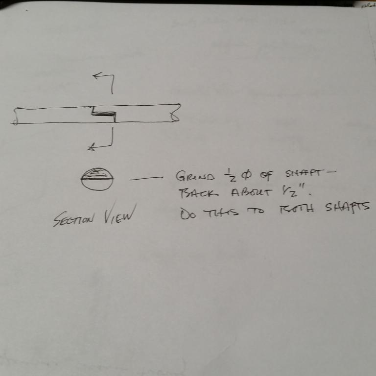

When welding a round rod here is a method that provides maximum strength.

Yep, that's what I was thinking, as long as the taper is the same it should work fine.
Thanks for the tip on welding, that looks a lot stronger than just a straight face to face weld
14,632
7,100
Biffog, if you have a parts house that your frequent it's probably your best bet. They'll take the time (ususlly) to measure and check some boxes of parts for a good fit.
The welding tip I got years ago from my F-I-L. He, his two brothers, and their dad were machinist and had their own shop. I learned more hanging out there then I could from school!
6,333
3,682
Another method is to slip a short piece of tubing over the joint as a sheath and weld the tubing to the rod. Best practice in this case is to “angle” the ends of the tubing in a “scarf” type joint, I.E., cut the ends of the tubing at a 45-degree angle rather than straight across so that the heat of welding isn’t circumferential like a “butt-splice” but is at at angle. Hope that makes sense.
