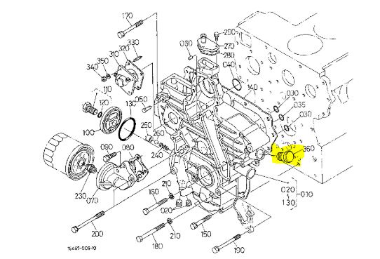

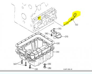

Yes, the diagrams I found show it to be on the same side as the alternator. (left side if sitting in the seat) Maybe mine lost the stick and the hole is difficult to see????
The rubber plug just under the alternator is what I would consider the fill point.

The Oil fill plug is in the gear case, the dipstick will be behind that a couple of inches in the block.

The rubber plug I mention is about 1" diameter. Directly under the alternator.

If it is that large I it would not be the dipstick- especially since NIW STATED it’s some fill plug.
The diameter of the dipstick is around a half inch where it plugs the tube

I was able to "visit" my tractors yesterday. I found the oil stick on the 3300. It was lower and in a dark spot with the loop lying over against the engine making it hard to see. It is identical to the one shown in the image in post # 5 above.
