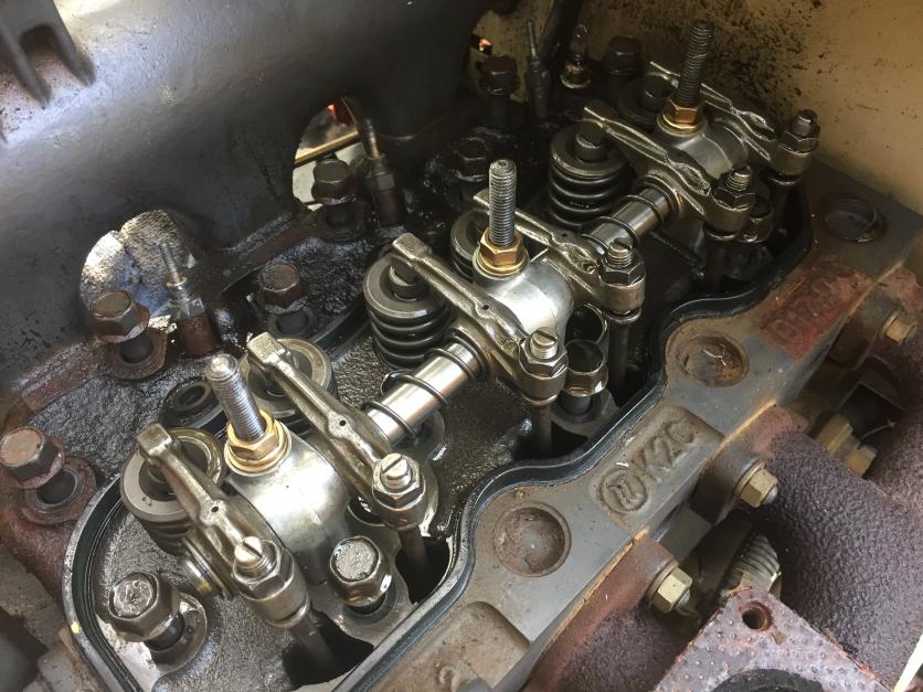

Began process of removing head. I loosened all the 14mm bolts IMG_0434[1].jpg
What is next logical step of push rod removal/sequence?
Ordered shop manual from dealer as I am obviously out of my comfort zone.

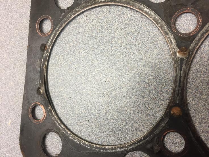

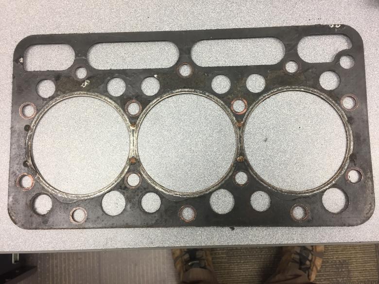

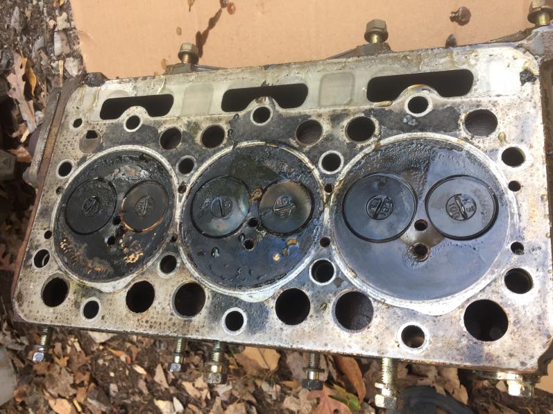

Pulled head, and noticed irregular hole in upper left corner in pic?
Head gasket issue near left edge of piston cylinder, maybe related to "problem" hole in head.
No visible cracks in head or block.
Is this just a simple replace head gasket or is the non machined hole a problem?
8,086
3,181
Looks like that hole should be there and should be round like the others?
Head gasket apparently has a matching hole. Please put head gasket on head in the same manner as it was and take a picture.
It may help the more knowledgeable people help you
36,730
11,449
It's common for the heads on these to have that casting left in, doesn't effect it.
Looks to me (but head is very dirty) like I can see 2 possible cracks and the head gasket looks blown from a possible warped head.
The crack will be in the space between the valves and possibly going to the pre chamber.

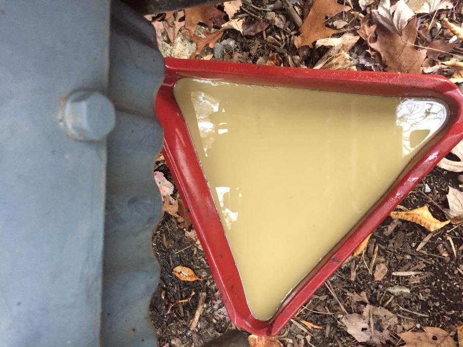

Started up fine and let run for 30 minutes. Changed oil and oil filter twice and still seeing chocolate milk out of my oil pan. I have not checked anti freeze level yet(got dark and cold/no garage on Poor Mtn)but guessin' this ain't good!! First pic after first oil change, second pic after second oil change.
100 td
B21TLB (B21, TL421 & BT751) Toyota SDK4 T116 Bobcat
Aug 29, 2015
1,776
9
38
ɹǝpunuʍop
If you were making soup it would look good, but soup is not what you want unfortunately................
