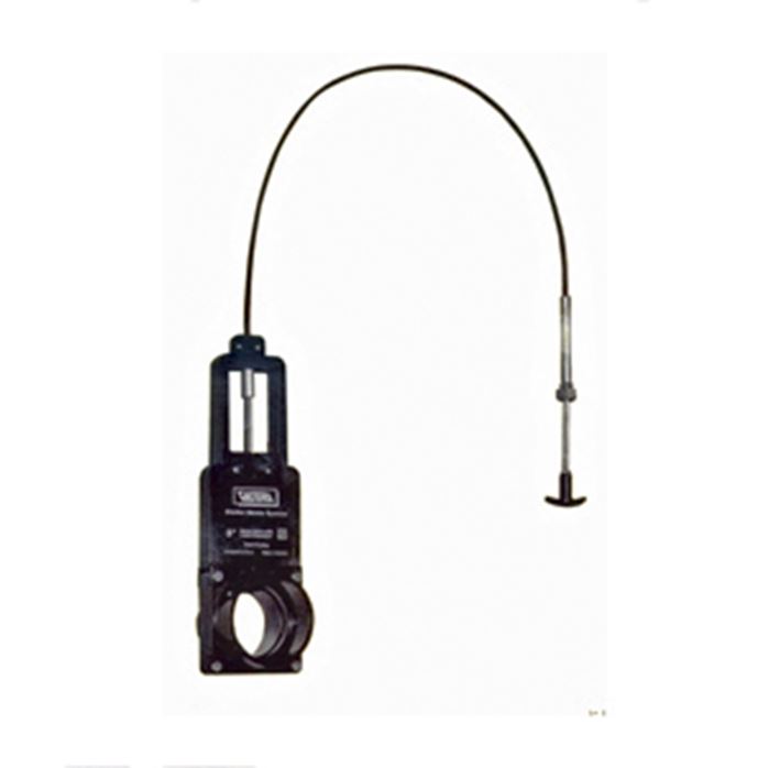

Some ingenuity I think you could do this yourself. My recommendation would be to fabricate in an RV sewer tank dump valve. A pull cable could actuate it easily. Here is what they look like. Not all come with cables like below. I think the normal pipe size for these is 3"
That is an interesting thought. I'd worry about the heat, and you'd have to swap the cable to the opposite side so it worked on the pull, not the push. The general design is sound though.
I know my RV gates get a little tough to open so I have to keep the rods lubed with silicone!

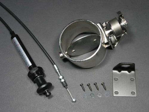

This is what I was picturing in my head. It's an exhaust control valve but could easily be on the intake. It's a bit pricey but would be cheaper if mass manufactured across all diesels.
http://www.ebay.com/itm/APEXI-EXHAUST-CONTROL-VALVE-ECV-PIPE-TYPE-54MM-/280748598756
