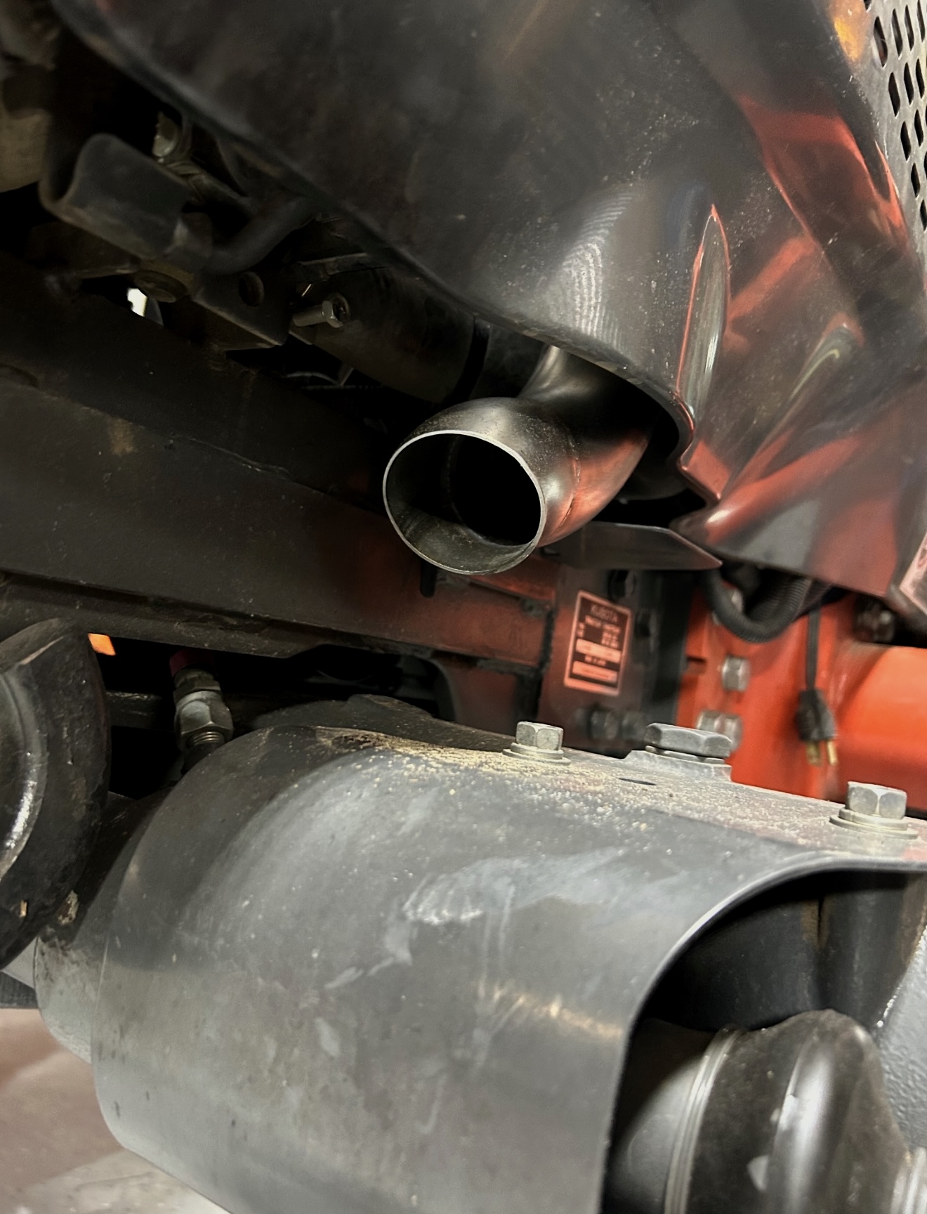

Thank you for the pictures Rodd! (y)
It's nice to see what it's going to look like once I finally get it installed. The fit of those updated pipes look so... professional! They look like they belong on a show car. LOL
I received mine in time for Christmas. It was my Christmas present to myself. LOL
I'm impressed and envious that you got yours installed shortly after receiving it.

You’re welcome, glad to share them! I had a heated garage to work in so it was a joy to install. Everything fit together so well; it was a breeze! It took me longer to hook up the gauges than it did to install the turbo kit. I think you will be impressed with the performance, as I am. Best wishes!
