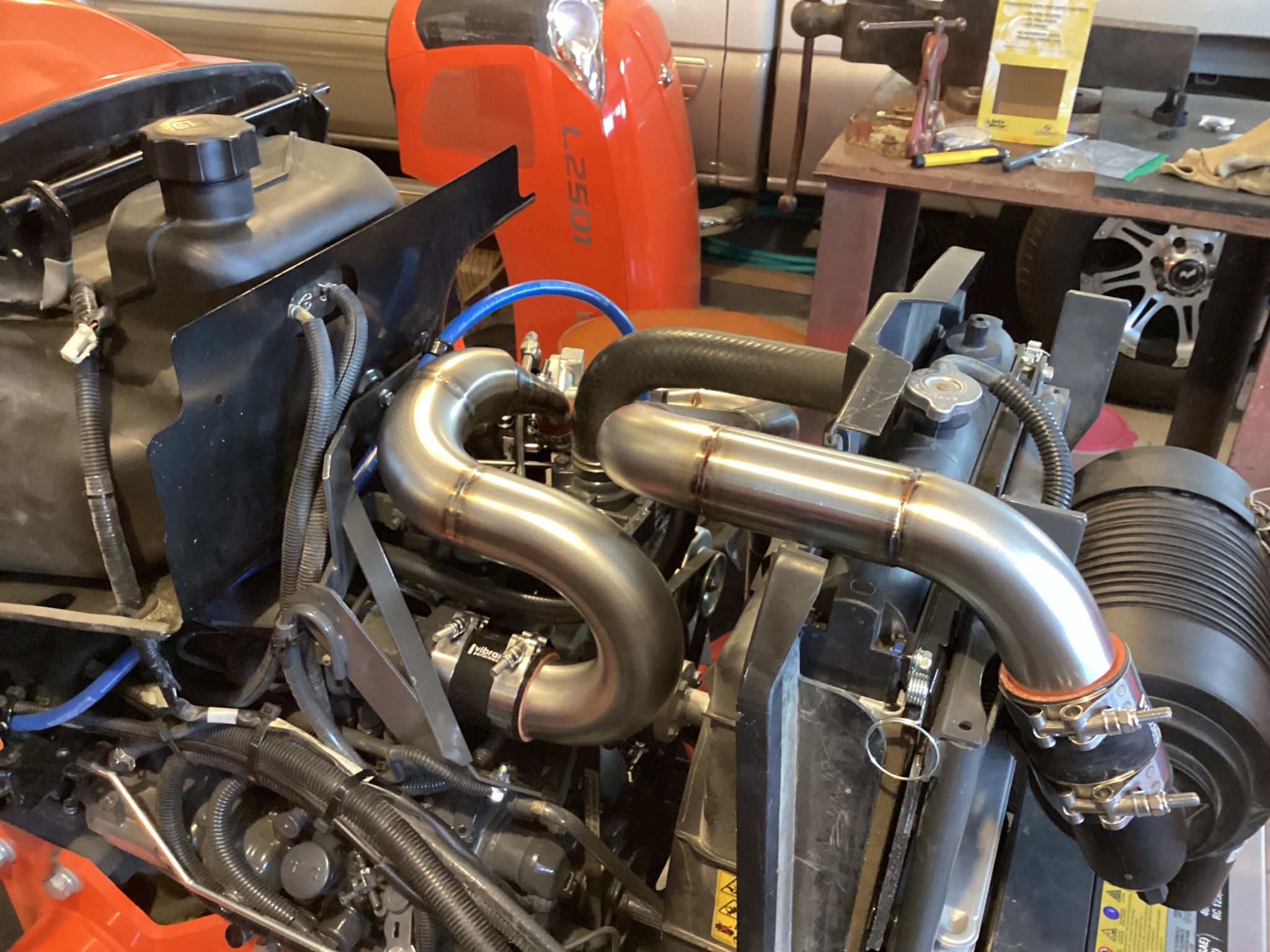

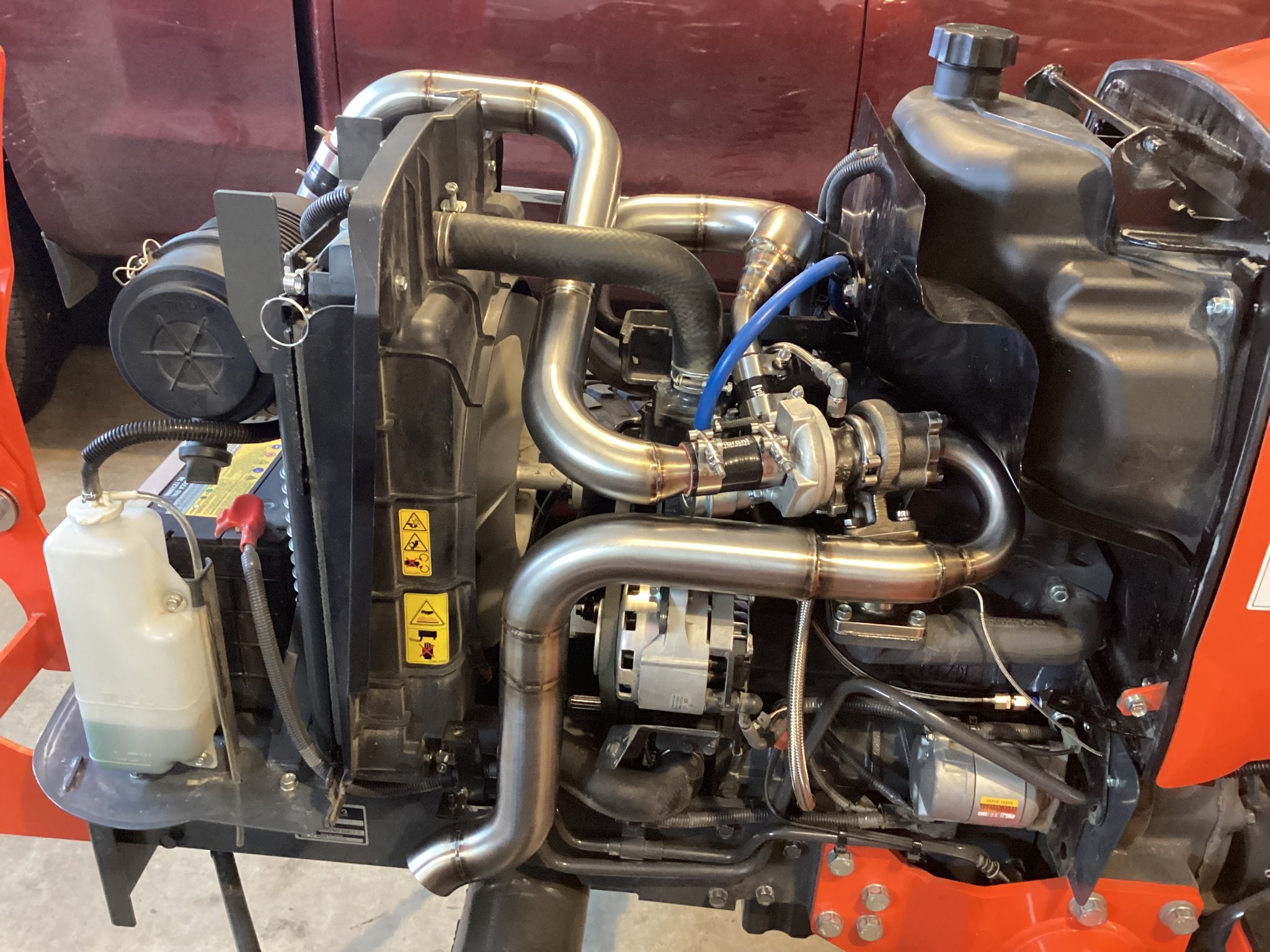

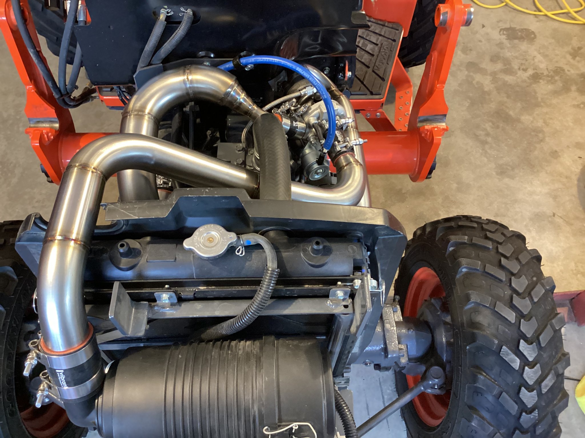

Hi Mike!
I did turn the fuel out 1 full turn. I pushed into an immovable pile and fully loaded the engine. It showed 7 psi of boost and the EGT got up to about 1,100 degrees. I plowed snow yesterday and there is a very noticeable performance difference, as well as a lot less smoke. While I was plowing, the highest EGT I saw was about 900 degrees and about 5 psi boost. It’s really a fun machine to run and the S2T turbo kit is one of the best purchases I’ve ever made. Thank you so much!!

Thank you! It’s eye candy 😎
Thank you for the pictures Rodd! (y)
It's nice to see what it's going to look like once I finally get it installed. The fit of those updated pipes look so... professional! They look like they belong on a show car. LOL
I received mine in time for Christmas. It was my Christmas present to myself. LOL
I'm impressed and envious that you got yours installed shortly after receiving it.
Personally, I've been procrastinating. The weather doesn't help. First it rained for a month, now it's freezing. I envision turning the farm into a mud pit with my new turbo tractor. LOL
(Ha - Mud races, hmmm...) LOL :devilish:
In the meantime, I'm watching the loads of chipper shavings pile up for next year's garden paths. I'll have to get my old carcass in gear here pretty soon. Now that I've posted, maybe that will provide some motivation.
I can't wait to see how this new turbo does - brush hogging that 4ft grass in the back field.
If I had more money, I'd do a before and after dyno. I'm not all that far from where they are made. My local dealer has a dyno getting all lonely in the corner under a tarp. He pointed out to me when I bought my tractor.
I'm really looking forward to it. :)

Hi Mike!
I did turn the fuel out 1 full turn. I pushed into an immovable pile and fully loaded the engine. It showed 7 psi of boost and the EGT got up to about 1,100 degrees. I plowed snow yesterday and there is a very noticeable performance difference, as well as a lot less smoke. While I was plowing, the highest EGT I saw was about 900 degrees and about 5 psi boost. It’s really a fun machine to run and one of the best purchases I’ve ever made. Thank you so much!!
Very good. Excellent!
Thank you for sharing your fuel settings and tractor performance.
Wow! That’s the best feedback we can get!
You’re very welcome! We’re happy we’re able to offer this setup to the community.
Mike
We’re looking forward to installation and feedback too!
