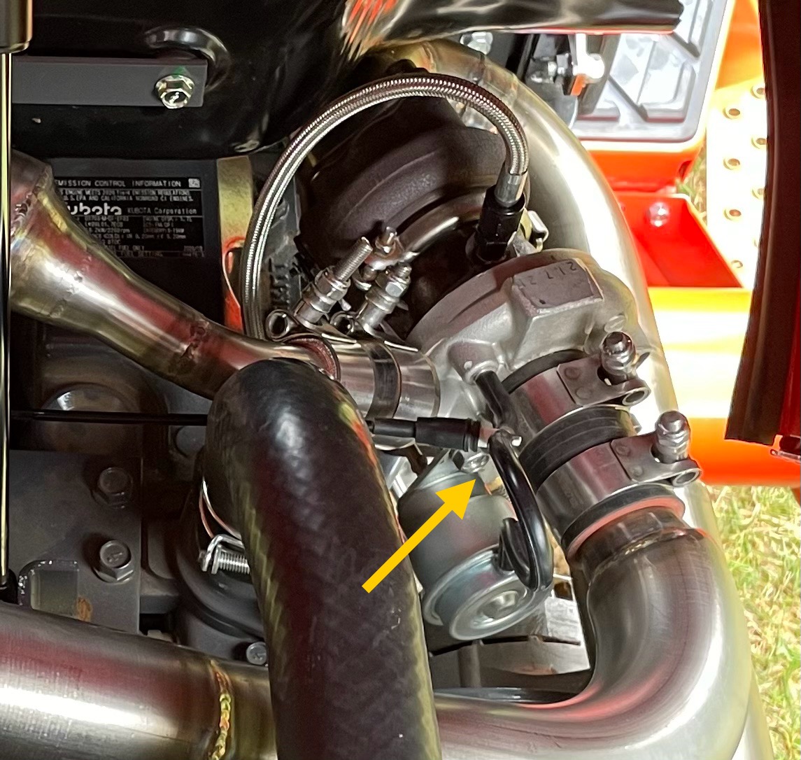

I recommend adding a vacuum “T” fitting between the Turbo compressor housing and boost actuator.
Edit: We do include a vacuum T fitting (hose and hardware) if the optional gauge kit is selected. However, we are still lacking installation instructions for this option. :(
I need to get this done :D

Thank you for the info! What’s the hose size, or what size T-fitting do I need?
Rdrcr
Vendor Member
May 7, 2021
738
888
WA
You’re welcome!
3/16” for fitting and hose.

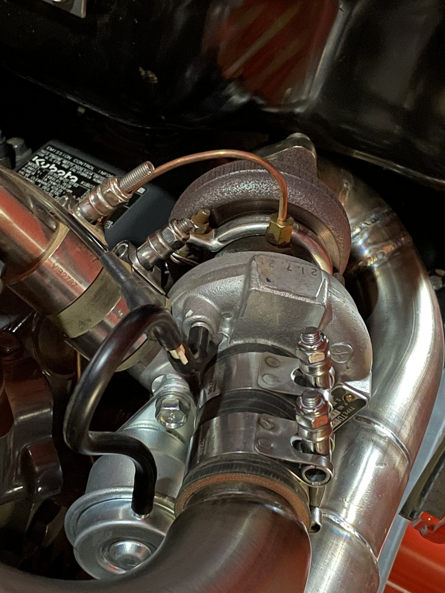

Before; View attachment 93880
After (new T-clamps);
Swapping the hose clamps was solely done for aesthetics. Obviously, this small modification wasn’t necessary. The old hose clamps work just as well as the new T-clamps. I just like things to match and look ‘clean’.
