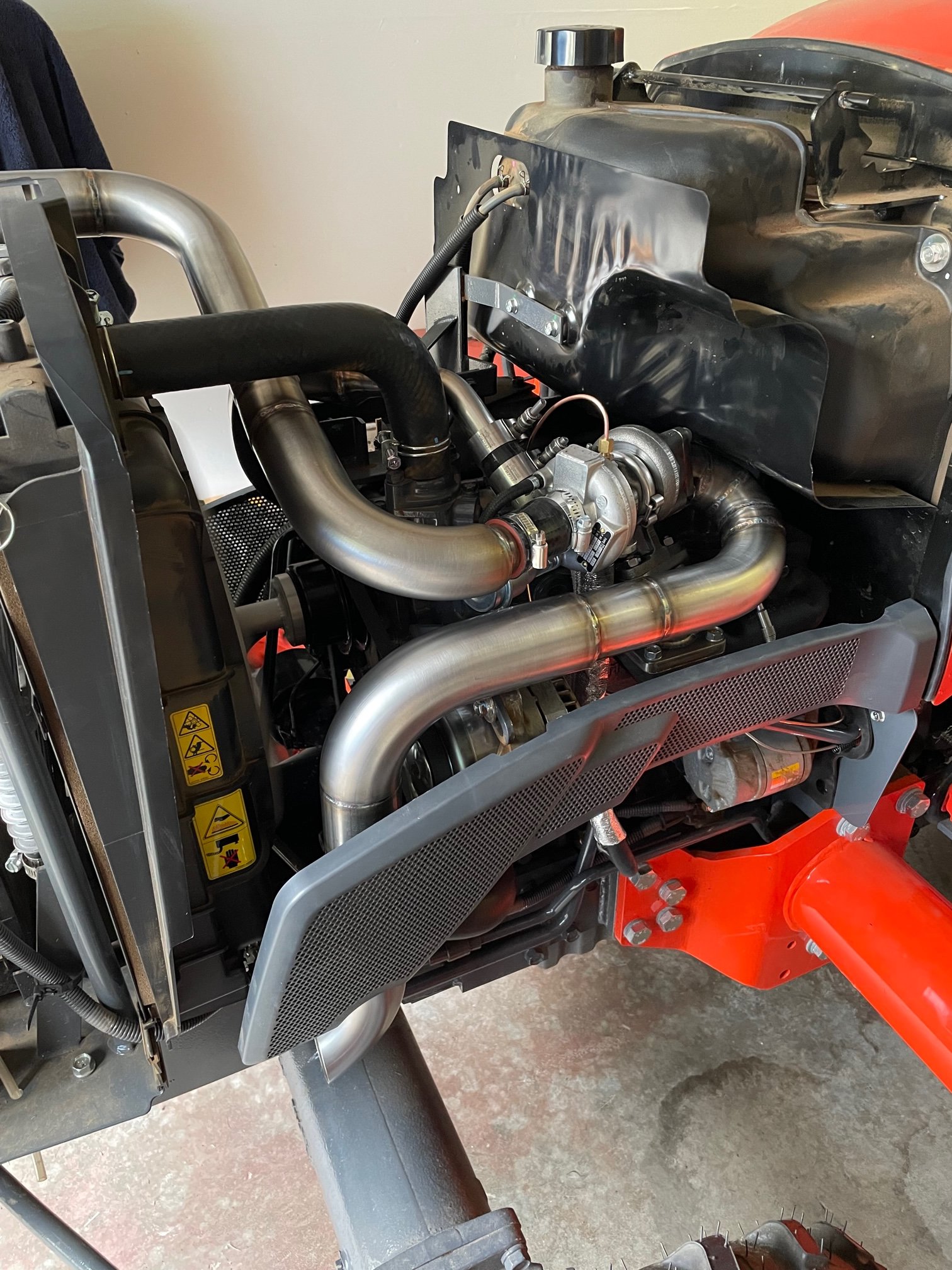

Part 3: Turbo design, fabrication, installation and testing
My Turbo build begins on the heels of a couple very successful turbo setups already running on L2501 tractors. These particular Turbo setups encouraged me to begin the planning and research necessary to create my own Turbo system.
My goal is to design, fabricate, develop and install a turbocharger system that performs flawlessly on a completely stock L2501 tractor. My Turbo system will be designed as a straightforward bolt-on affair that can be installed with simple hand tools and basic mechanical knowledge. It’ll operate within the factory RPM range and at the optimal PTO RPM. It’ll enhance the performance of the L2501 without any further modifications.
It’ll be the ultimate L2501 attachment!
To achieve these lofty goals I’ve commissioned the help of a very good friend. He will be lending a hand and has a long list of automotive accolades and accomplishments in land-speed and custom Hot rod building. He is a former Indy car and V8 Supercar mechanic, engineer and fabricator. His assistance is needed as I simply do not poses the welding and fabrication skills required to bring this project to fruition. Having his assistance with this endeavor is a real privilege. I’m fully confident that together we will build an amazing Turbo system. Moving on.
With any small displacement engine, Turbo size is crucial, but with the L2501, it’s even more critical. Why? Because the L2501’s engine (D1703-M-DI-E4B) operates at such low RPM (2,400 maximum, 2,105 PTO). After speaking with several industry experts familiar with the L2501’s engine and it’s operating capacity, the collective minds decided on a brand new Mitsubishi MHI TD025 Turbocharger as the best option. It’s literally, the smallest Turbo I’ve ever seen.
This tiny Turbo is somewhat undersized for the D1703’s 1.647L displacement and was originally designed for use on Kubota’s D1503 1.5L. This Turbo was chosen, however, because it’ll perform perfectly amidst the L2501’s low RPM operating environment. And don’t worry, this miniature Turbo can support up to 90 HP. Yeah. I think we’re good! With the Turbo decision behind us, I began looking at other components.
As with any project, quality materials are essential to success so I decided on using only high quality 316 and 304L stainless steel for all plate, tubing, clamps and adapters to ensure longevity and match the quality, reputation and reliability of the Mitsubishi MHI TD025 Turbo. Quite frankly, it wouldn’t make any sense to do otherwise.

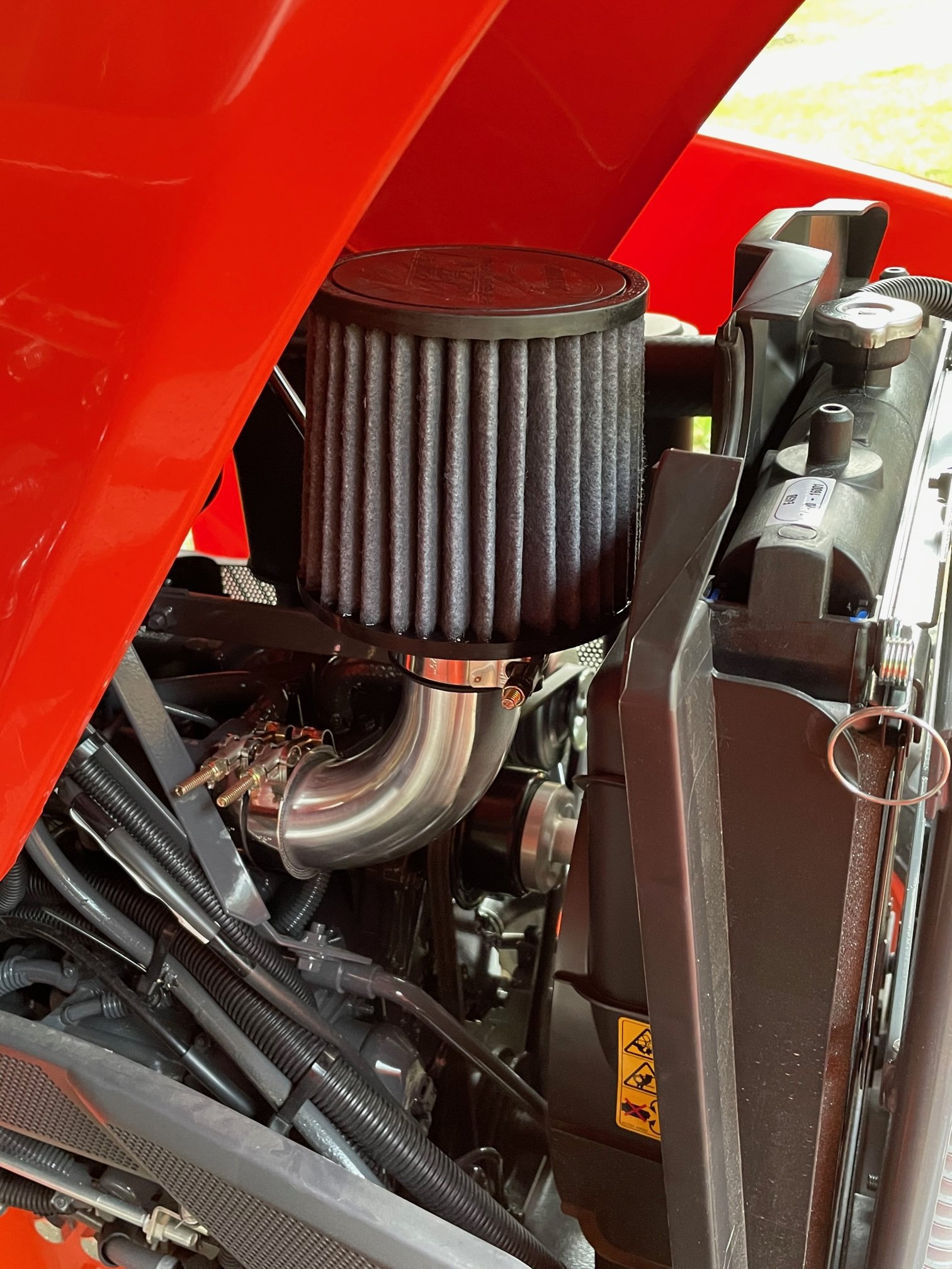

In the very early stages of my research I read that the factory L2501 intake and air cleaner assembly is highly restrictive. Upon learning this news, I figured I’d replace the factory intake and fabricate a high flow short-ram intake along with a performance aftermarket off-road air filter designed to handle the extreme dusty conditions encountered in Baja and Rally racing.
So I did.
As I’ve mentioned previously, my big hill is my L2501’s nemesis. The tractor doesn’t appreciate the challenge and always struggles to make it to the top carrying a load. The custom intake noticeably improved the tractors ability to climb the hill in (M) gear. The newfound ability wasn’t anything earth shattering, the tractor still struggled, but the RPM’s would only drop a few hundred RPM’s, instead of several hundred RPM’s.
There were some drawbacks, however. The engine and intake noise was noticeably louder with the custom intake. I never thought to measure the increased racket but, I can tell you it was a little uncomfortable operating the tractor without wearing ear protection. And with further testing, I found there were some issues with air filtration. After many hours of hard use in dusty conditions, I found evidence of very fine dirt film in the intake tube. It’s probably nothing to be alarmed by but, I never saw any sign of dirt particles, or film inside the stock intake system. So, I removed the short-Ram intake and reinstalled the OEM intake assembly and air cleaner for piece of mind.
Due to the questionable air filtration properties found with the aftermarket performance air filter and the general assumption that a tractor will be used in dusty conditions, I knew I wanted my Turbo system to utilize the OEM intake assembly and air filter, even if it costs some performance (I’ll get to that later). Naturally, it’s much better to have superior air filtration protection than the alternative.
Roaring ahead with my thoughtful planning and ideas, I began to list additional design requirements and features we would be providing with this Turbo system.
I want my Turbo system to maintain a stock unmodified appearance. Meaning, I want to make sure all factory body panels remain in place and the Turbocharger system, including all piping and tubing components fit snugly under the hood, no cutting, modifying, or debauchery required. Moving forward with this “stock appearance” theme I recognized the importance of keeping the exhaust in the factory location. This will help keep the exhaust fumes away from the operator while running the tractor. I’m sure we all agree, this is a keen resolution. We’ll make it happen!

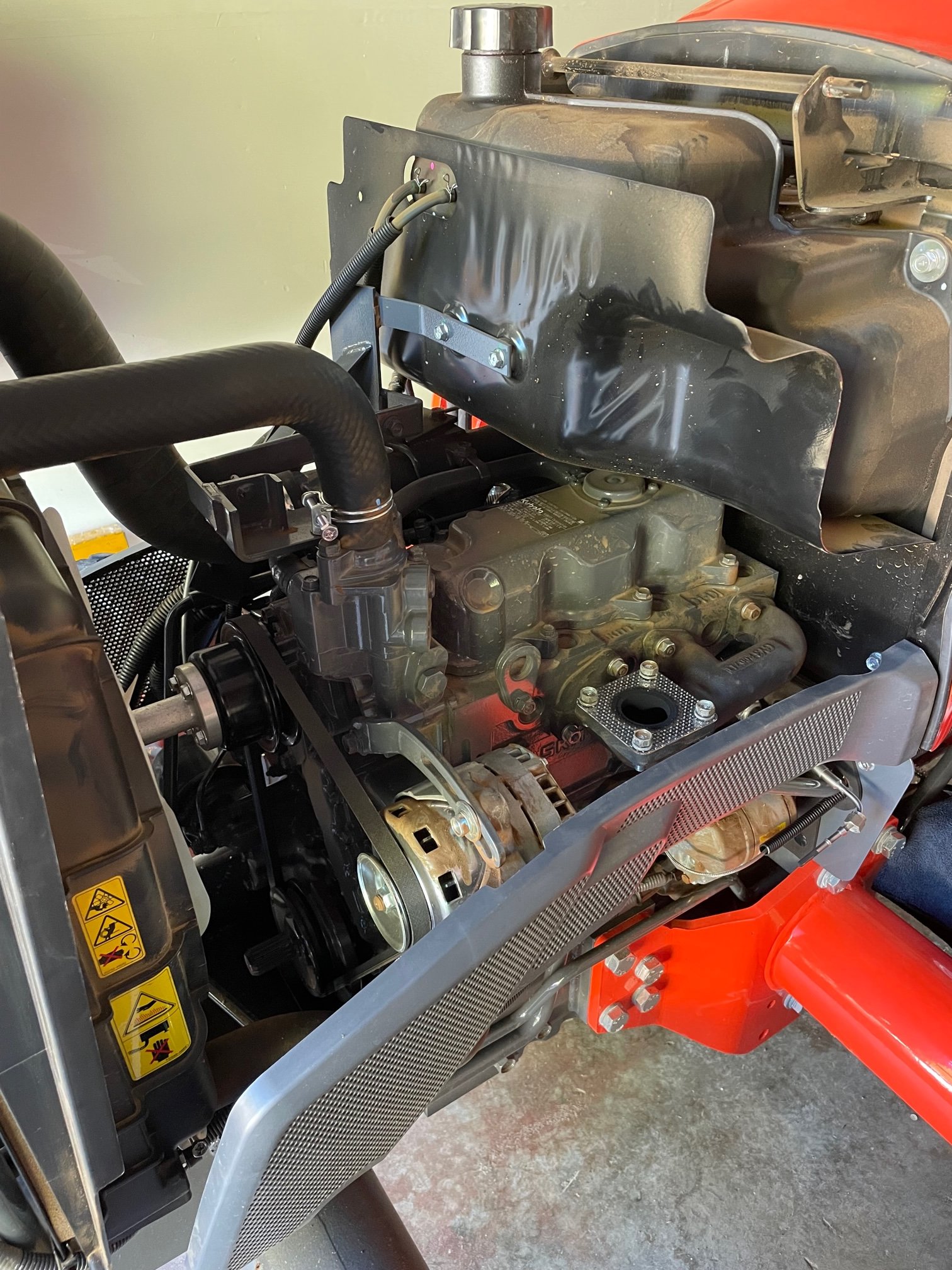

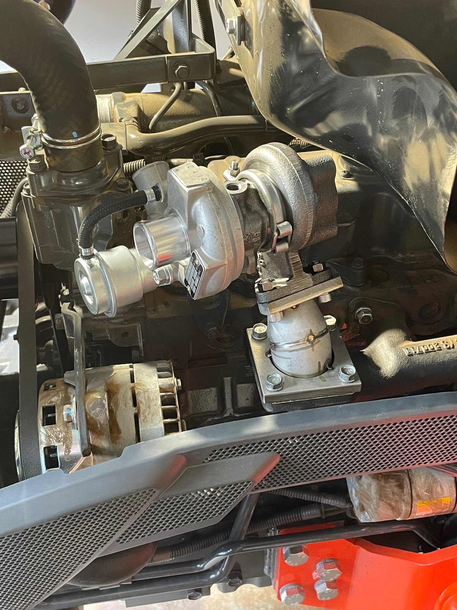

Next, we turned to mounting the Turbo on the L2501. I know, this topic sounds incredibly boring and ridiculously unnecessary but, it truly is an important consideration. The Mitsubishi MHI TD025 Turbocharger will not simply bolt on the L2501’s exhaust manifold. So, upon that hugely disappointing revelation, we had to decide to either fabricate a custom Turbo exhaust manifold, or make some type of an adapter to mount the Turbo to the factory exhaust manifold. An extravagant custom tubular Turbo exhaust manifold would be wildly awesome and incredibly impressive, but it would virtually double the cost of the Turbo system.
So, an adapter it is! Heavy sigh.
Most guys will simply make a “sandwich” adapter to mount the Turbo. It involves taking a piece of steel plate, drilling some holes, bolting it to the exhaust manifold and installing the Turbocharger on top. It’s cheap and effective. However, that’s not what we’re doing, we’re fabricating a proper adapter!
A mandatory requirement for my Turbo system is providing a provision for an EGT (exhaust gas temperature) probe, also called, a pyrometer. The pryometer will be used to monitor engine performance, engine health and fueling adjustments required for tuning purposes. The best location for the EGT probe is in the exhaust collector before the Turbocharger. This way, the probe can measure the temperature of all three cylinders together (not just a single cylinder) before the gases reach the Turbo. I realize this sounds easy but, it takes a lot of additional design, engineering and fabrication work to make a proper Turbo adapter. Fun! Not really.
Luckily though, the hard work will payoff as there are benefits if done correctly. For one, the Turbo inlet diameter and the exhaust manifold outlet diameter are rarely the same size. No surprise there. By installing a properly engineered adapter, we’re able to transition the tubing diameter gradually maximizing exhaust flow, improving velocity, resulting in faster Turbo response and spool characteristics, ultimately improving performance. Excellent!
Of course, all of these foolish ideas greatly effect the position and location of turbocharger which in turn, creates a ton more work. Wonderful! Not surprising, it took more time than planned but, we eventually got the adapter made and the Turbo properly positioned under the hood.

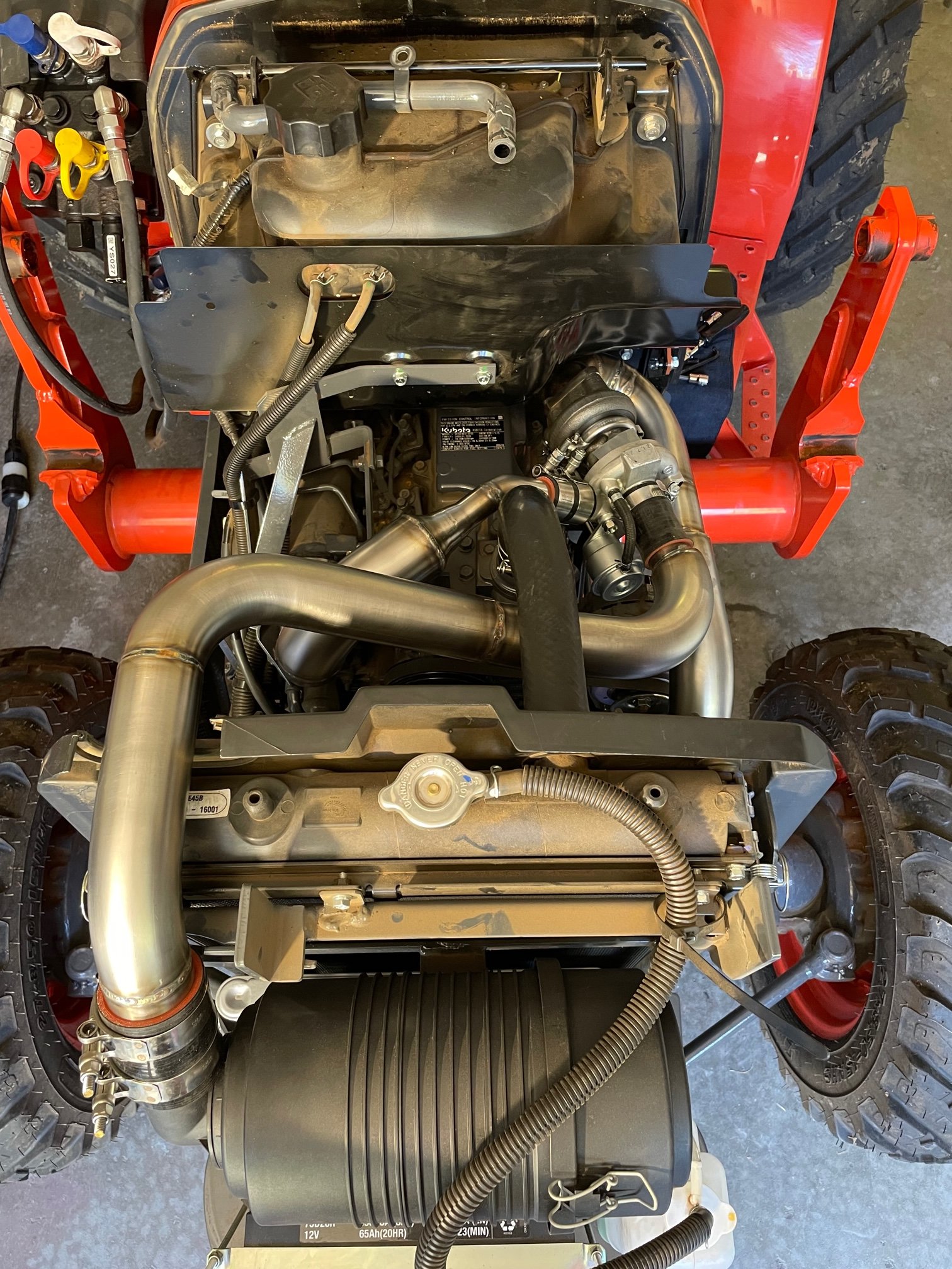

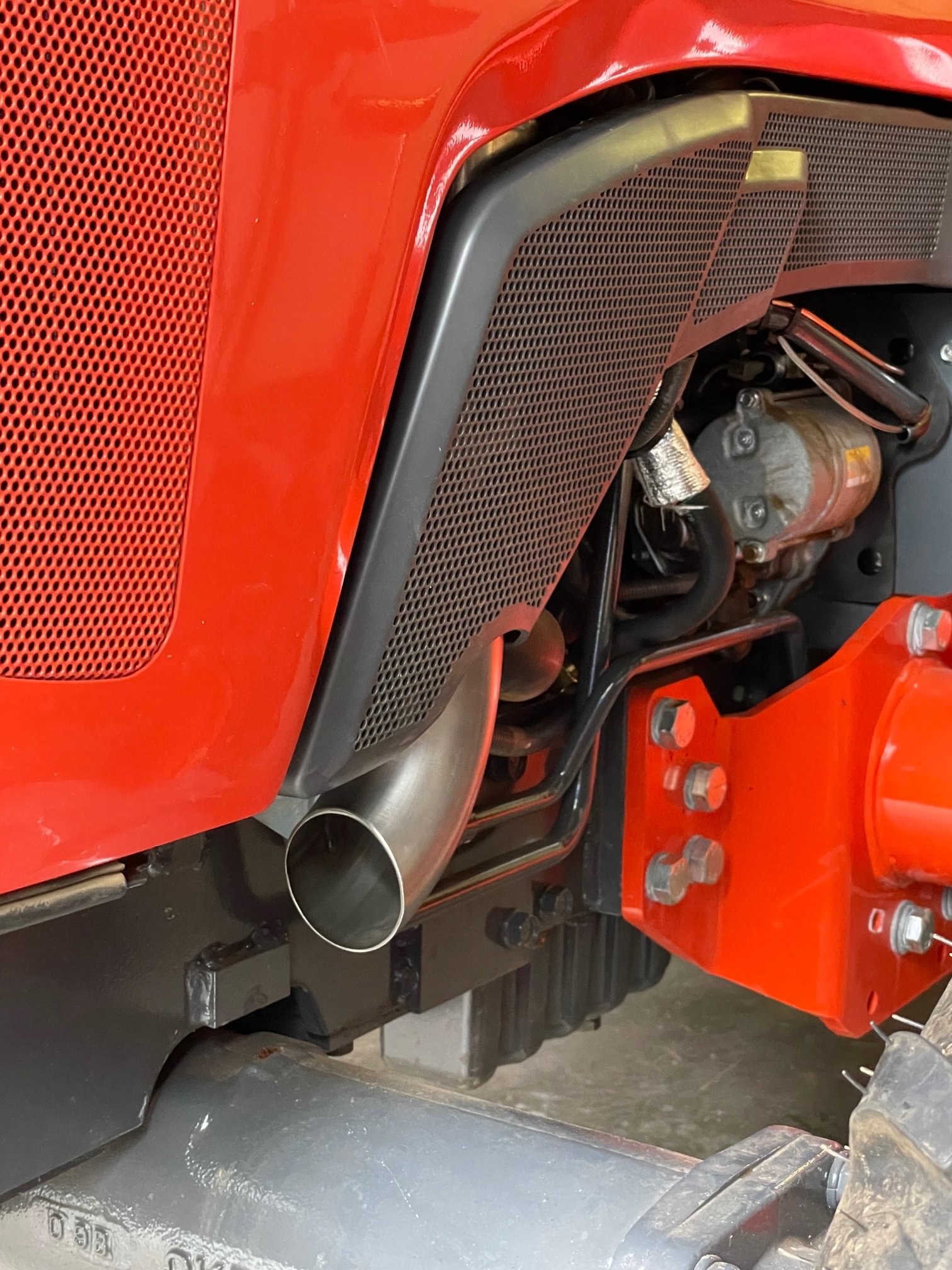

The next big challenge was the Turbo down pipe and exhaust. All things considered, pushing the Turbo forward just a couple inches would make things so much easier. But, since we’re cheap bastards and I decided against building a fabulous custom Turbo exhaust manifold, moving the Turbo forward, is not possible. So it took a colossal amount time and effort to fabricate the down pipe and shape it in such a way to maximize performance, fit the tight confines under the hood with acceptable clearance and allow access to the mounting hardware. But, we did it! Thank heavens!
We’re very happy with the results.
How about the Installation? What is involved? How long does it take? Can anyone do it?
It’s one thing to design, fabricate and build an entire Turbo system, but it’s another challenge to install it. We wanted to make sure the turbo setup is easy to install and remove, if necessary. The installation itself consists of several steps starting with the removal of the front loader, the hood and hood side panels. It’s a good idea to have a buddy help with the hood.
Once those obstacles are removed, you just need to remove the muffler, factory rubber intake pipe and CCV (crank case ventilation) hose. With those items in the garbage (stored in a safe place), it’s time to bolt on the Turbo adapter, followed with Turbocharger and the down-pipe assembly. Once these items have been bolted down, it’s time to install the intake piping. Can it really be this easy? Indeed! Install the new CCV hose to the engine crankcase vent tube and intake pipe and then place the vacuum plug on the intake manifold vent nipple. Now, install the Turbo oil drain and feed hoses.
Congratulations! That’s it! The entire installation takes about an hour. Honestly, I may have left out a step or two but common, it’ll take two hours max, if you’re totally unfamiliar with the tractor.

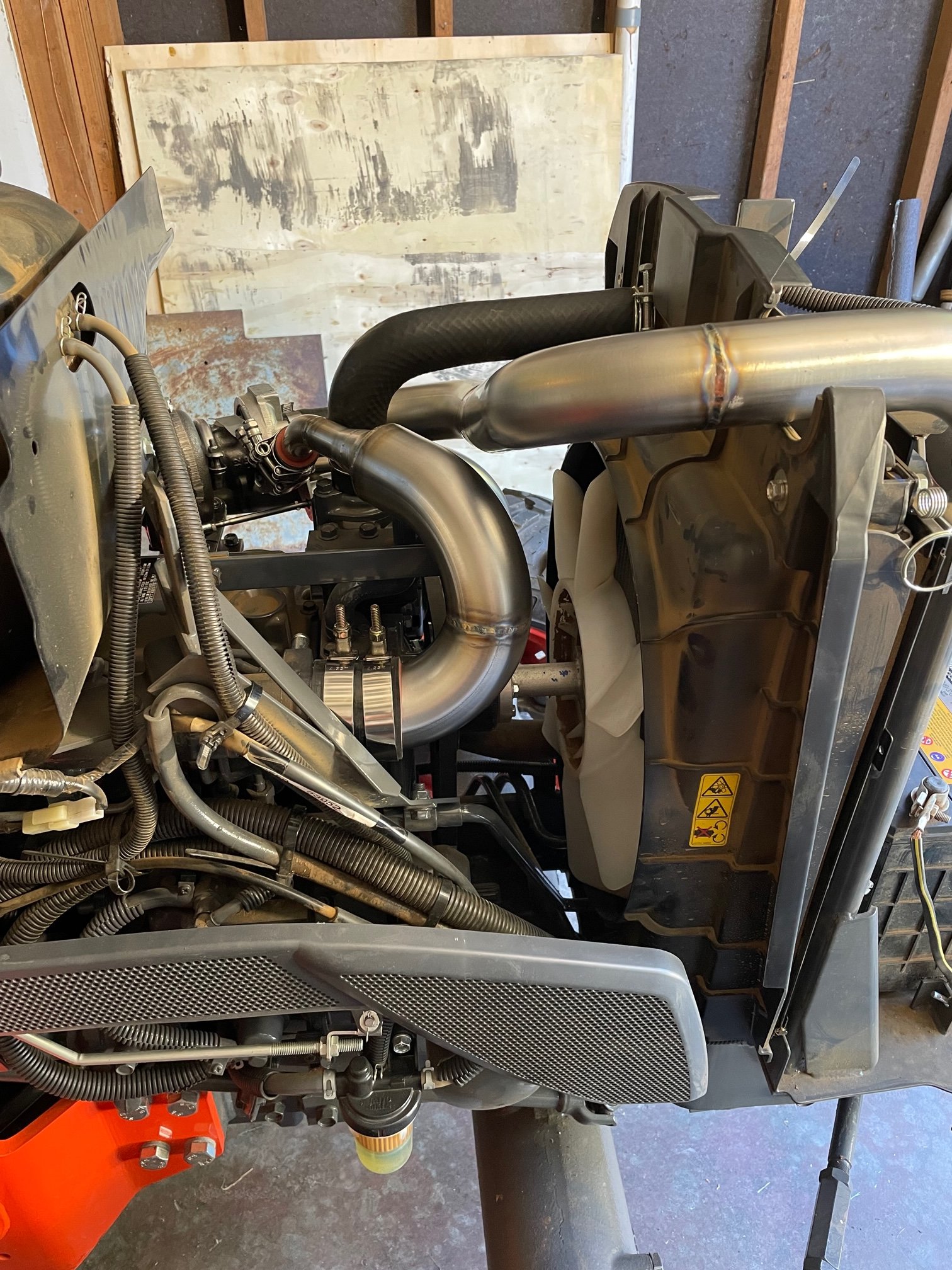

We made one rookie mistake regarding the design and fabrication of the intake charge pipe. We didn’t account for the hood prop-rod absorber and it cannot be reinstalled with the intake charge pipe in place, which means, no hood opening assist. Whoops! So, we’ll have to eventually redesign and fabricate a new pipe sometime in the near future. Shouldn’t be a big issue but, in the meantime, I’m using a shortened broomstick handle to keep my hood open when necessary. That’s the spirit!
Ohhh, that’s right, I forgot one very important step required to complete the Turbo system installation. The fuel adjustment screw. Place palm on forehead. Unfortunately, this simple step can easily double the overall installation time.
By design, it’s not easy to gain access to the fuel adjustment screw. Kubota does not want you to do it, period. Tier 4 emissions, remember? The screw itself is hidden within a thick, heavy tamper proof protective security cover to prohibit access. Those of us that have ventured to remove this cover have found that it’s easiest to use a dremel. This is also the point of no return. Your warranty (if applicable) ends here.
It takes a bit of time cutting through the thick steel but, eventually, once you cut through the cover you’ll be able to get a flat head screwdriver inside the notch you made in the metal and twist off the cover. With the cover removed, fuel adjustments are quick and easy.
With the entire Turbo system installed and the fuel set screw accessible, it was time for some impressions and subsequent testing.
I gotta tell you, Turbo sounds combined with Diesel engine clatter are music to my ears. They’re made for each other. It’s like icing on a cake! The L2501 Turbo literally sounds like a mini-Cummins Diesel engine. Or, if you’re a Ford fan, a tiny 7.3L PowerStroke diesel. It’s hilarious. You can hear the turbo spool up and flutter down with throttle adjustments. Very cool!
How loud is it? There’s no muffler on that thing! Are you crazy? What about the noise? Shockingly, even without a muffler, it’s not loud. It’s about the same noise volume as stock, perhaps a tiny bit louder. The Turbo itself acts as a muffler for the exhaust and I believe using the OEM intake instead of an aftermarket air filter, also helps with the overall noise volume. I haven’t felt the need to use ear protection while running the tractor. Realistically, when you think about it, why would I bother? It would be a sin muffling the glorious sound when I’m so fond of all the new noises. Right!
With the Turbo system installed and the tractor running smoothly the time has arrived to see what this machine can do. Let’s get to work!

Traveling up hill carrying medium load (22* Slope, 40% grade) (M) = 575-700*
Peak EGT = 700*
As you can see, nothing really has changed. The EGT’s heat up a bit quicker but, overall, the temperatures are running around 0-75 degrees cooler with the Turbo installed combined the factory fuel setting. I’m assuming this is because there is more air getting forced into the engine with the same fuel volume. Right now, with the Turbo and factory fueling, there is zero smoke coming from the engine, regardless of conditions. The engine is using all the fuel it can get.
We’re just getting warmed up!
Let’s add some fuel!
I started with a 1/2 Turn, counter clockwise to increase fuel volume. This setting resulted with a peak of 6 PSI and 3 PSI of sustained boost pressure. No smoke was observed during testing and surprisingly, EGT’s dropped under load going up the hill in (M) gear. Strangely, maximum EGT observed was 631 degrees. Weird.
More puzzling, I wasn’t happy seeing only 3 PSI sustained and I began questioning why I wasn’t maintaining more boost pressure. Was it fuel? Or, was it something related to the Turbo system? At this moment I started questioning the capacity of the OEM intake assembly and air filter. Could it flow enough air for the Turbocharger? I quickly removed the OEM intake assembly and ran the Turbo open-air (no filter) to see if the factory air intake assembly was causing a restriction.
The tractor did in fact pick up an additional 1 PSI of boost both peak and sustained with the same fuel setting, but only 1 PSI. 1 PSI isn’t monumental. This proved a few things; one, using the OEM air cleaner assembly and filter is perfectly acceptable. Two; with such a small gain in boost pressure, it isn’t worth using an aftermarket performance air filter, especially considering the air filtration issues. And three; I need more fuel. I reinstalled the OEM air cleaner assembly and prepared for additional testing.
I gradually increased the fuel volume to 1 full turn, counter clockwise. This setting resulted with 7 PSI peak and 4 PSI sustained boost pressure. No smoke was observed during testing. That’s not enough sustained PSI. I still wasn’t pleased with the results.
L2501 HST 4WD (LA525 Loader w/ 66” QA Bucket, Liquid Tire Ballast) - TURBO SYSTEM - 7 PSI - Fuel setting, 1 Full Turn (75* ambient temperature).
Recorded EGT’s:
Idle = 275-300*
Traveling on flat ground (M) = 300-500*
Loader and grading work (M) = 500-630*
Traveling up hill carrying medium load (22* Slope, 40% grade) (M) = 500-640*
Peak EGT = 640*
I then increased the fuel volume to 1 1/2 turn, counter clockwise. This setting resulted with the same 7 PSI peak but, 5 PSI sustained. Now we’re getting somewhere! There was some smoke observed at startup and a puff or two during operation. Not bad. I was happy to be making progress, but, still unhappy with the results.
L2501 HST 4WD (LA525 Loader w/ 66” QA Bucket, Liquid Tire Ballast) - TURBO SYSTEM - 7 PSI - Fuel Setting, 1 1/2 Full Turns (82* ambient temperature).
Recorded EGT’s:
Idle = 250-300*
Traveling up hill carrying medium load (22* Slope, 40% grade) (M) = 500-641*
Peak EGT = 641*
Shockingly, the numbers really aren’t that different. Why? I just can’t place enough load on the tractor to make it work hard enough to sustain boost pressure. Even going up my big hill in (M) gear carrying a load isn’t enough to maintain a load on the tractor. Crazy!
