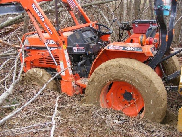

I only use 4wd when needed. I'd rather know I have extra traction available instead of going to far and not be able to get out.

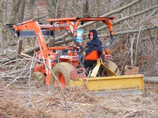

This is one of my son's better moments. He said he stopped as soon as he knew he was stuck.

No wonder he got stuck. There's no tread on those rear tires! :D:D
LMAO. It's a tractor, it will go through anything.

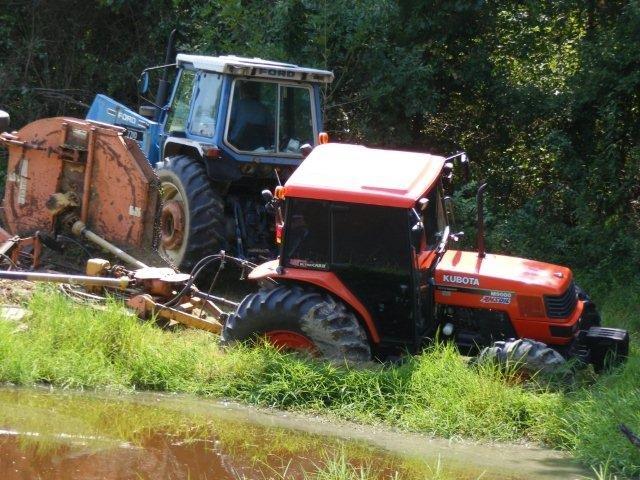

Of course he gets it honest. This is when I almost turned over in the pond.

Took my neighbor about 20 minutes to get there. I'm glad he got there when he did because it was still sinking.
