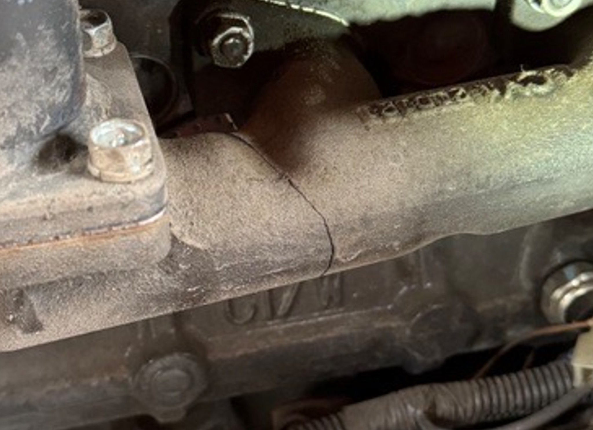

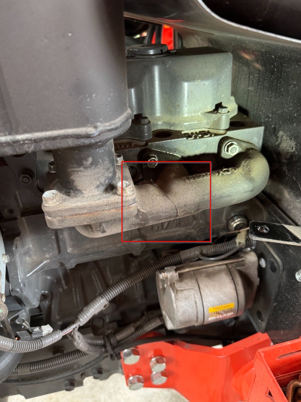

Was clearing up some woods today, pushing over some small trees, etc... and then, whammo! I was backing up after pushing a small tree and the tree decided it would attack me and as I backed up it snuck up in the tractor got hung on the exhaust tip and cracked the manifold. How in the world can such a small tree break this steel. Oh well, it did. Tractor got LOUD immediately so I figured something with the exhaust, sure enough. At least it didn't get the radiator/fan.
Thinking I might just tack weld it, would you do that? vs buying another manifold.
JB Weld makes a high temperature version for manifolds. I just applied a bot to a small hole on the side of my sauna stove. So far so good. I realize this is a hillbilly style repair and may not offer a permanent solution. For
JB Weld makes a few high temperature tolerant "solutions" for your problem. I just patched a small crack in my sauna stove with one and so far so good. I realize this is possibly not a long term solution but for $9.00 I figured its worth a try. I have had great luck using JB Weld in the past. Good luck.

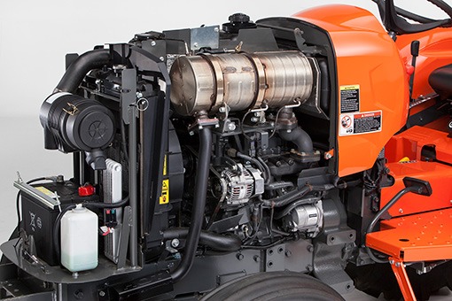

I guess I’m easily confused. What tractor is being referred to in this thread?
The manifold dustyrusty posted the link to looks exactly like what is needed. But it’s not listed for an L2501, except for the L2501F which is a 2 Wheel Dr. tractor. OR the l2500DT.
But the OP lists his tractor as a l2501DT.
An on-line image for the L2501 shows this:
Looks different that what the OP posted. When reading the OP’s first post, I imagined a vertical stack coming out of the hood.
what are my missing?

That is not a L2501 in the USA, no DPF on a L2501.
Agree with Orange Man, looks like it could be a L3301 or L3901.

seems that manifold fit 63 models !
seems to connect to an oval muffler ( see post #1 picture )
I know. But the L2501 is not listed as one of them...that is what confused me. (except for what I listed, which was the 2wd drive model).
Also I can't find a photo of a L2501 with a vertical stack. All I find is photos where the exhaust exits similar to shown in that photo I posted above, where the pipe exits near the left front wheel...
Of course I may be missing the obvious. Won't be the first time...
