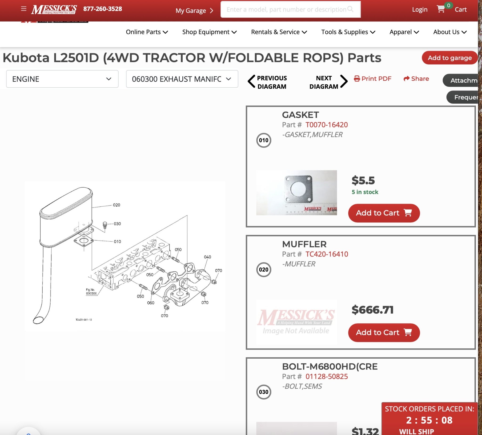

the picture in #1 didn't show the entire muffler.....
I never assume the tractor that needs the part IS the same as in the profile (some actually own more, others could be working on a neighbours, or tractor is a 'variation' of a model....)
#43 shows the muffler...yikes a $666 !

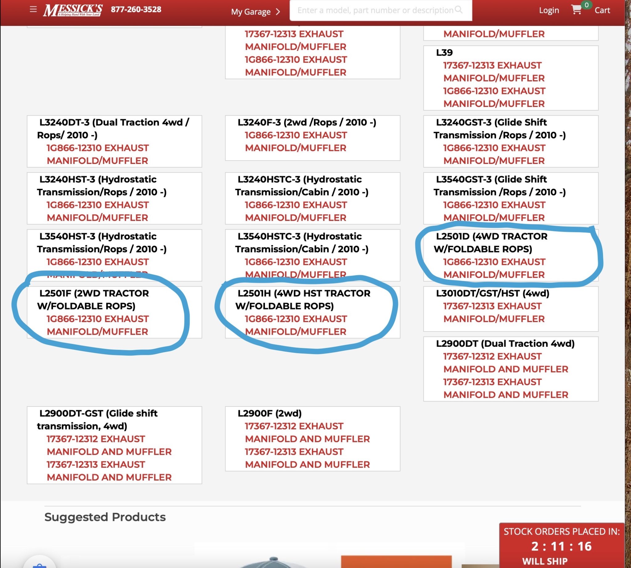

Not to beat a dead horse, lol, but Messicks lists 3 L2501's that fit this exhaust manifold.
L2501F. 2wd with foldable ROPS
L2501d 4wd with foldable ROPS
L2501H. 4wd HST with foldable ROPS
I have no clue what the difference is between a L2501D and L2501H. Heck for all I know , these letter designations may not conform 100% to Kubota's letter system.
What puzzles me is the L2501DT is missing from that list. And that is what the OP lists as his tractor. Could be a simple typo…OP, where are you?

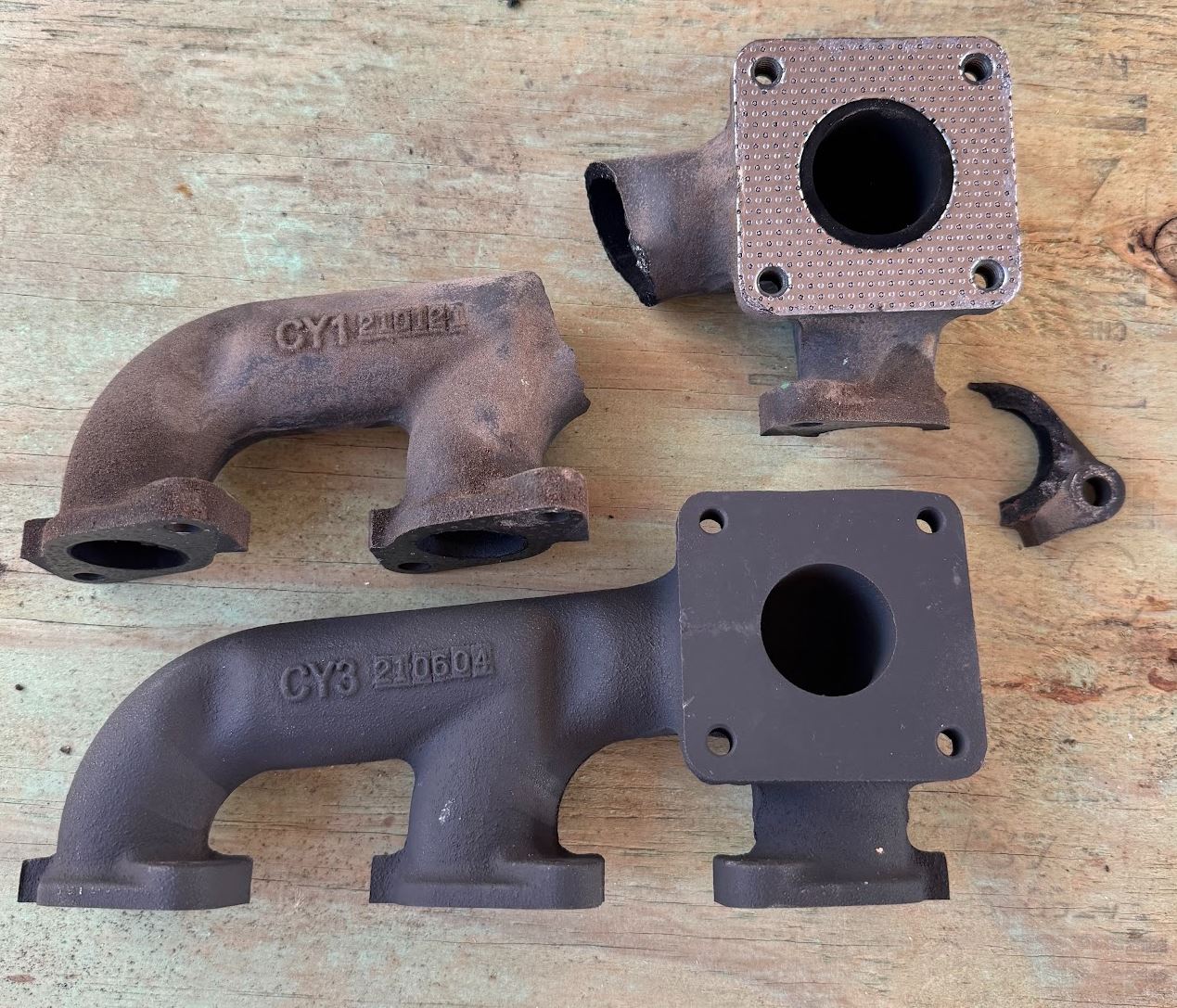

Got the parts in and got it replaced. Went so fast and smooth that it didn't even seem right!
Looks like the manifold was broken in two places also.
