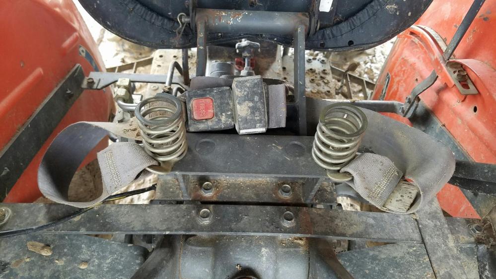

Hello Grant
I see you are still working on your seat. Here a picture I took today of a tractor I was working on. L 235DT ,seat belts bolted the springs. Hope this helps.
Good Luck Lance
greagin
L4200DT-GST
Apr 4, 2016
31
SC
That is EXACTLY what I needed!!!!!! Thank you SOOOOOOOOOOOOO MUCH!!!! This forum is priceless!!!! Thank you all!!!!!
