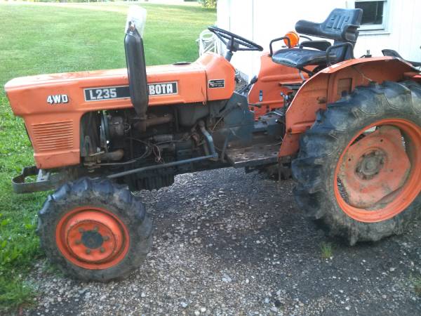

Just bought a non op L235 4wd for $1800 including delivery 65ish miles away.
Good or bad price?
She has a knock in the top end? somewhere. Body is fair. Not rusting away. Bings, Dings etc. from the Tractor actually being worked.
Did not fire it. Just spun the motor. Glow plugs looked recently reworked. Supposedly everything works but the engine issue. Was a dealer trade in. It started and ran when dealer got it. So apparently knock started after that.? Employee? (Im guessing salesman) ended up with it with intent to rebuild and saw he just doesn't have the time. He then sold it to me. I heard the knock as we spun the engine. When I saw it today it had Been sitting in same spot for week or two since he brought it home. There were no leaks appearing below it.
Looked used but not "abused". I'll see if I can get the old owners info so I can contact him about how he did/didn't do maintenance to give me some ideas.
. Any ideas on what I should look out for?
. Other areas I should investigate for wear?
. Ideas on how to investigate the knock?
. Any common issues with this model tractor?
I was stupid and didnt pull the dip stick to smell for Diesel in the lube oil or look for oil in radiator. I knew others were coming to look at it and my gut said price was good and I should grab it while grabbing was good.

If the glow plugs have been messed with, I would pull those, and look for signs of the piston slapping them or look for the plug inside to see if it has become dislodged.
ohhhhh. now that would be sweet!!! unless of course it damaged top of a piston. Other wise would be easy repair.

There was a whole family of these tractors (L175, L185, L235...) that were all similar and had similar problems.
You may not have a water pump. Smaller tractors (like my L185) were thermo siphon. You need to be sure the radiator is clean on the inside and the outside. They overheat and crack the head if not taken care of.
The steering column needs to be taken care of - they leak water into the box and where you live that will freeze and break your steering. See the ARTICLES tab and there are 3 parts to read (one linked below)
http://www.orangetractortalks.com/2010/01/how-to-repair-a-steering-box-part-1/
The transmission will have a filter screen (below and behind the left foot board) that should be inspected and cleaned once you get it running.
The transmissions also leak water if left out in the open so you should change the fluid (there are several drains some on the rear axle) and then keep it covered up as best you can.
Search the Forum for the tractors in the L series and you will find a lot of good information.
Welcome and good luck with the tractor. If you get it going, you will love it.

Watch the oil pressure, they like to push out the cam oil plugs.

Can you offer more detail on this? We have an engine knock etc. and wonder if this may be why.... or led to why.
