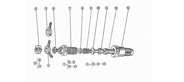

I was looking at the aftermarket injectors, probably as you wrote this. Are they all junk? Looks like $45 - $60 on ebay
Looking @ the kubota parts diagram for the L225, it is a little unclear what is the PN for a complete injector
I attached the image from the parts company.
1.1 INJECTOR, FUEL A replaces #15221-53000 70000-65208 $69.44
1.1 INJECTR replaces #15221-53020 70000-65209 $67.50
2.1 INJECTR replaces #15221-53030 70000-65209 $67.50
