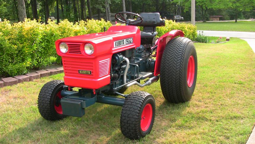

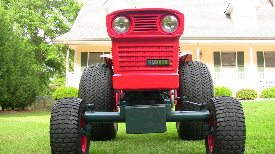

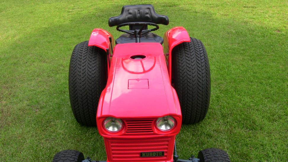

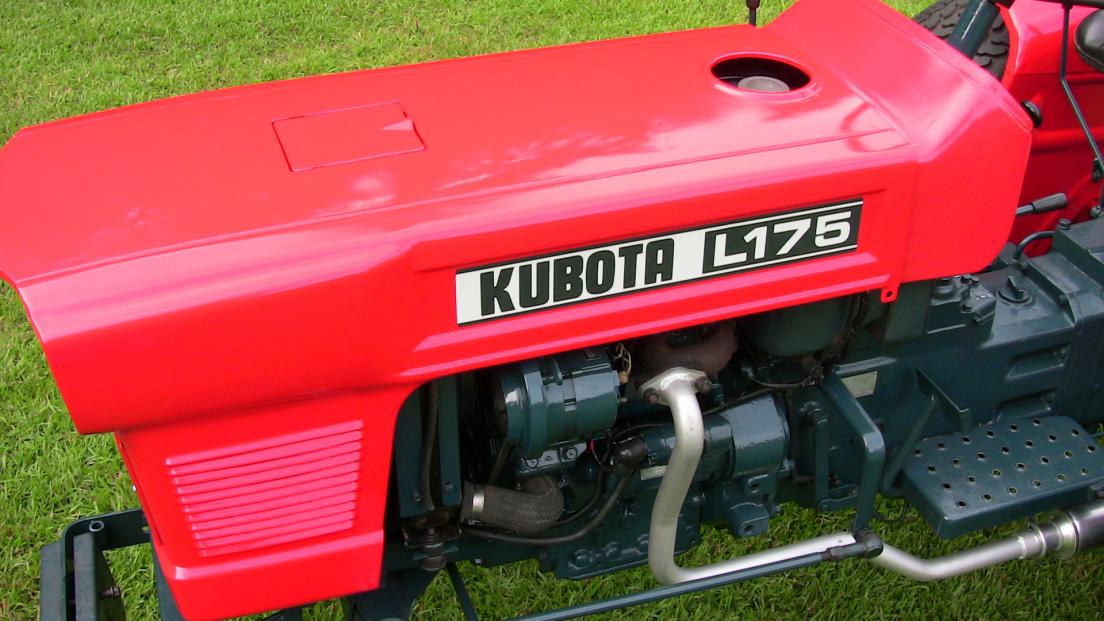

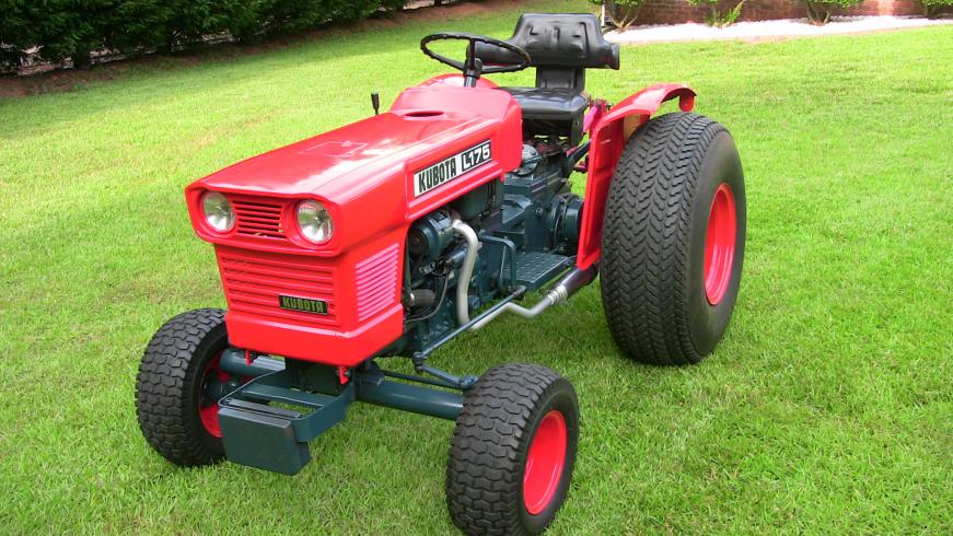

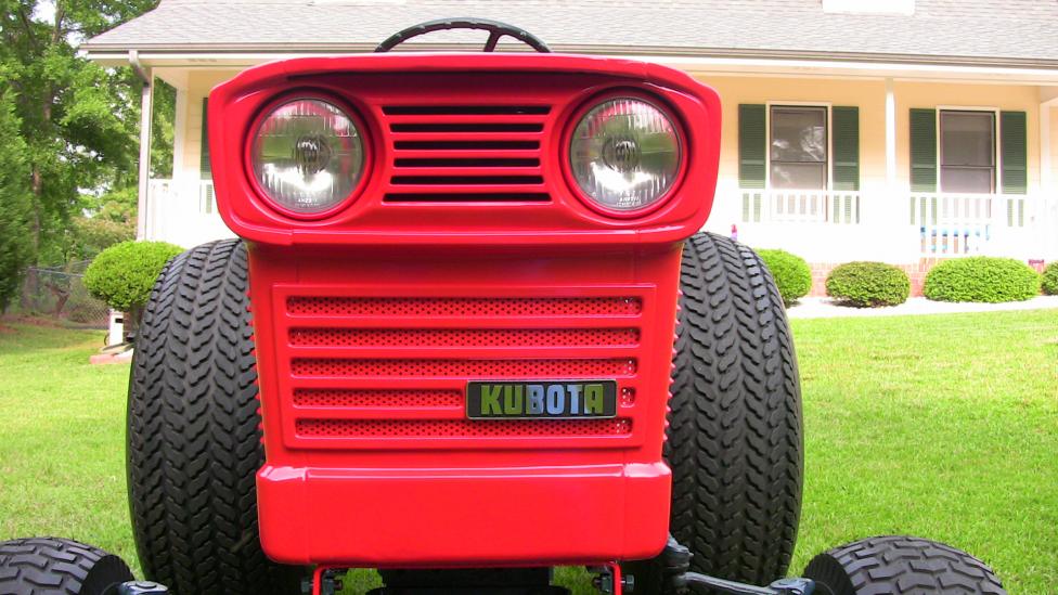

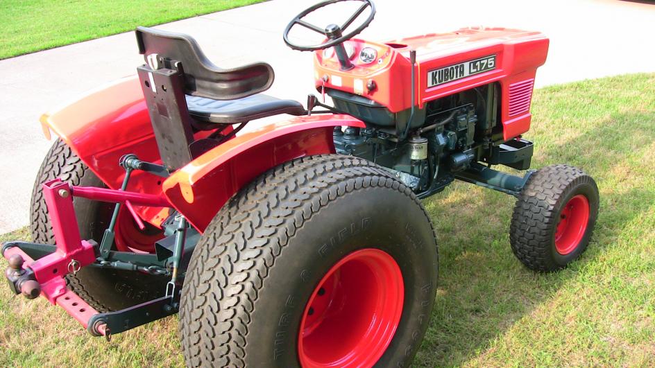

Here she is!!!!!
The pics you have been waiting for!!!! Me too because that means I'm done with painting and ready to use my tractor finally. :D :D :D
It really feels to me like I'm looking at a brand new tractor. This is the same color as current production and it makes this tractor look as good as and even better, to me, than one with a "coupon book". :D

I keep looking at it and looking at it. It really turned out very nicely and I am pleased with it. I guess I am still amazed at how different it looks than when I got it. It was so smashed and faded and now it is so shiney and clean that I am still trying to get my head around this new look and feel.
YIPEEEEEEEE ! ! ! :D :D :D :D
I'm just tickled orange. :D :D :D

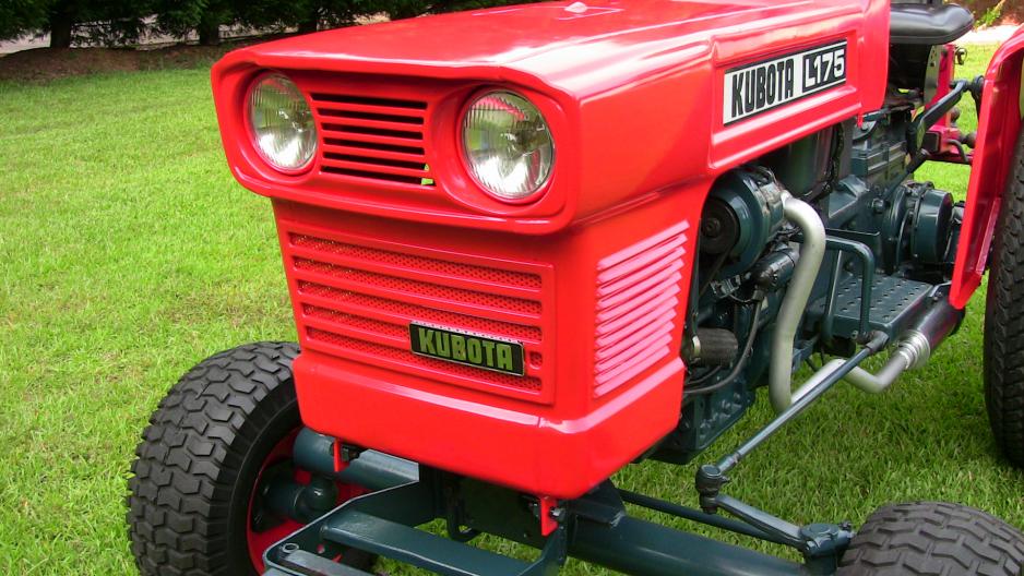

Wow that looks great. Feels good huh. Awesome work.:cool: Dusty
Thanks Dusty :)
It feels so good I just have to keep posting pics. :D
I'm kind of surprised at the sun wash out in some pics. I had it sitting in the shade and this camera is quite a pricey nice piece. Maybe I should have used a lens filter. I have some but I expected that the shade would give me enough cover. :( guess not
The color even looks off in some pics.:mad:

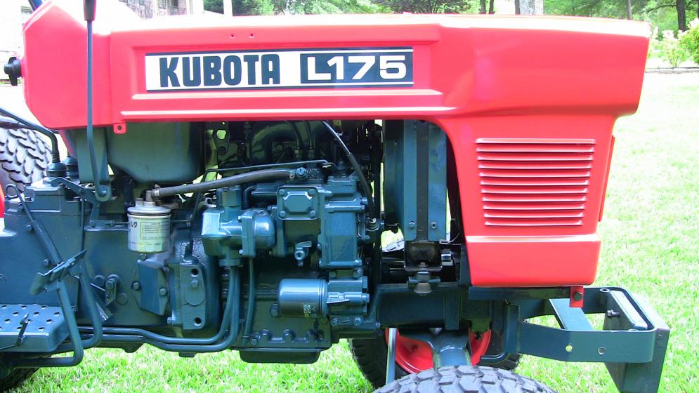

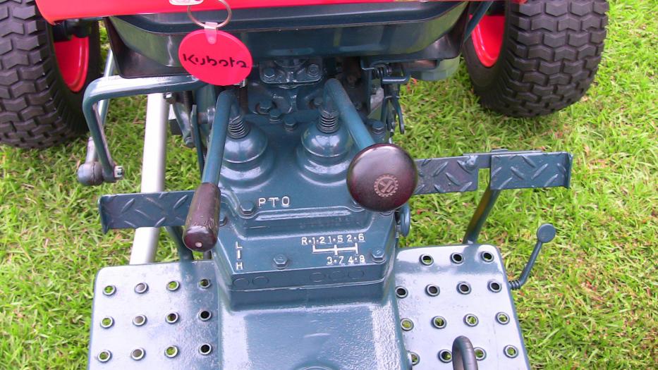

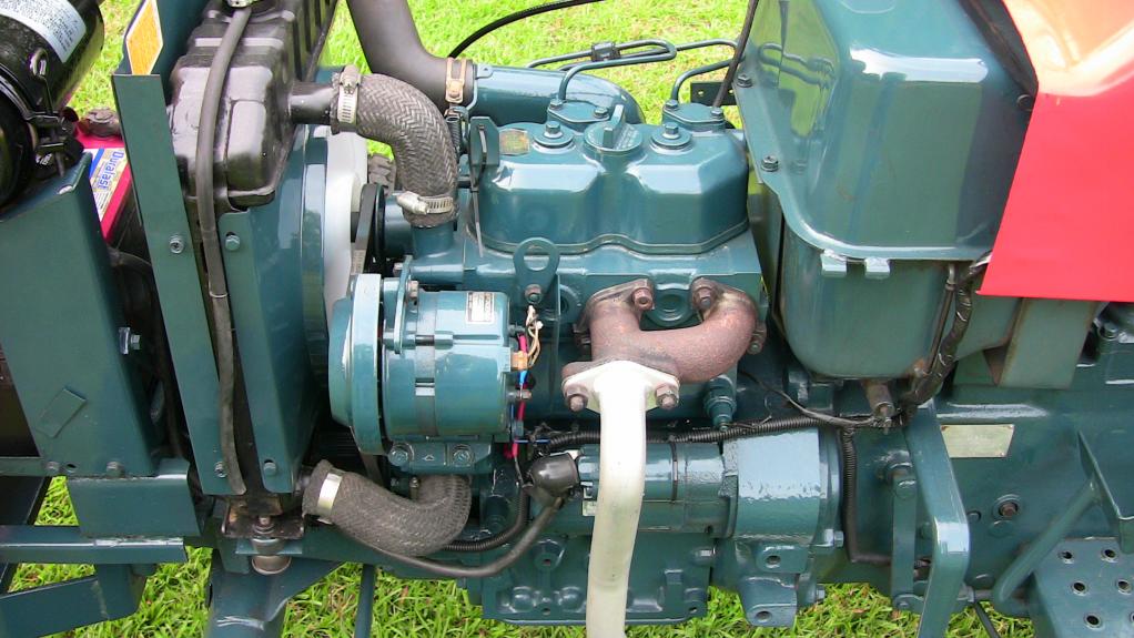

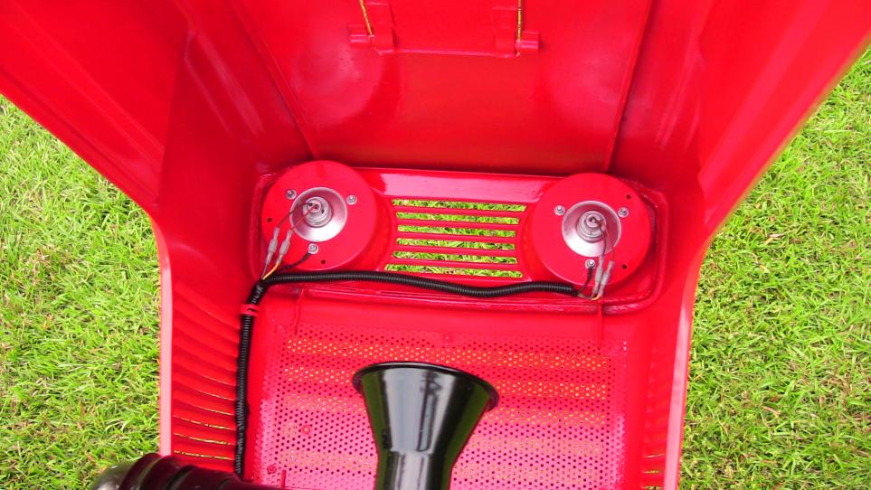

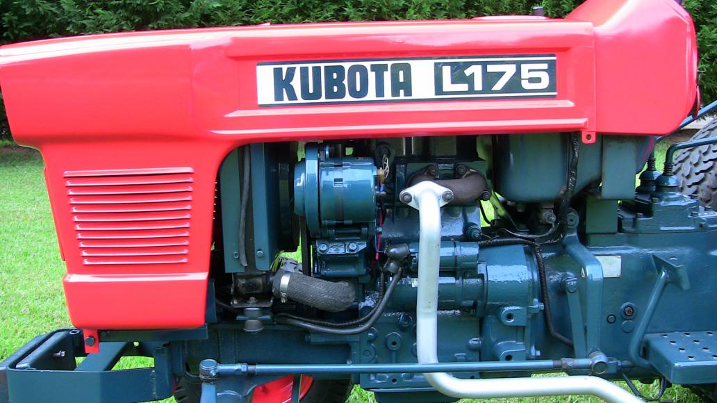

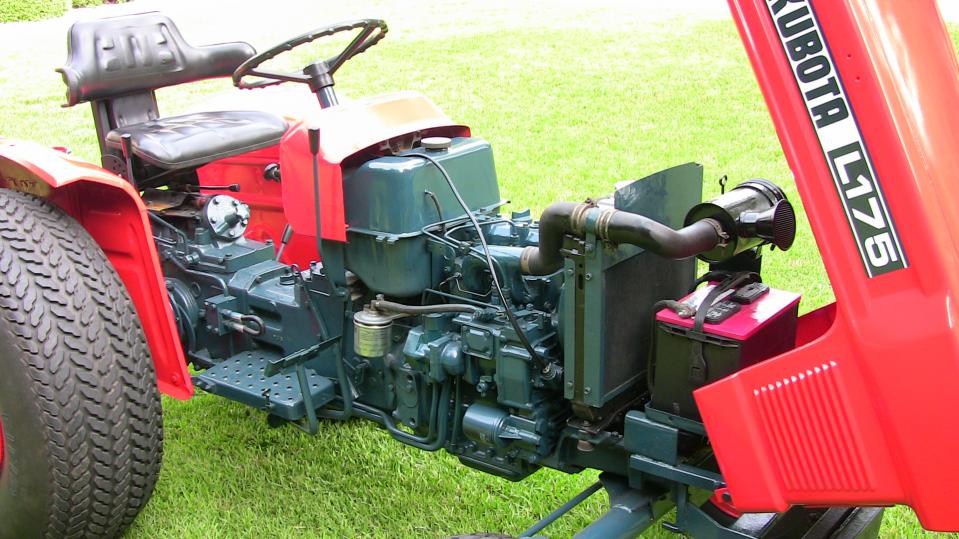

Some of this blue was done at the time of building the engine back but I think this is the first time I have posted these pics too. You can see this tractor is clean top to bottom.
The silver paint on the shifter positions was a paint marker. It worked very nicely and easy. I just rubbed it over the top of the castings and it looks like I stenciled it out.:D

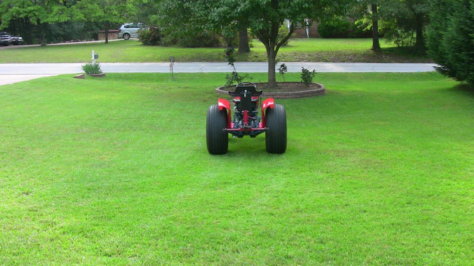

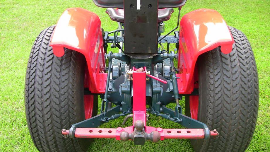

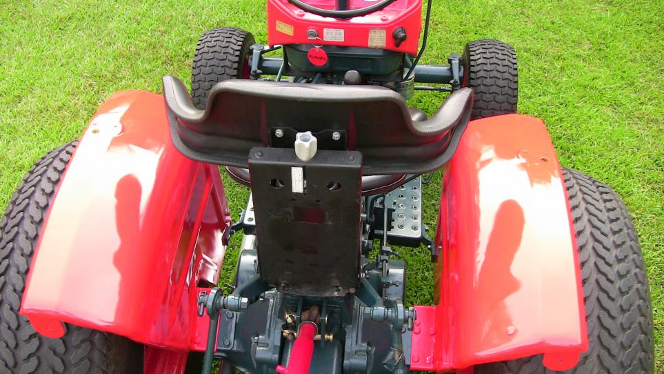

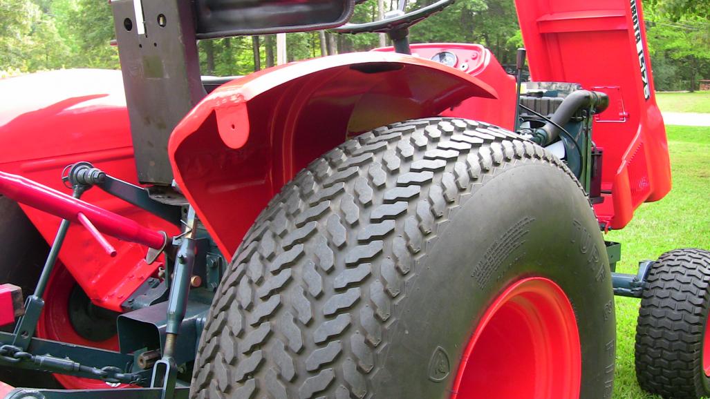

I took some shots to show inside and out of the fenders. They have a great shine. For starting off with rusted hulls for rear fenders they have made a total transition. Kind of hard for me to think of these as the same fenders that were on it when I got it.
Nice fenders for getting crushed in a rollover. :D

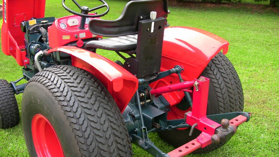

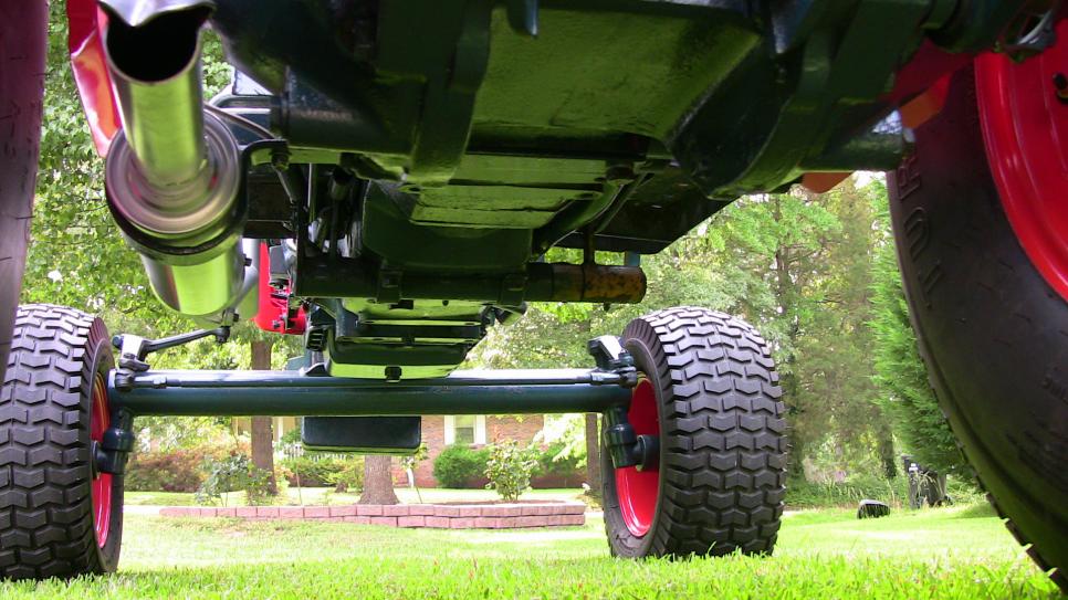

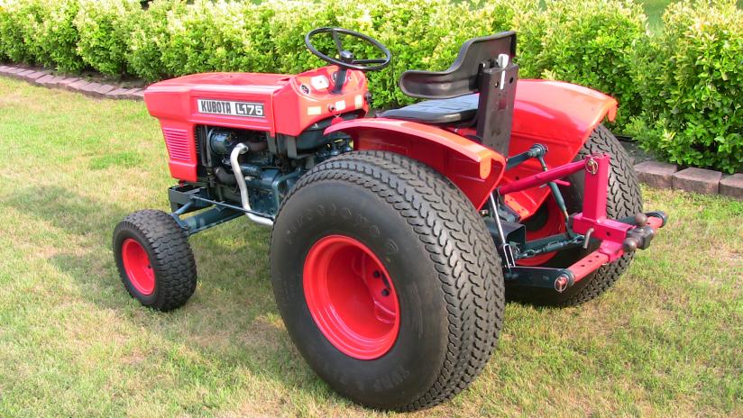

Here is a pic to give some small perspective of before and after. I took this pic from the best angle the tractor had when I brought it home. Notice the fender is almost touching the tire. eek!
The next pic is not the exact same shot but it is similar for comparison sake.
And here is a pic just so you look up to a Kubota. :D :D :D :D

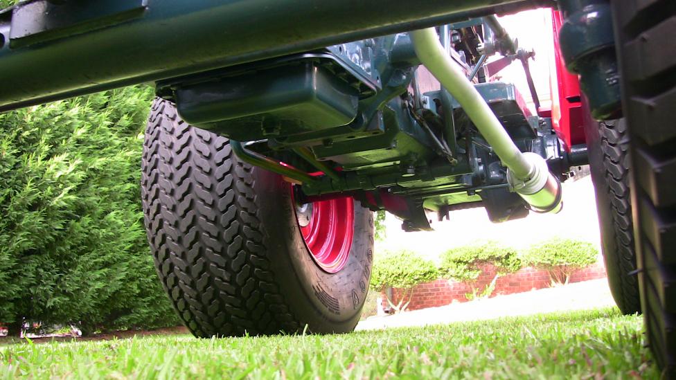

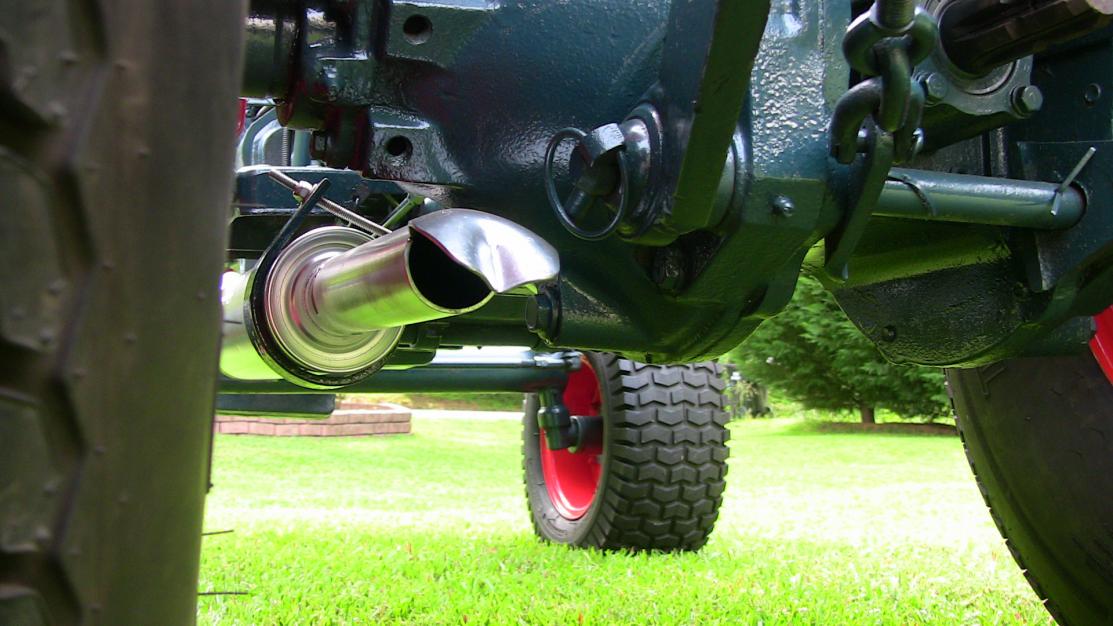

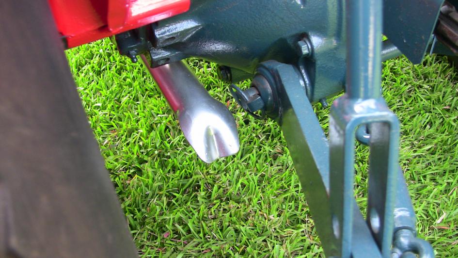

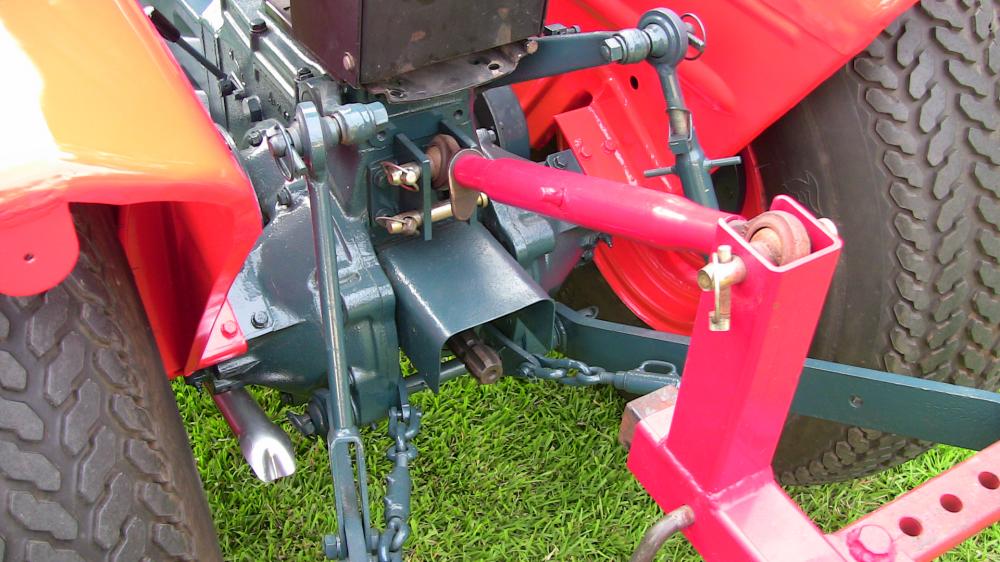

I custom made this tip for the exhaust. The pattern and concept comes from late model OTR trucks that have particulate filter cleaning called "regen". When the exhaust goes into this regen mode the heat expelled from the exhaust could start a grass or other material fire so the tip is made to address this situation. With it's design the tip will fan out the exhaust and create a turbulent that rolls the hot and mixes it with cold air to dilute the high temps down.
When I saw this work I noticed that there was no exhaust pulsing in a specific direction but rather scattered out everywhere. This gave me an idea. :) If I can spread out the exhaust then I won't kick up dirt and grass around the tractor.
Guess what.................................... it works VERY well. The exhaust will barely make a blade of grass move at 2000 rpm. :D

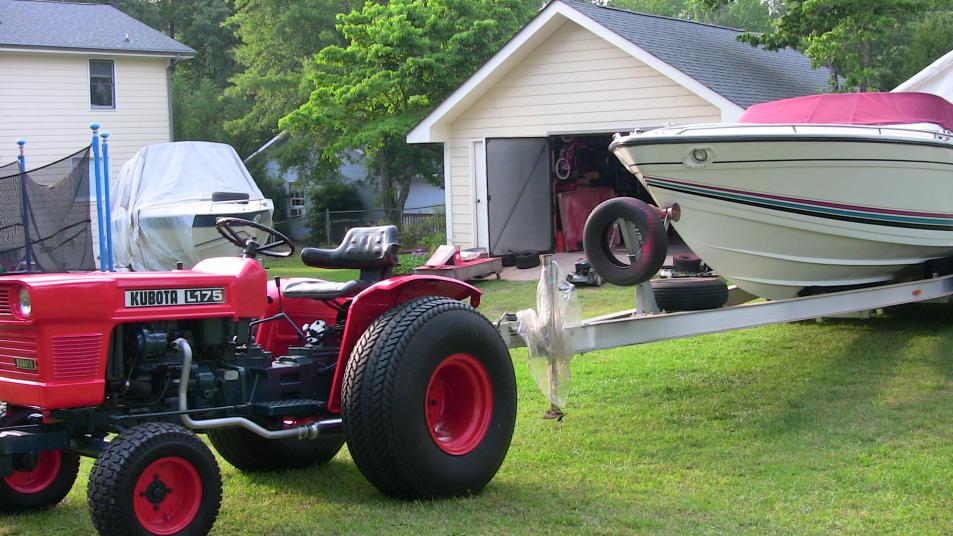

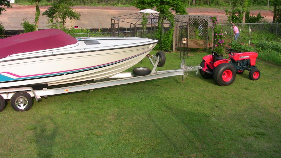

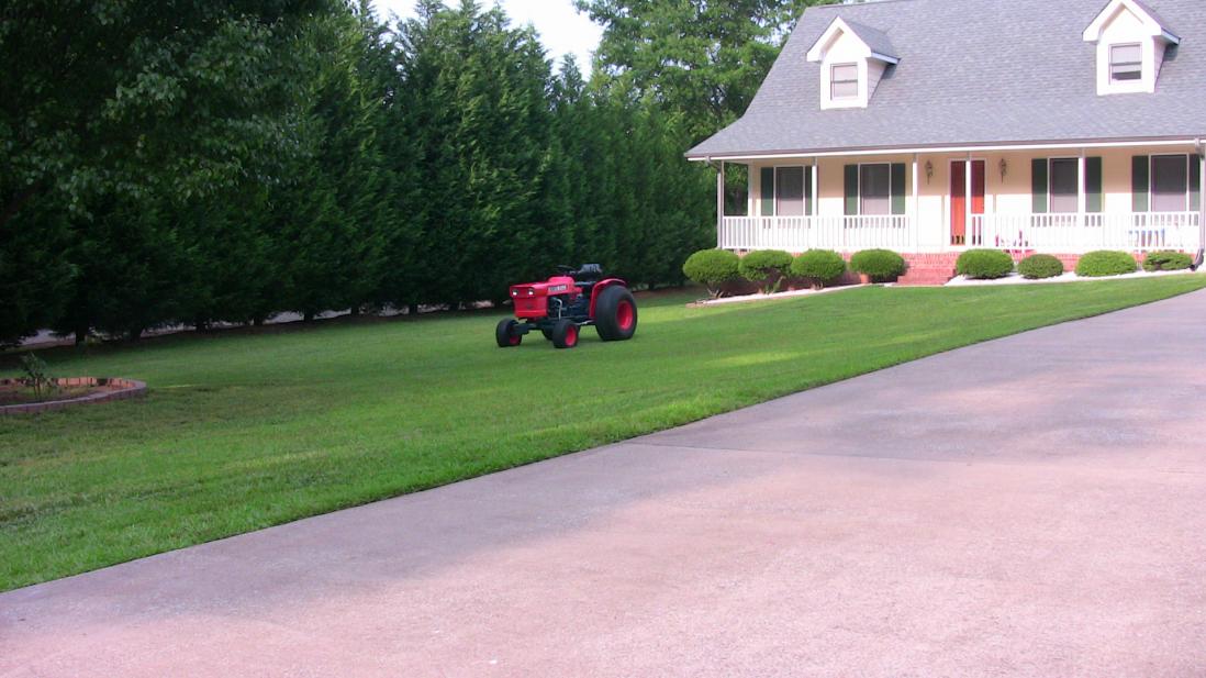

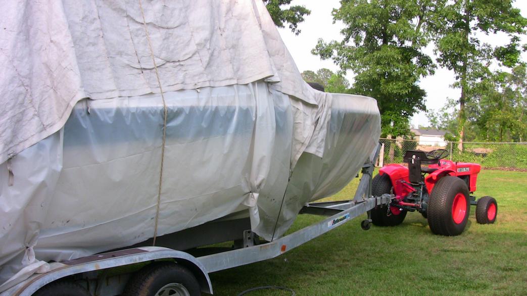

This is mostly what the tractor does right now. I don't have enough room on my little .8 acres to move the boats around in the back with the Suburban. The tractor can move the boats around with ease and pleanty of space which lets the inlaws have a larger garden and I can still get into my shop.
Now it is done and I can get my boats fixed too. :D
I hope the pics were good for someone working on a restore project.
