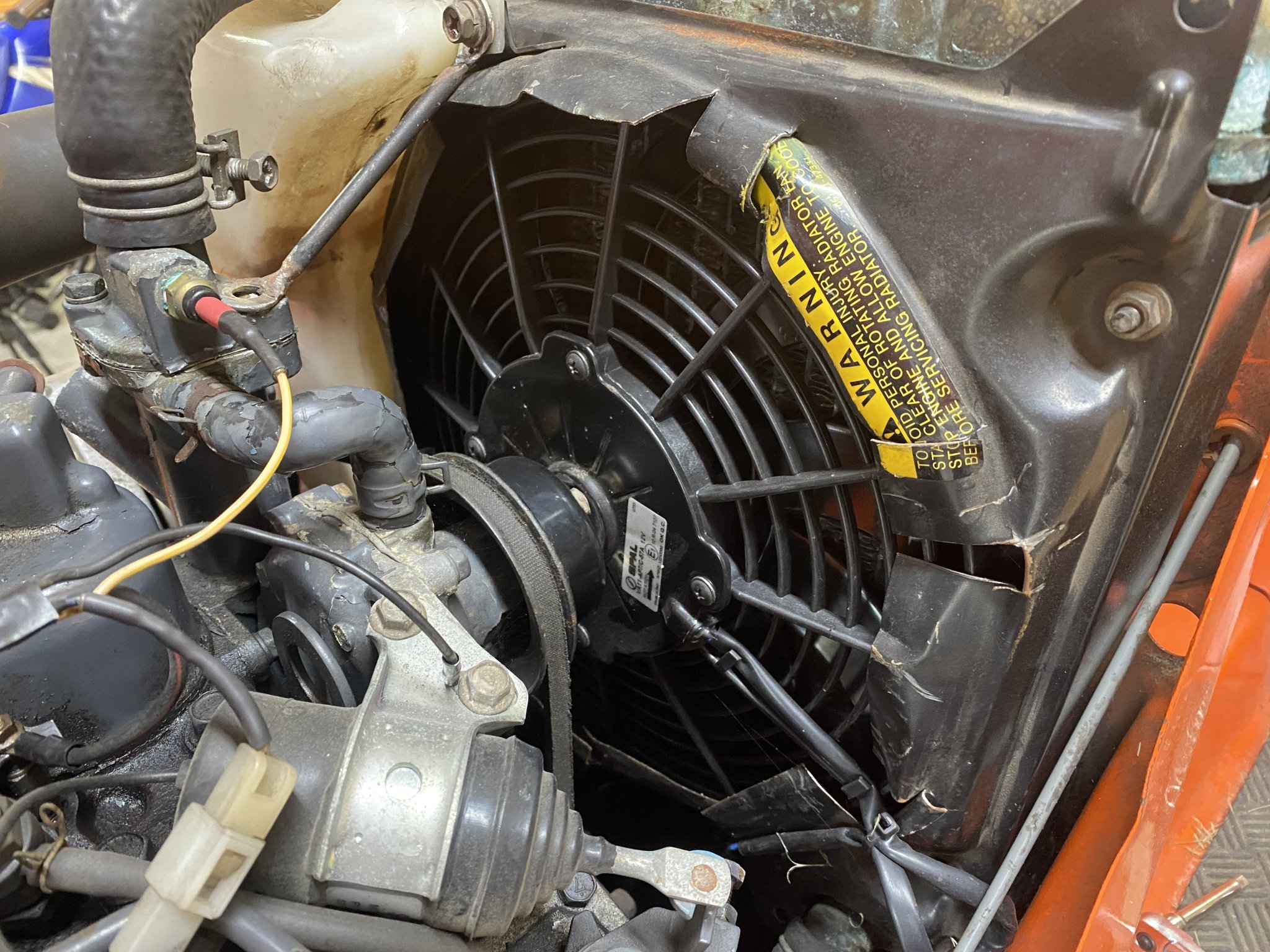

Fans do most of their work at the outer edges of the blades because that is where it’s moving the fastest. A substantial part of the outer portion of your fan blades is obstructed by the shroud being bent over it. Try fixing that and see what happens.

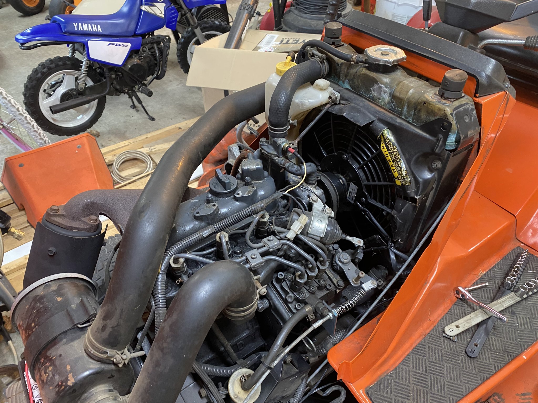

after going back to look at the pics no wonder it's overheating. I think I recognize that fan. The air coming off of it moves pretty quickly but the actual CFM volume is lower than you'd think. I want to say 840 cfm which is nothing in terms of a cooling fan.
Plus I believe that fan might be moving the air the wrong way as well. IIRC that design fan is deigned to "blow" through the rad on a vehicle with longitudinal engine layout. So mounted where it is, it's likely trying to "push" air through the rad.
normally you can pull the blade off, flip it, and then reverse the polarity of the leads. That will "usually" change it from a puller to a pusher, or vise versa. But yeah I can see where you're coming from.
It's a "puller" fan meant to pull air through a radiator.
