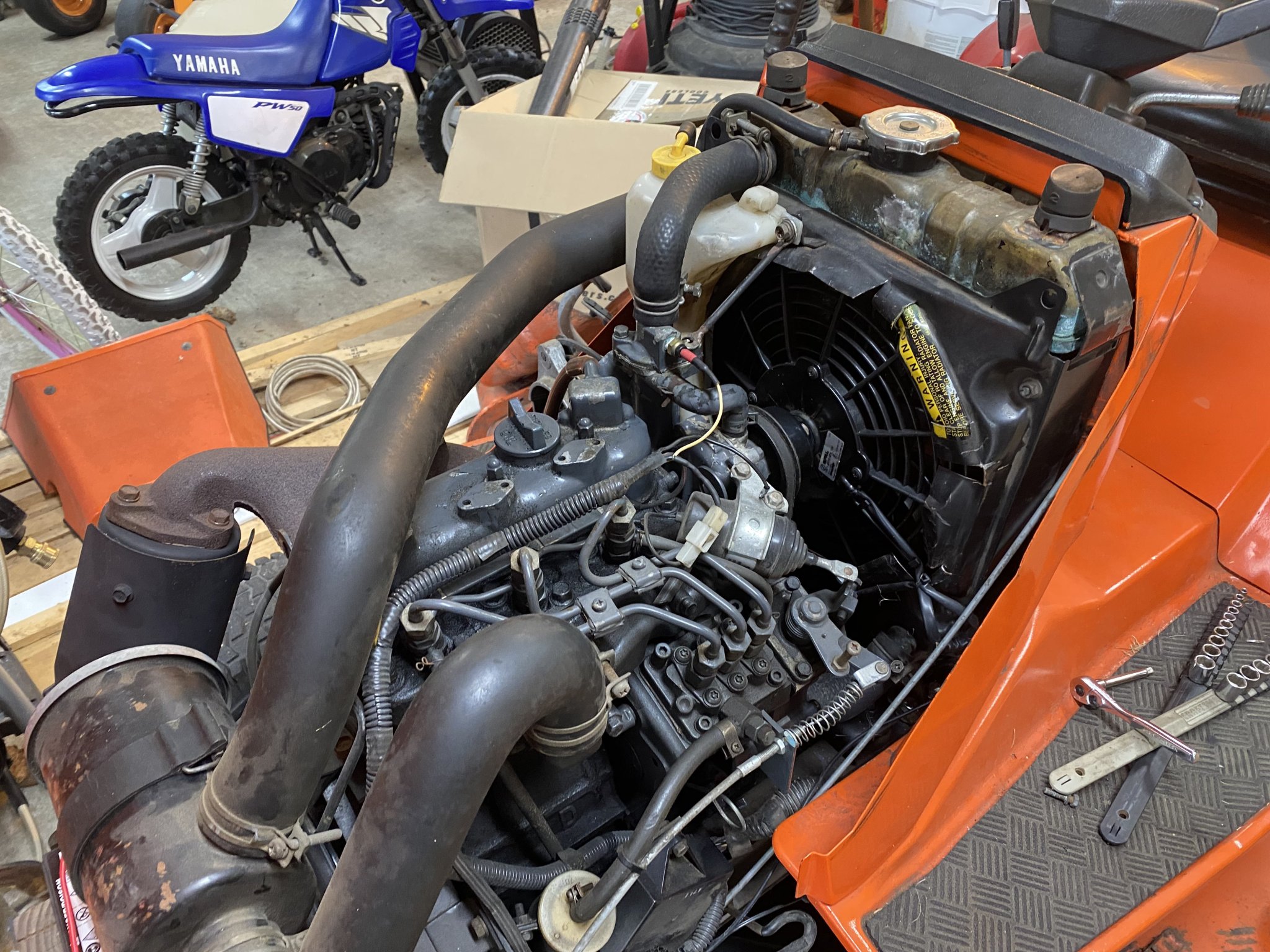

I think you would have been better off with a pusher mounted on the other side, but then it would be tough for when debris gets on there. Maybe it could have been adapted to the removable screen somehow

I used a PWM fan speed controller to not have it run at full tilt all the time. Some people said it was moving "too much air".
No such thing as too much air. Now whether or not it is moving the right way is another question. Could you have the fan wired or mounted backwards? Pushing air instead of pulling air? Is the fan shroud effectively disabled (you said you had to bend it?

That shroud is.........hmm........interesting.
What was wrong with the original fan setup again?
I tried that. It was moving tons of heat, because my leg was on the verge of melting. Then again, this isn't the right way.
jacoBiceps
Kubota G1900S
Nov 15, 2022
27
Louisiana
No it's most definitely pulling air out the back, the way it originally did.
jacoBiceps
Kubota G1900S
Nov 15, 2022
27
Louisiana
What is the wattage of the electric fan at max speed?
Which fan blade angles are more aggressive, belt driven or electric?
For the electric fan, is there any short circuited air flow; ie., through the fan, but not the radiator?
Point of reference for what it's worth: My Chevy Colorado 3.6L DI uses a ~800 watt fan with the alternator capacity to drive it. Diesels produce more heat under load.
Can you measure the electric fan RPM?
* I am assuming belt driven fan does not use a clutch so you can figure out it's RPM.
My take is the belt driven fan provides more airflow.
The electric fan pulls roughly 9 amps at 12v at full tilt so roughly 108 watts.
The belt drive's fan blades are definitely more aggressive as there are only 4 blades instead of 10.
I don't know about short circuited air flow.
I can't measure the rpm of the fans. I would have to get a meter.
108 watts of power to fan motor, probably <90 watts moving air. That's just a butterfly wing flap compared to the belt driven fan. Ok, maybe I exaggerate some.

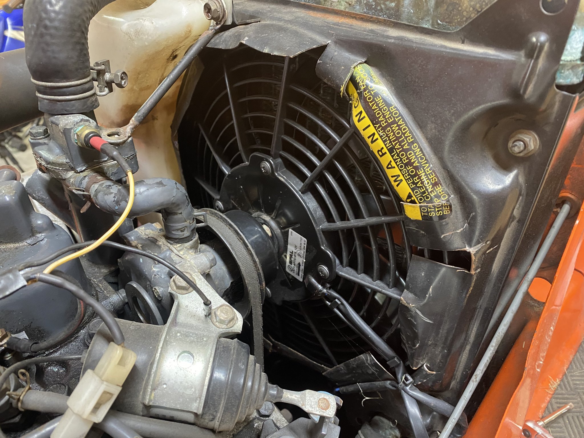

My .02 FWIW...a good bit of airflow is being lost by the way the edge of that fan is covered from the "fan shroud" work you did bending it over to hold the fan in place. Fix that fan shroud the way it was originally and find a better way to mount that fan.
BX23-S,57 A-C D-14,
13,129
5,800
Have to agree with the others that the shroud 'rework' needs to be totally redone. No part of the shroud should be in the air flow area. It's possible you've lost 30-50% of the capability of the fan
Hmm..fan only draw 9 amps, though spec says 15. Would need to see the graphs and charts to understand why but if 15 amps is true then fan's running at 60% which isn't good,only 480 CFM IF the graphs are linear ( unlikely...)
The first civil response I got. Thank you. I will see what happens.
