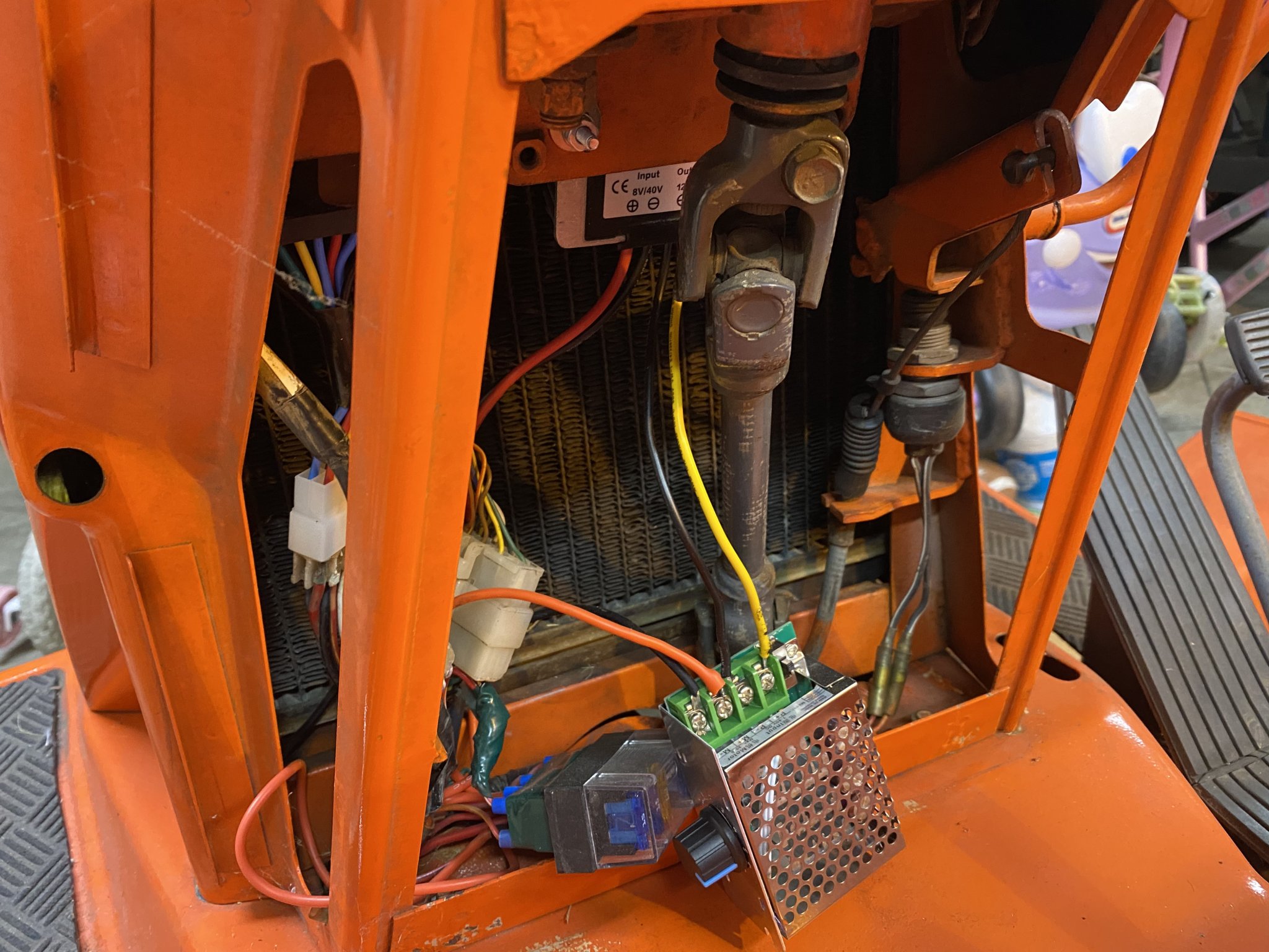

Unnecessary Amateur modification…and even that was screwed up with that hack-job on the shroud.
Sorry to be so harsh w/criticism…but OP…you’re working in the wrong direction I think.

No it's most definitely pulling air out the back, the way it originally did.
Honestly, I have never seen an engine mount that way. Seeing it now makes me wonder if there are restrictions between the radiator and the steering wheel. Could some sort of directional louver be missing?
When I added my electric fan, I left the engine side alone and added the fan on the front of the radiator pushing air through. Made quite a difference on the A/C side of things. But I was not having engine cooling issues.
You are the only person on here who has made me think. That is a really good point. As far as I know, there was no directional venting on the opposite side of the radiator. I don't think I can fit the electric fan on the back of the rad as the steering shaft is about an inch away from the rad.
Steer me in the right direction please.
Return it to original configuration…. make any other “HP” mods you wish to make…THEN see if you need addt’l cooling…. but I doubt you will need any.
I assume there are covers off so how/where does the radiator draw air from? I don't like all the electrical right in the path of the radiator. How is a person supposed to properly clean it?
Chaff can really be deceiving, and the newer style radiators are a PITA to clean. Get some coil cleaner and wash it well then carefully blow it out with an air hose. Then do it again, Then, run it hard to make sure the radiator is dry before putting it back in the dust.
Like others have said, I would put everything back to square one after a thorough cleaning and see if it makes a difference.
As far as water pumps, they can get weaker from worn vanes and can even go bad. But usually, you can hear or feel a bad water pump.
Get back to square one and start with the simple stuff.
