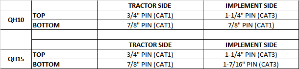

It's a bit of a mess really. I have both the QH10 and QH15 which have CAT1 inputs but different outputs! Here's a table I just made that might help some folks.
Both the MX and M have CAT2 top links and lift arms which means that the holes in the heim joints are 1" for the top link and 1-1/8" for the lift arms. So I have to use bushings for both tractors to reduce 1" to 3/4" for the top link, and 1-1/8" to 7/8" for the lift arms.
What's messed up is the lack of standardization in this industry. The RCR1884 for example has a 1-1/4" top pin which works with both top hooks on either the QH10 or QH15. It has CAT1/CAT2 lower pins that are the 7/8" and 1-1/8" combination type. So I can run the RCR1884 on the QH10 without bushings, but have to use 1-7/16" to 1-1/8" reducing bushings in order to run the cutter on the QH15. So the QH15 is a CAT1 to CAT3 quick hitch. Clear as mud right?!!! :rolleyes:

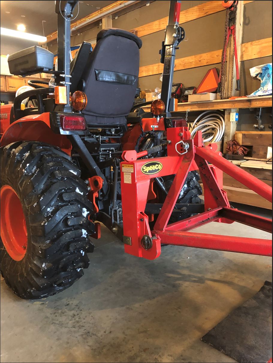

Here is a pic of mine (Speeco E Hitch) that's "economy hitch" with a rear blade off of an old 8N. Note the 7/8" pins of the rear blade fit pretty well in the quick hitch.
Funny, I had to modify my speeco to make it wider to fit all of my implements. I'm suspecting that some implement manufacturers are saving money by making their 3PH dimensions to the nominal spec.
