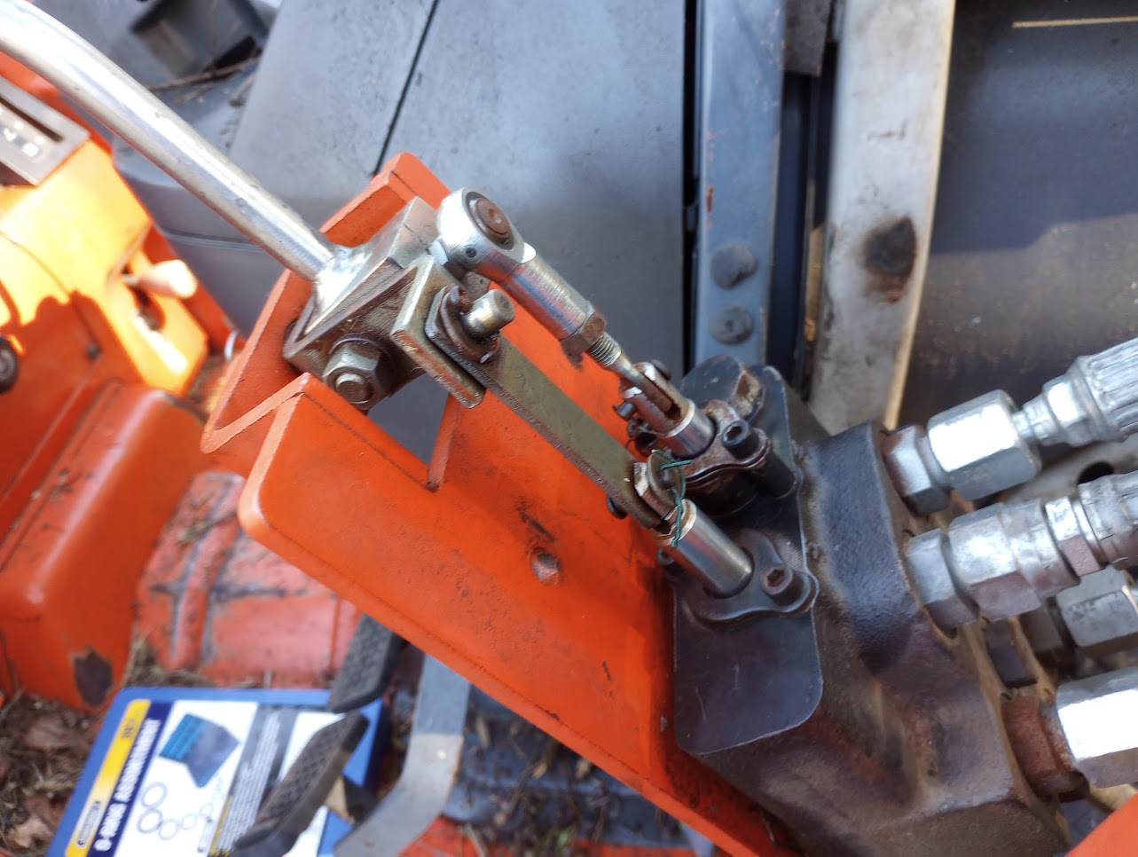

The detent kit goes on the back of the valve. It isn't going to fix a leak anywhere else. $500 labor to install seals is insane.
Post a picture showing the entire valve and how it's mounted. Plenty of valves that could potentially work and for a lot less than $1500.

You can install the valve yourself. Disconnect the 7 hoses and unbolt the old one along with the joystick. Put them aside. Bolt the new valve on - you might have to drill two new holes in the plate. Hook up the hoses - you are done.
