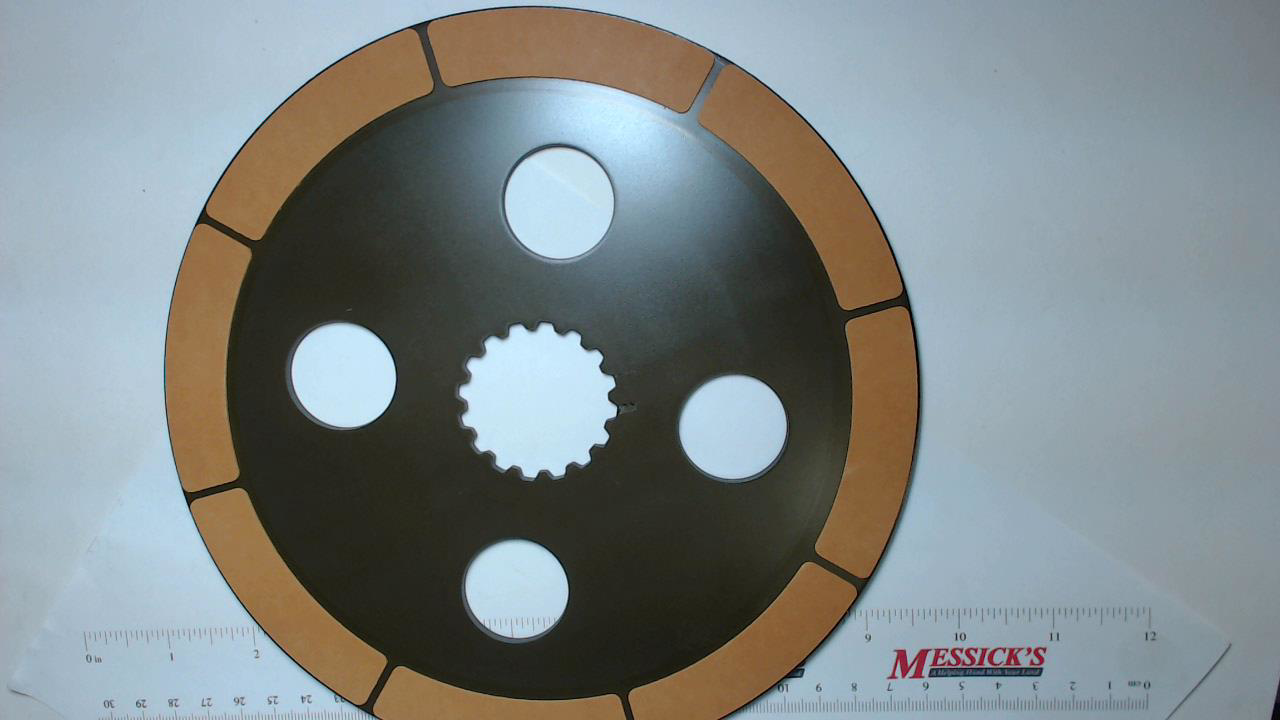

‘After 5 weeks the 2nd kubota dealership just called me and said that they are about to take the tractor apart to finally diagnose the problem but I had to agree to pay them $400 in the case that the issue is the brakes lining worn down. If the brakes lining is worn down then I would have to pay them $2,000 to fix it.
I can guarantee you that the loud popping / gear stripped out noise is not coming from the pad lining worn down, that would make a squealing / metal on metal rubbing noise not a stripped out gear noise.
attached is a picture of the brake lining. The splined center that is splined into the axle is most likely the issue.
I agreed to pay the $400 to diagnose my one year old tractor with 150 hours on it that is under warranty.
I am sure Kubota designed the brakes pad linings to last longer than 150 hours. If it was a gear drive tractor then they wouldn’t even last 3 months.
I am pretty sure after they take it apart a visual inspection will quickly determine the exact issue.
Place your bets now on what the problem is.

So the kubota dealership took the tractor apart and and they are replacing all 4 of the brake discs and plates under warranty, I went down and looked at them and they appear to be in perfect condition, the tech agreed with me. They think I am concerned with the brakes squeaking, when I am concerned about the loud popping Noise. They had both of the axle casin’s off and from what I could see the gears appear okay.
The tech said that he could not duplicate the popping noise. I asked him if he backed it down the hill and hit the brake pedal and he said no. I told him if he wants to duplicate the popping sound back down the hill and push the brake pedal.
I don’t think we are getting to the root cause of the problem. But if the brakes don’t fix the loud popping noise then at least they won’t be able to blame it on the brakes anymore.

I'll put $50 on a brake related problem. Friction discs sticking to the steel discs, misassembled (two friction or two steel next to one another), bad friction material on the discs or out of spec parts.
The fact that it doesn't make the noise when starting from a stop uphill makes it unlikely it's the gears.

You must of missed my last few post. I agreed to pay them $400 to diagnose it, they would not do anything until I agreed to pay the $400.
after that they disassembled the tractor and said there was a factory defect and since it was under warranty kubota was going to pay to replace all 4 brake discs and plates under warranty and I didn’t have to pay the $400 to diagnose it because it was a factory defect and the tractor was under full warranty.
All I have to pay for is new hydraulic fluid and filters.
There was a lot of what the kubota dealer said was “milky“ in the hydraulic fluid but it wasn’t water. It was shiny stuff in the hydraulic fluid but no chunks of metal.
I honestly don’t believe that new brakes are going to take care of the loud popping noise but I guess this is the first step in the repair process. If after replacing the brakes the loud popping noises don’t go away then kubota can’t continue to blame it on the brakes.
The kubota tech said if I don’t use the brakes then it won’t make the popping noises but I would prefer to use the brakes since it was designed, engineered and manufactured with brakes.
