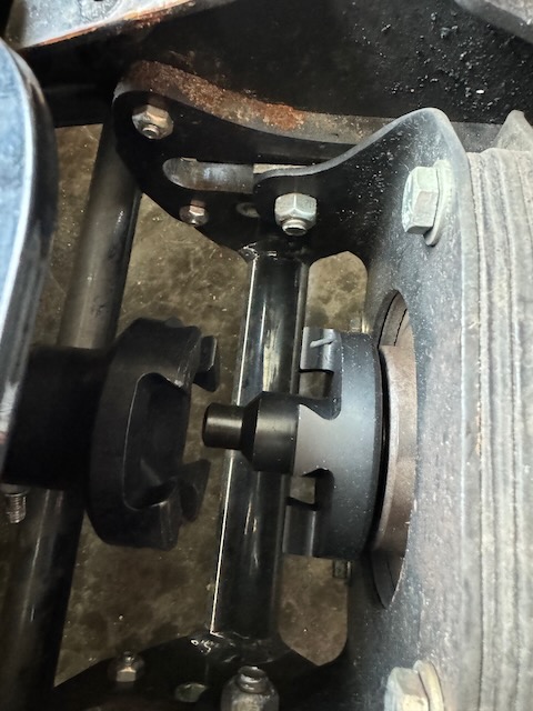

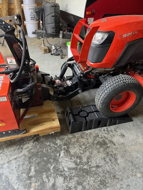

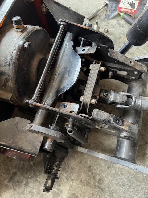

As promised, here's a couple pix I took while installing my k-connect blower yesterday. It's impossible to know the exact # of hours on it the last few winters, but it's likely to be 35-40(?) and as stated before in various threads, I certainly don't baby it. I bought the big $$ one, to have that beefiness and hopefully reliability.
View attachment 115443 View attachment 115444
I dream of mine looking like this after use lol

Other than that weird scratch on one of the "dogs" (whatever you call them) mine has nearly no wear (that I can tell....maybe I don't know what to look for). (I think I backed into it in the summer and hit it with the 3pt or weight box and put a mark on it).
I can only imagine that perhaps yours was either out of round (like J said) or made out of Chinesiumalloy.
(just thinking out loud here) Is there any chance at all, once you engage the springs (watch out for the fingers), that yours are not mating fully. ie: something in a shaft length is 1/4" too short or something?
Normally I am full of good ideas. (and some not-so-good-ideas) but I am baffled by this and kinda have a guilty feeling if I am being honest. Almost seems like 1/2 of us think they are POS and the other 1/2 think they're great.

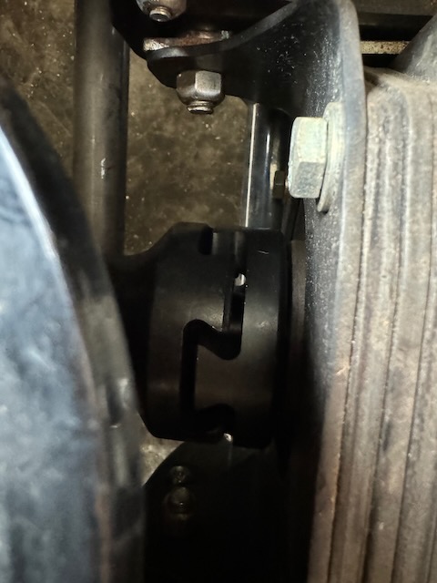

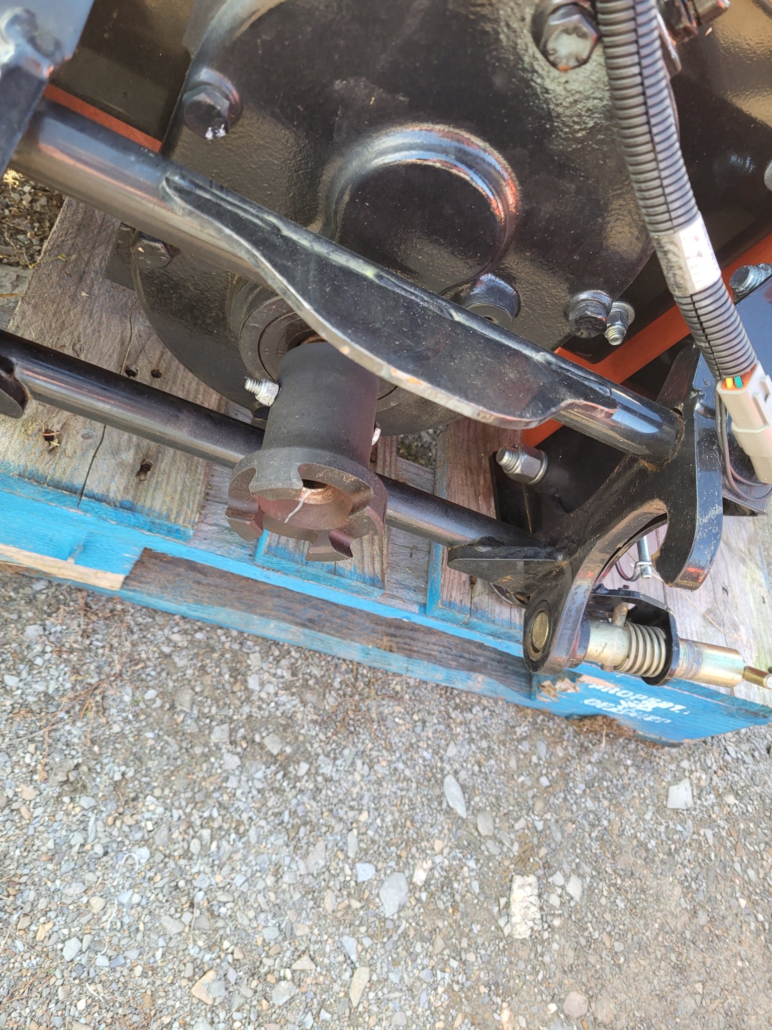

Well, mounted the blower up this morning.......pulled the safety cover from the coupler to get a few pictures of the virgin replacement coupler prior to use......
It's together per instructions just like every year so far......
IMG_5649.jpeg IMG_5660.jpeg IMG_5663.jpeg IMG_5664.jpeg IMG_5665.jpeg IMG_5666.jpeg

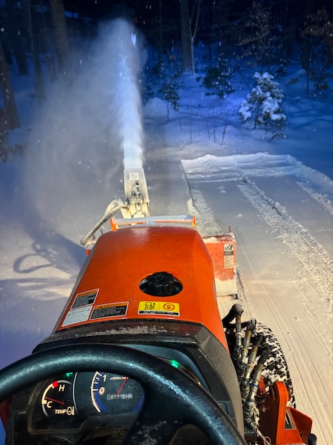

First Storm Update:
We finally got enough snow to need to actually do something with it. 12-14" of powder yesterday here in NH. While the tractor was warming up I pulled the cover and verified the couple was matched up nicely and didn't get bumped around some how (eliminating all possibilities).
I treated it with kid gloves per usual and for the first 15mins I couldn't help but feel like it was just going to snap more shear bolts under load but it worked flawlessly in about 60-90mins of total use.
We got another 1" overnight so I went out this morning and did a little cleanup with the back blade primarily but hit a couple areas with the blower.......always careful to engage and disengage at idle per usual etc.
When I was done I cleaned things off as best I could and removed the guard again to check for wear. From what I saw the couplers looked new still, no signs of wear. But I will hit it with the camera later to document. IMG_5802.jpeg IMG_5807.jpeg IMG_5808.jpeg

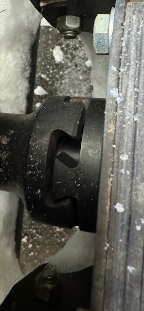

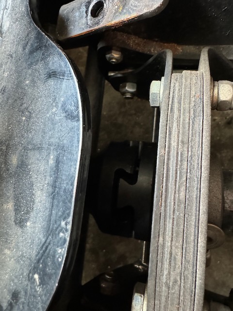

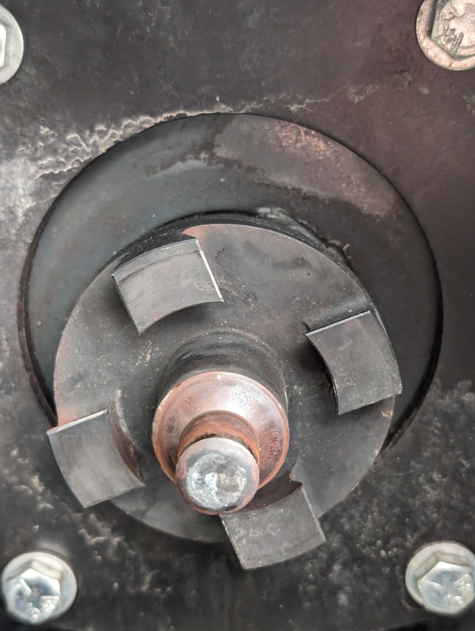

Just to keep documenting things as we go along here in Winter 2023/2024.......
Here is a pic of the new couplers as of this morning with about 2-3 total hours of blower run time so far since replacement.
BX23-S,57 A-C D-14,
13,888
6,328
I'd have expected that the 2 couplings would 'overlap' or 'mate' better. More material on the 'fingers' to transmit the energy.Kubota only has 4 fingers,partially overlapping compared to a Lovejoy having 6 fingers, 100% overlapping.
Time will tell......

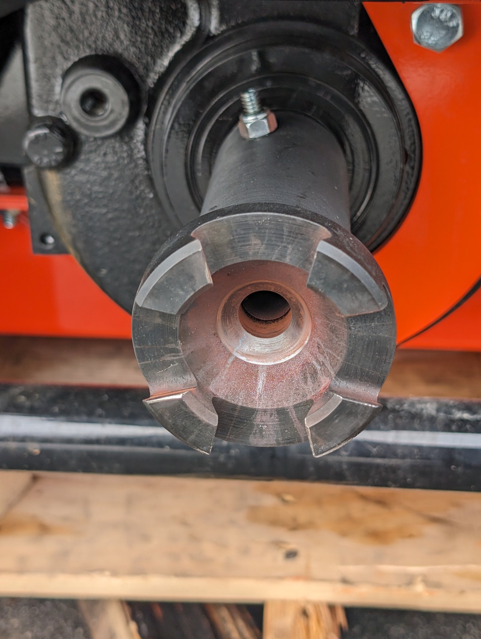

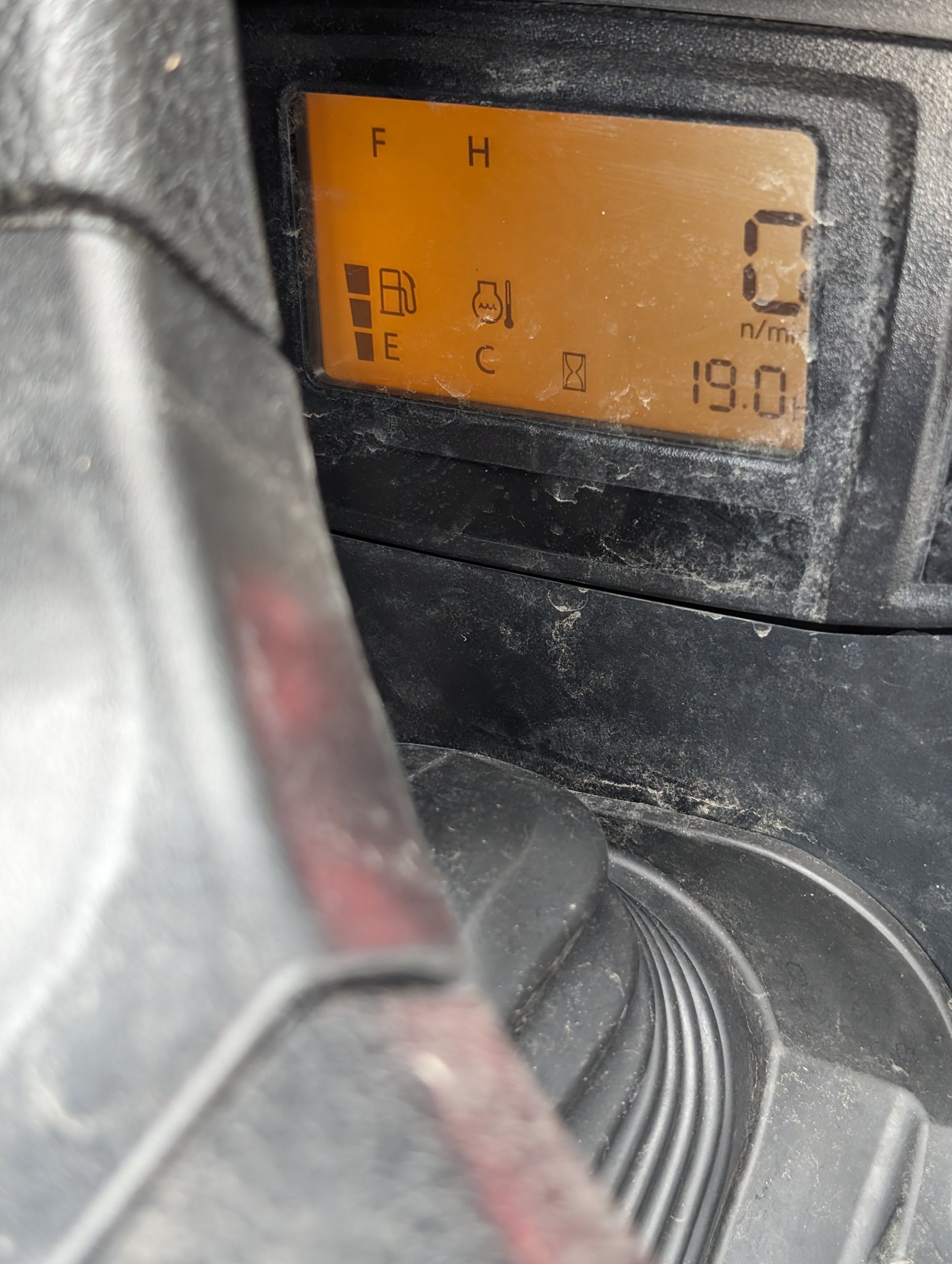

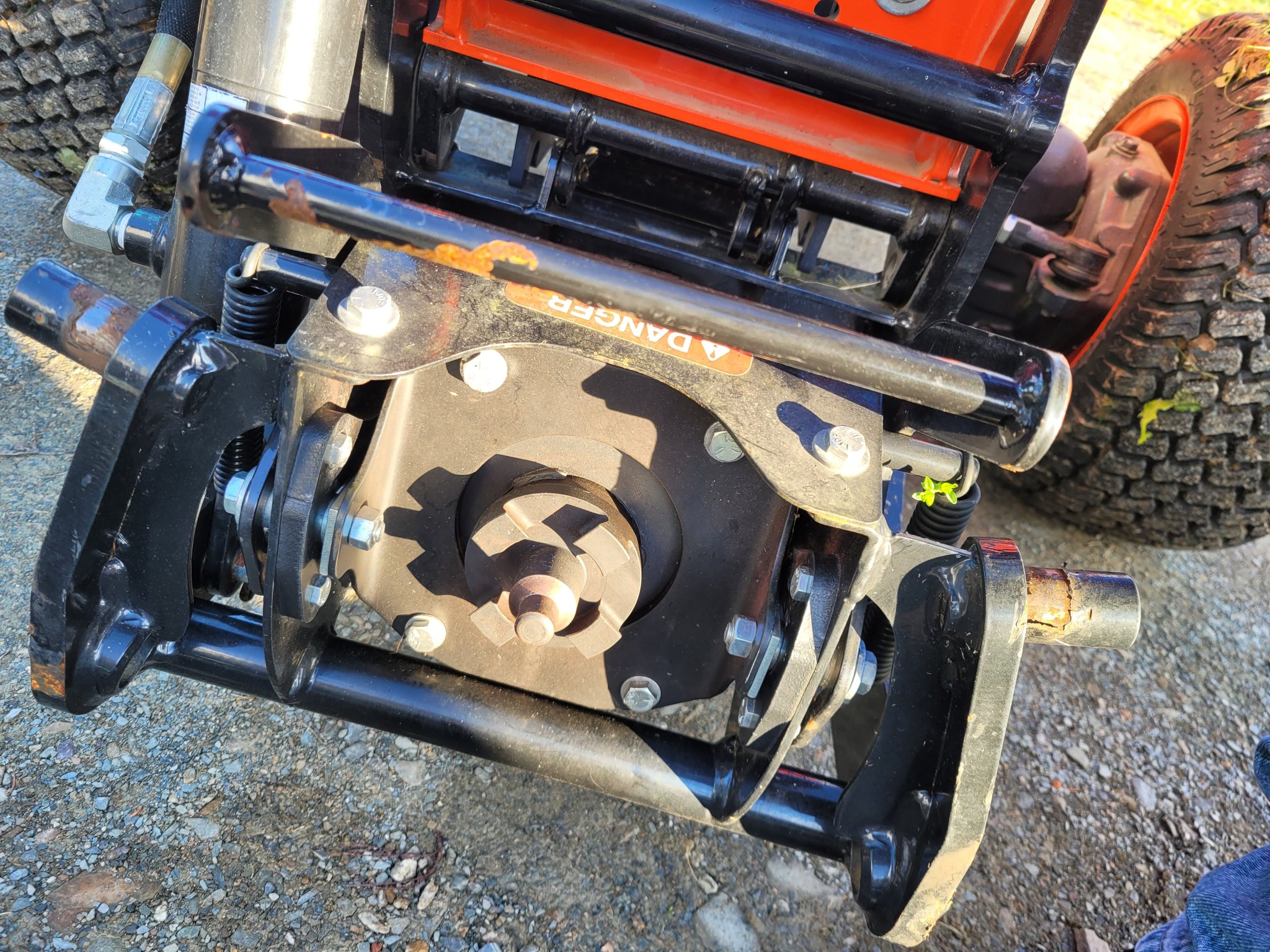

I just disconnected my snow blower (most likely for the season) I have not noticed any wear on the K - Connect Coupling. Tractor has 19hrs on it, 18 of those hours were moving snow with the snow blower or box blade. I frequently engaged/disengaged the pto for the blower. Although, I engaged the pto primarily at idle, I never idled down to disengage. Also, I frequently had the blower lifted as high as it would go to clear objects and uneven terrain. I would estimate the snow blower was operating at least half the 18hrs, so around 9hrs of blower operation.
Just posted for informational purposes as I anticipate issues eventually.
. PXL_20240313_005240500.jpg PXL_20240313_005248899.jpg PXL_20240313_005324656.jpg
