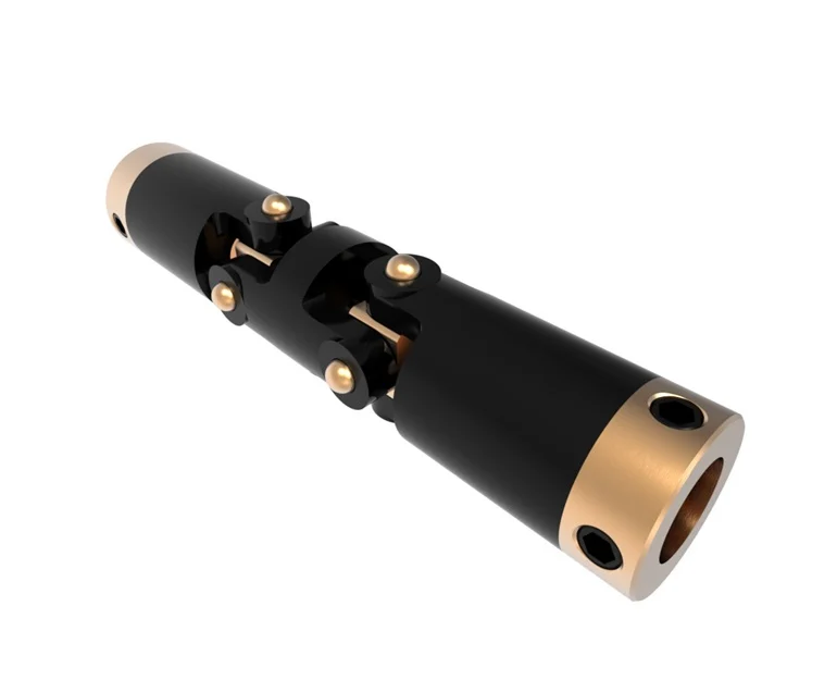

yes...
when you attach the snowblower or broom, you use the lever to mechanically connect the two dog clutch halves.
when you turn On the mid mount PTO, THAT spins all the shafts, ujoints clutch and of course sends power to the snowblower or broom
So when you engage the blower, what cushions those "ears"?
It cant be nothing? Can it?
Is it really 2 pieces of steel that slam together because of that "giant gap" between them?
