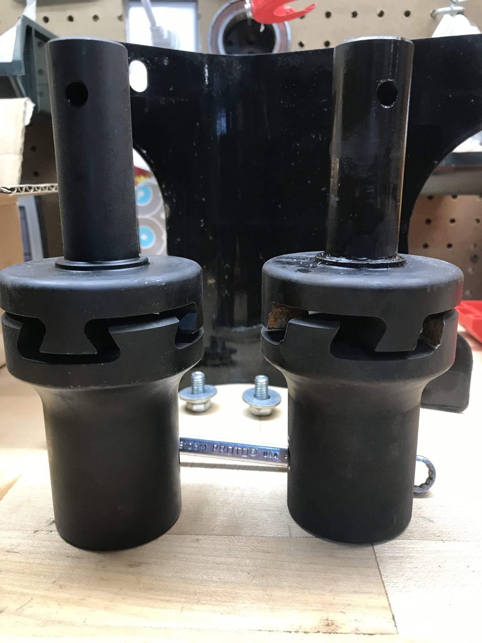

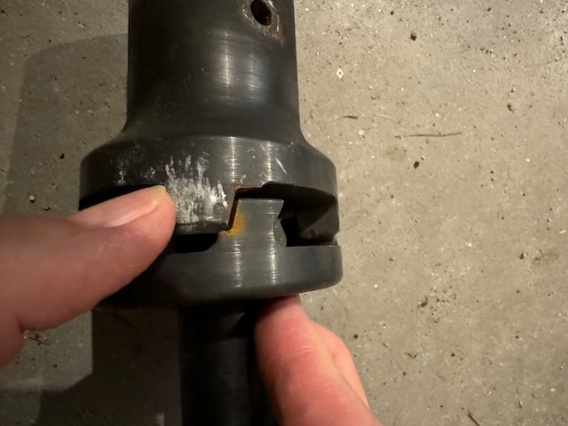

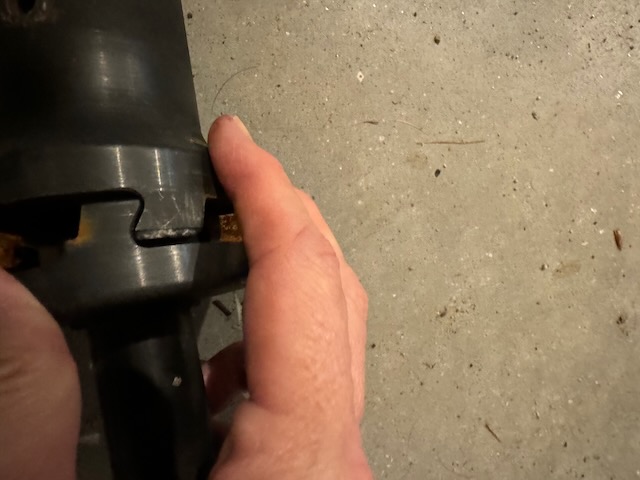

For your viewing pleasure.......this is the faulty coupler they pulled off my unit during the $700 "fix".....mind you this is after 35 HOURS of use MAX......on my own driveway doing what it is designed to do.
I ALWAYS engage the PTO at idle.......I ALWAYS disengage the PTO at idle......just like the manual says. And THIS is what my coupler looked like.
Now here is the oddity of mine in particular......notice the perfect worn notch in the "opposite" direction in which the coupler spins? I have no explanation......

Yours is one of the most badly damaged ones that I have seen. I suggest that you send the pictures along with an explanation to the manufacturer and see what they have to say. Here is their email address..... radtech@radtech.ca and their website. https://radtech.ca/en/
Dusty......I just sent them an email with a link to this thread along with my story and pictures......

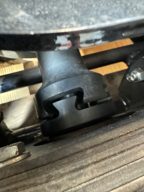

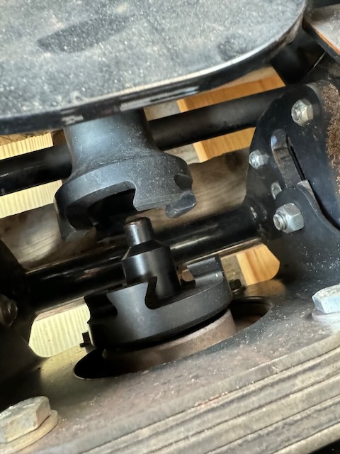

Here is what the brand new replacement coupler looks like prior to any actual use.......
I am going to try and remember to document the wear/failure of this part over the season.
Top picture is with the spring loaded handle disengaged and the bottom picture is with eh handle fully engaged in the locked ready to run position.

Request to River19
could you please post similar picture with 1) engaged- blower on ground and 2) engaged- blower raised up high ?
it'd be nice as 'references'.
I still say that dog clutch is a very,very poor design. Only maybe 1/2 the dog 'faces' are in contact,unlike say a 'Lovejoy' coupling where 100% of the faces mate.

I will try and remember to document that when I mount the blower, right now it is on a pallet with the K-connect attached as it was returned from the dealer........
But yes, I will do my best to document it.
