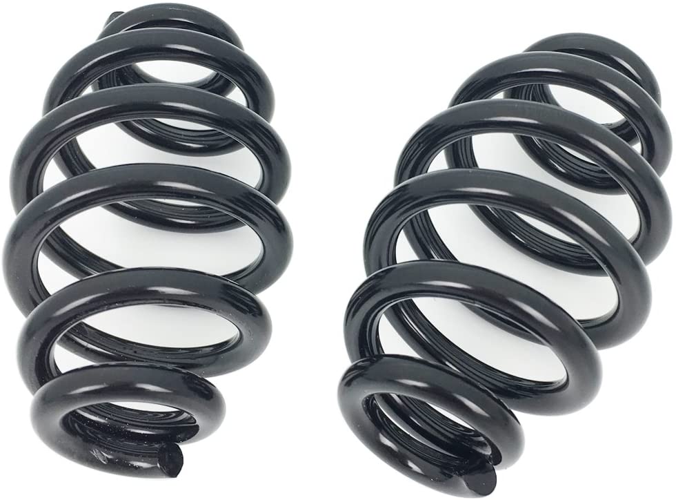

I added a 3" motorcycle seat spring(from Amazon) on the front passenger side where the rubber travel bumper is. I removed the rubber stop and used a 1/4” bolt, lock nut and fender washer to bolt it on. I cut 3/4" off of one end and put a piece of fuel line on that end to keep it from squeaking. It does not fix the height issue but has stopped the hard bottoming out that I had experienced before.

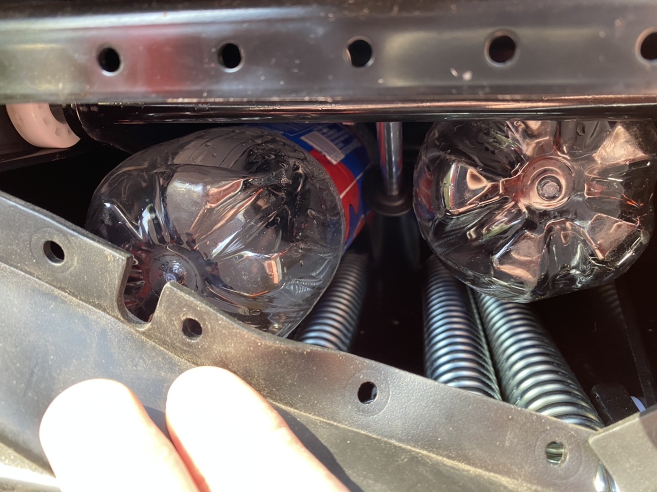

Here’s what I came up with on the fly.....

If those soda bottles don' t do the job you could try a partially inflated soccer or volley ball! Great idea, and cost effective. ;)
