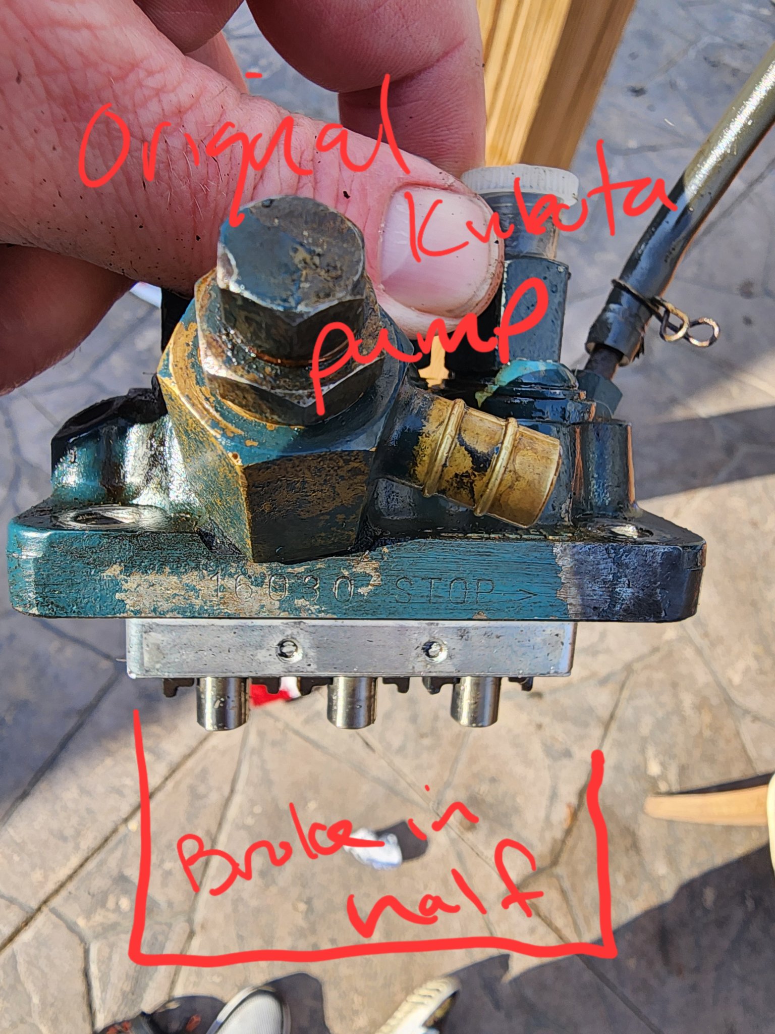

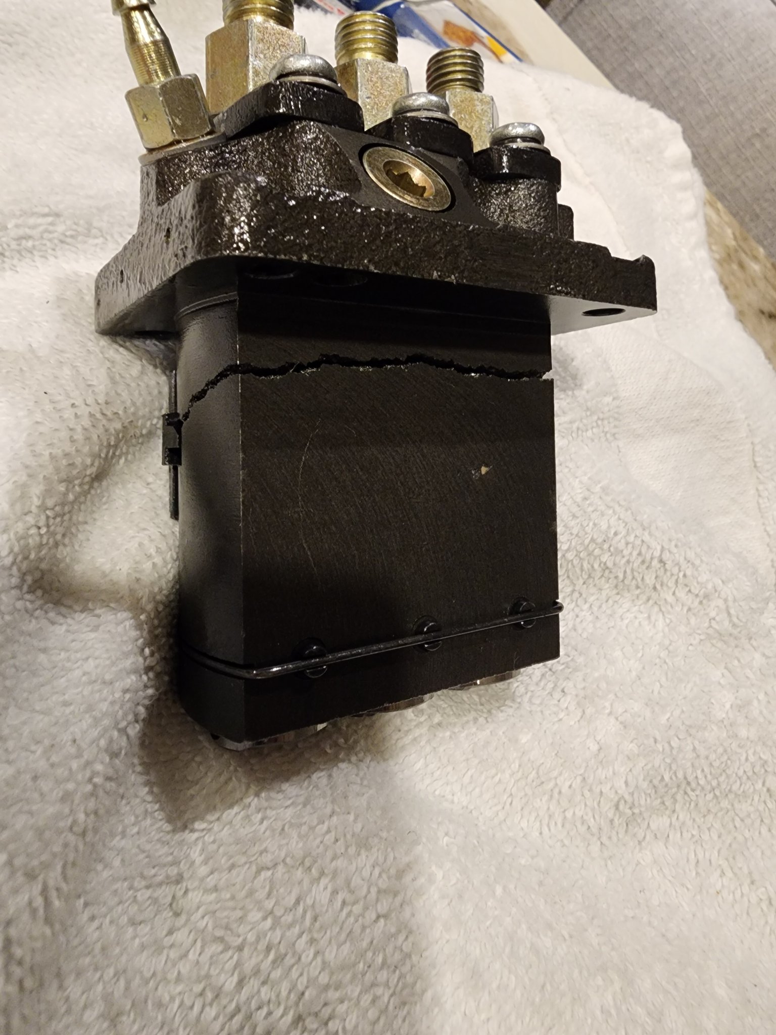

I'm at a loss here. I've completely rebuilt Kubota D1105 engine and have since cracked the injection pump twice...yes that's right 2 injection pumps completely destroyed! Anyone know what could be causing this???

pump # (1603251010) based off my model # on the top valve cover (from old block). Maybe this block is a newer block, not sure if they ever even changed the design or whatever? The original pump is a real kubota part the other is a remanded replacement with same part # in description. Both cracked and it was NOT from h20 in fuel ect.

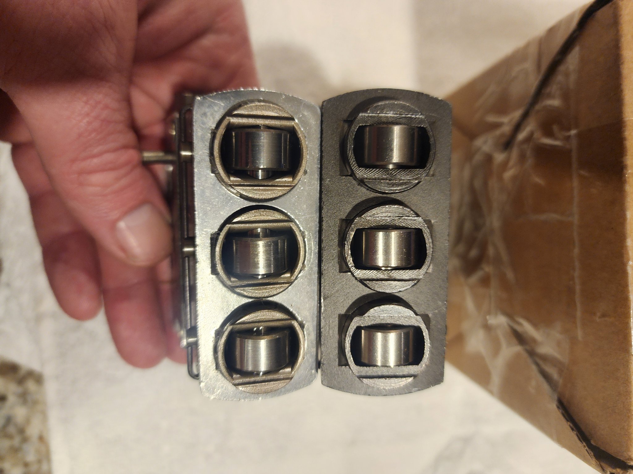

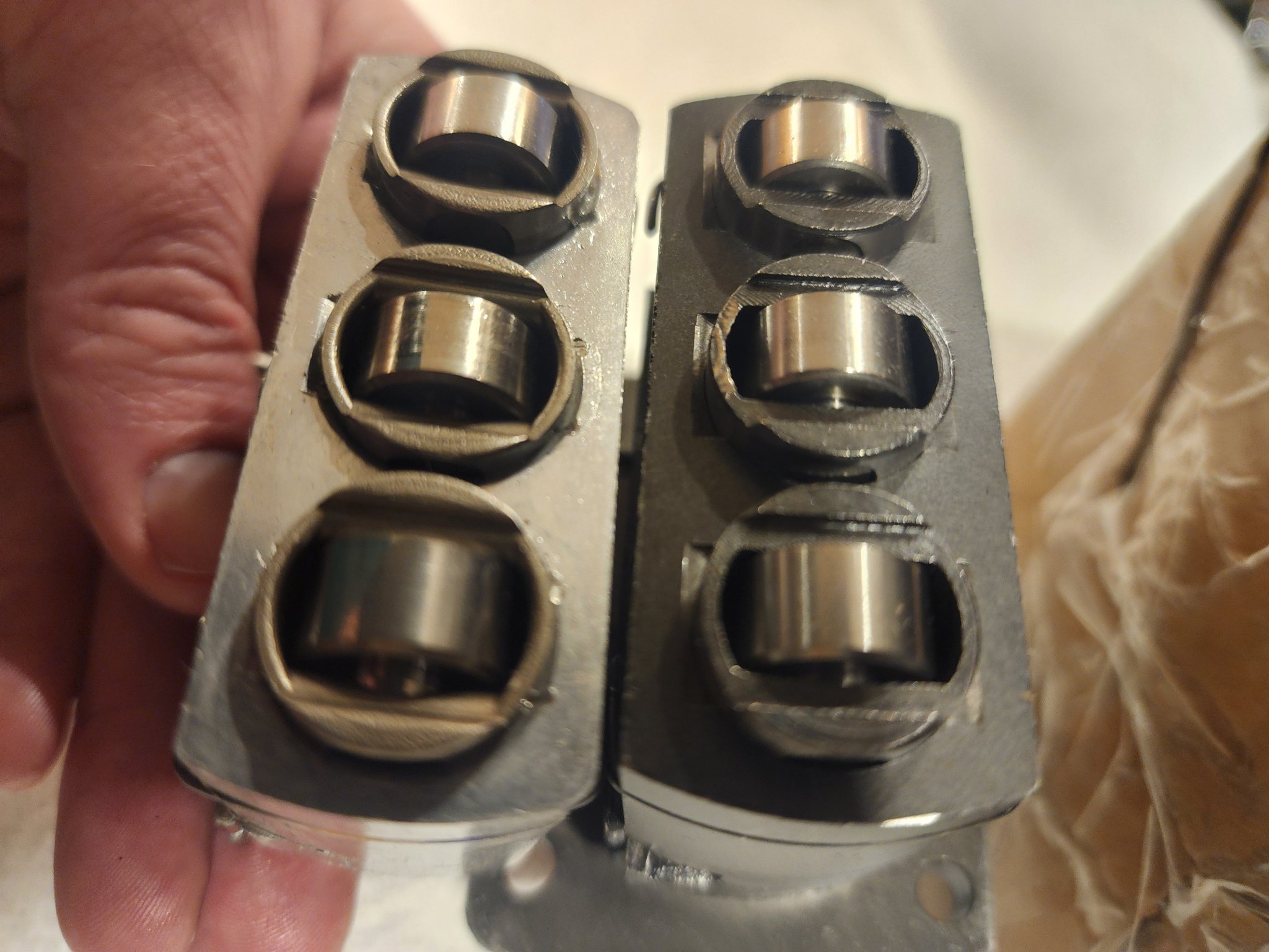

Give me a picture of the (bottom) roller side of the pump.
Both of them if you still have them.
