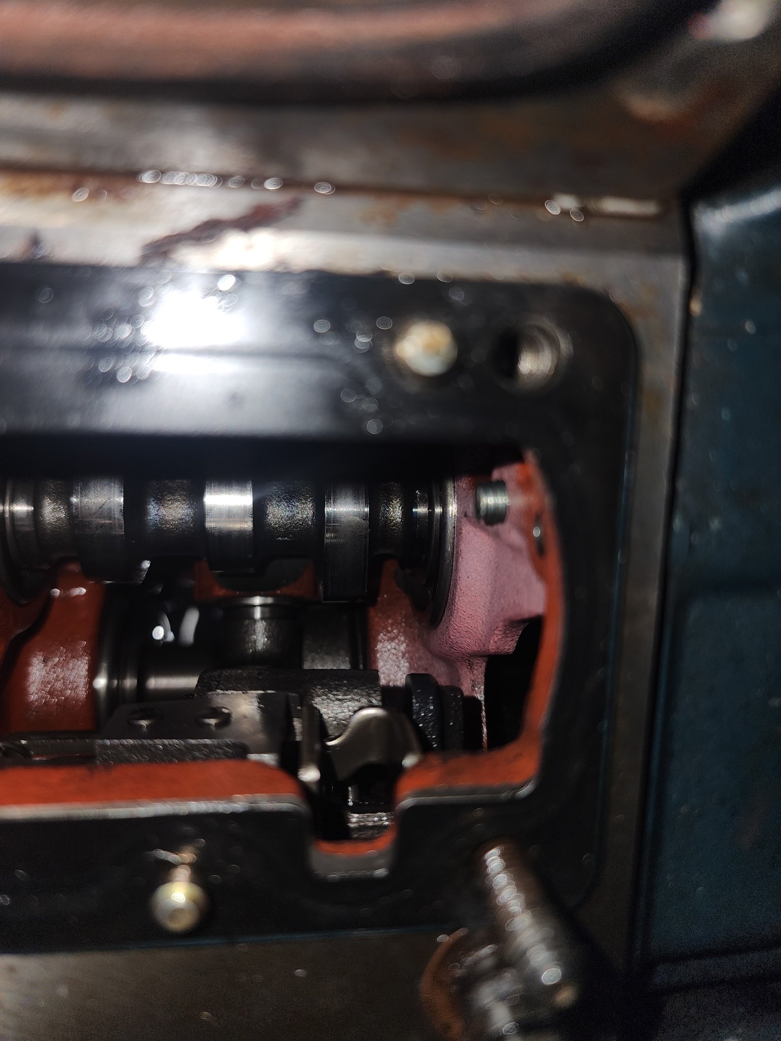

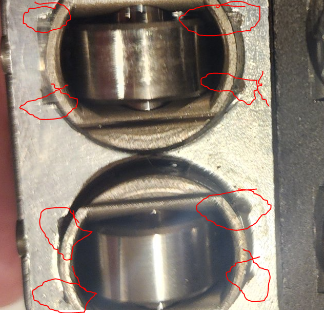

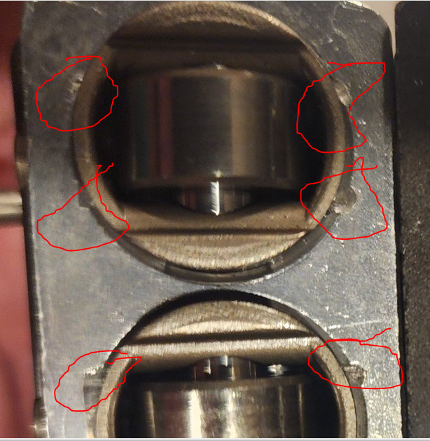

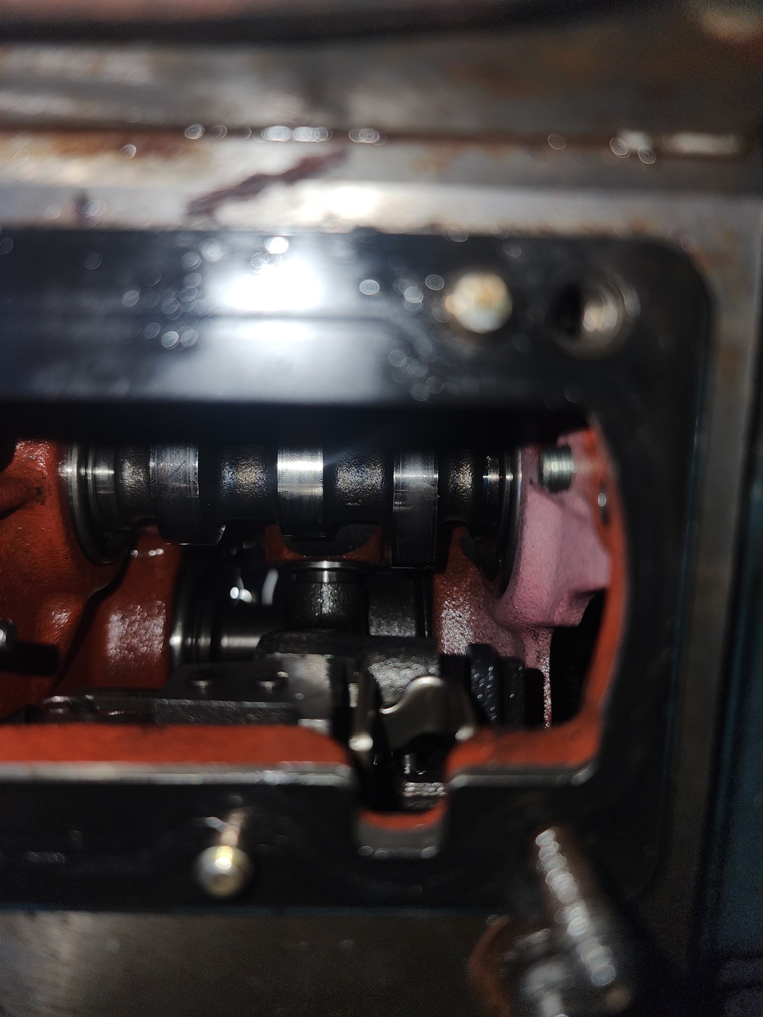

ok one more set of pictures
Fuel cam.

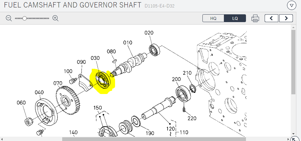

Here is what I'm thinking, that this bearing is not in the right position and the fuel cam is hitting the body of the pump and not the roller.
This wear mark makes me think something is off.
I also really don't like these marks

You are a genius! I now remember I over tightened a bolt on the bearing retainer plate (part #90) and broke off one of the hex bolts...there are two of them and one I sheared off but forgot about it in my haste to get it back togeather. Man I tell ya little things like this really come back to bit ya in the ass! I'll report and take a few pics when I get the engine pulled back out of the machine tomorrow. I'm sure this has to be the problem as it makes the only logical sense!

well I took a look at the cam from the top and there is very slight movement of the cam from side to side but I don't believe enough to justify that as being the issue. hummm?
I do see that bolt to the right sticking out a bit but I don't think that is causing the issue either
