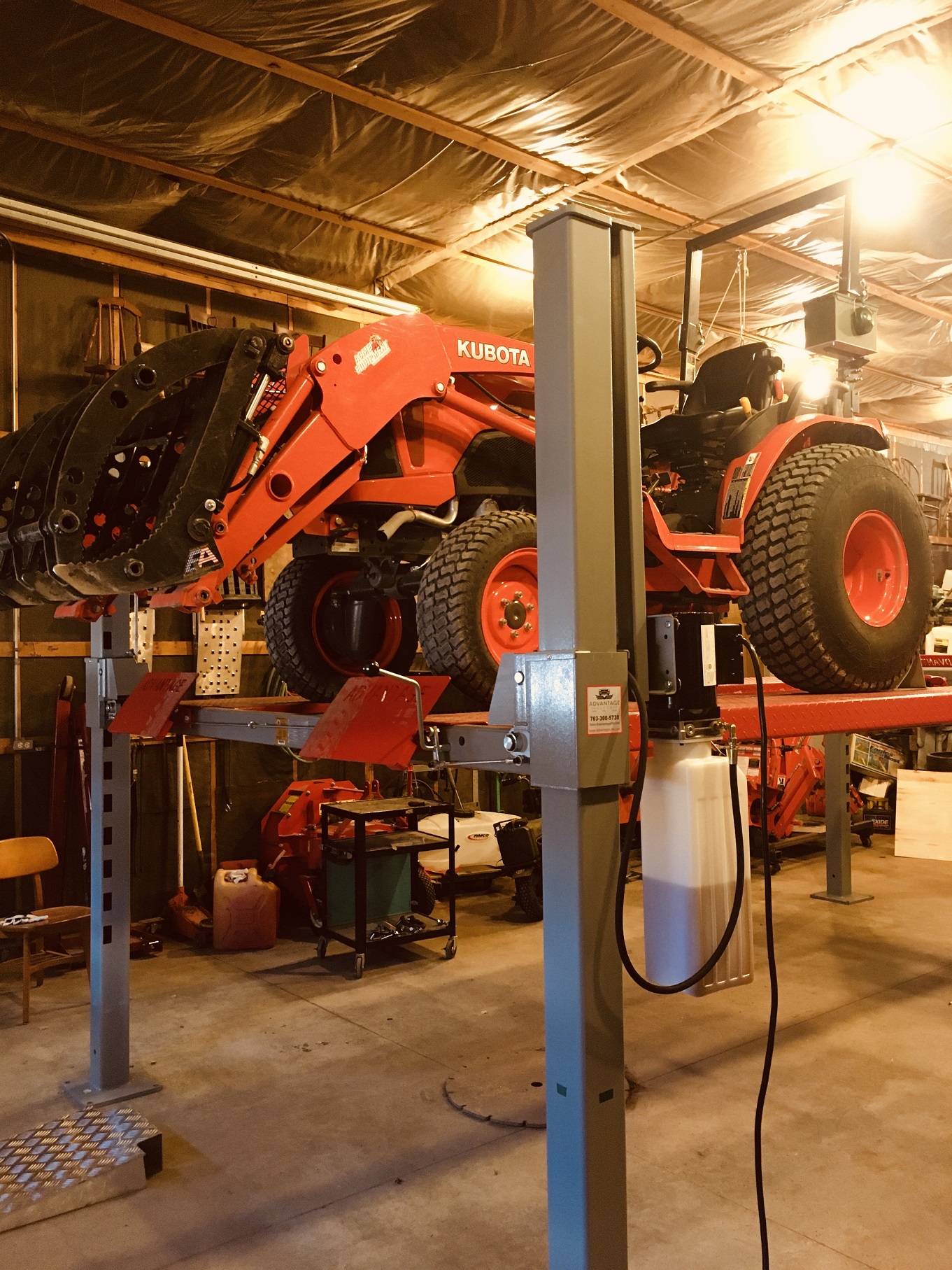

I have been blessed with a wonderful shop and about every tool anyone should need for normal mechanical work. My shop is warm, dry, and roomy enough for my John Deere 728X (4x4 with cab and heater) and my Kubota BX2380 (with cab and heater). But I do not have a means to lift the tractors much higher than jack stands or wheel ramps and I hate crawling under my tractor..... but I guess I have no choice. And yes I do have LED trouble lights. Now if I can just find my 20 year old body ......
