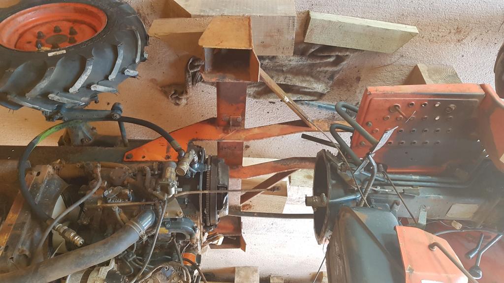

An Update.
I now have the tractor split. It actually didn't take long once I stopped looking at it.There were a few tricky bits.
The tie rod was a bit stuck and was separated using a length of 2x4 timber as a lever and a smack with a hammer on joint did the trick.
I couple of bolts on the top section of bell housing forward of tank were hard to get to. I think I will have to remove tank when putting back unless there are any tips to get these bolts.
Anyway I removed clutch parts. The clutch disk was rusted on to fly wheel and needed to be pried off. Some pictures are attached. Completely worn out and needs replacing.
So I am cleaning up and have some questions before I order parts.
1. How to you remove the release bearing from holder ????
2. I cleaned the pressure plate. The disk has some light grooves from worn clutch disk. Otherwise is sound and smooth see picture. Can this part be re used?
3. Same question for fly wheel?
4. The clutch fork has some wear on one side. Can this part be reversed or should I replace?
jenkinsr
Have the Flywheel resurfaced at local auto machine shop, get new clutch disc, pressure plate can be used over but better off replacing it you only want to do this one time. Cant tell if shifting fork can be flipped over from picture. I have ground shifting forks or built them up with silver solder then ground them to put a new radius on it. Depends on how hard it is to find new one!
200mph
Mar 3, 2017
1,228
65
PA
It's common practice to change disc, throwout bearing, pressure plate and pilot bushing (inside the crank) when doing the clutch. Additionally the flywheel should be ground per noted in the previous post.
Make certain you have a way to align the clutch during assembly.
Good luck
