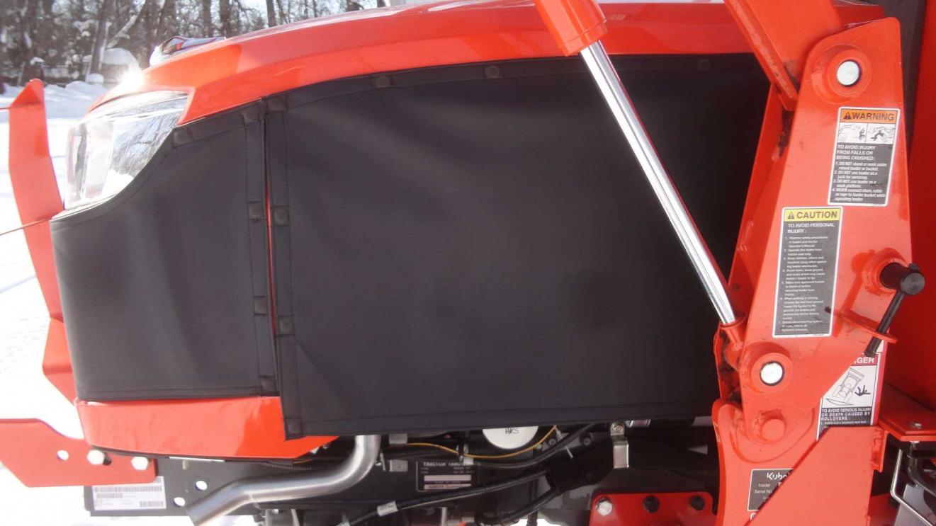

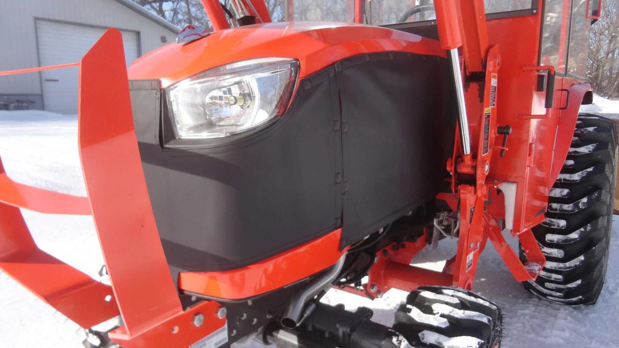

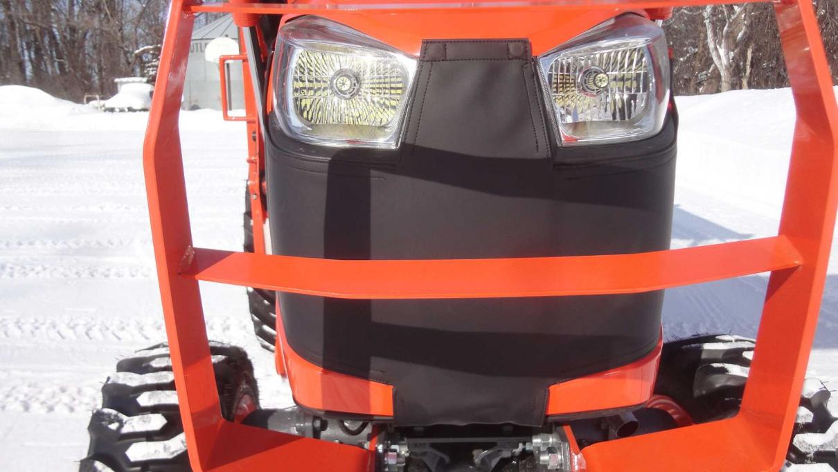

Off to the surplus store and found waiting on a roll was a nice soft black almost satiny looking piece of Naugahyde. After figuring out the economies of scale prior to the purchases I bought the black fabric and ordered the other materials needed. This would either allow for some unforeseen mistakes or have some extra pieces/sets for someone in need. The goods quickly arrived and I put together the first set for a trial run. Here’s what I came up with. A 3piece weather front kit sewn to nicely follow the lines and form of the tractor’s hood and grille. Neodymium magnets were sewn inside the hems so the pieces attach and remove without any tools and in less than a minute each. Since the magnets are inside the hems there’s nothing to scratch the paint and they’re extra easy to adjust and shift into place. A gentle tug will lift them free for proper placement or removal. After using the first set for a couple of weeks the pieces have stayed right in place and don’t wander around a bit. Success. Here’s the pics:

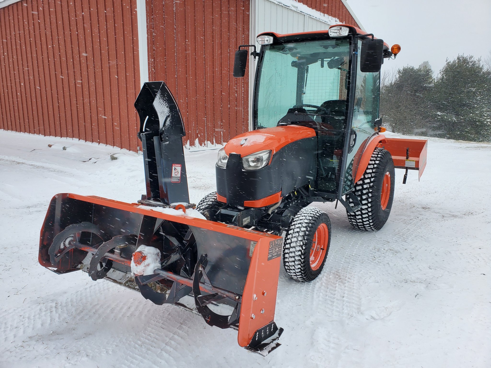

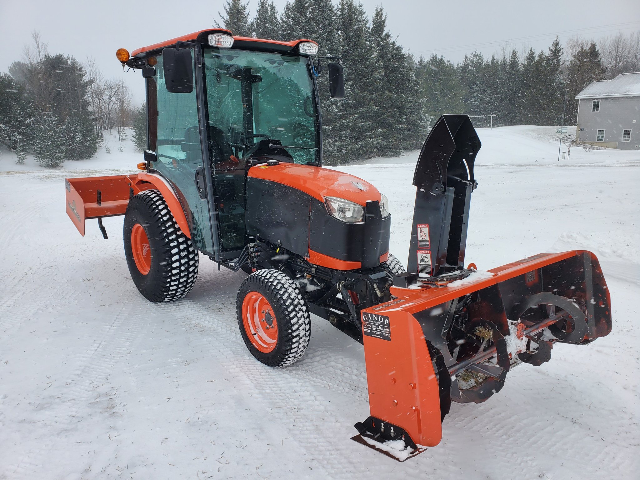

Got to use my covers from bird dogger on my B2650 today and they work great. I'm in the Traverse City, MI area where we are currently getting hit with a blizzard. Pictures are after a couple of hours snowblowing in -5 degrees F and 25 mph steady wind. Front grille and top of hood free from major build up, and temp gauge on three bars for nice comfy tractor operation. With the strong high winds, I also took the advice of using an additional couple extra spring clamps on the bottom of the side covers. No problems and a quality product. Count me as another very happy customer.

Michford, I’ve got the same rig as you, including the covers from bird dogger. They are a great addition to keeping the tractor warm. Thank you bird dogger. 😉 I’m curious as to what you have sprayed on the inside surface on the snowblower? Some type of anti stick surface, or just black spray paint, or something else?

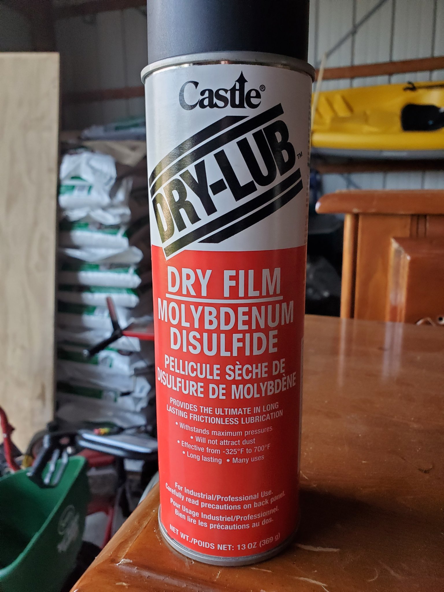

Working area of snowblower is sprayed with molybdenum disulfide. This was my second use after applying and it worked very well with the extremely cold temp and fluffy snow. My first use was in temps near 32 F and didn't seem to help much with wetter snow. Hope it's effective with temps in the 20's and colder, but yet to be tested. 20220810_194814.jpg

Oh Great!!!! Now when the snow melts and refreezes it will be even slipperier. :ROFLMAO:

Michford, That's sure a great looking setup you've got there!! Glad you're liking the new covers and thanks for the compliments!! I might have to try your idea on coating the working surfaces of the blower. I have a 3 pt blower and park my tractor in a semi heated shop between uses. (Kept around 45°F usually). At the end of a snow removal session it's a hassle trying to get all the snow off the blower insides before pulling into the shed again. I do keep a heavy duty insulated pair of rubber gloves for that purpose, which helps.
